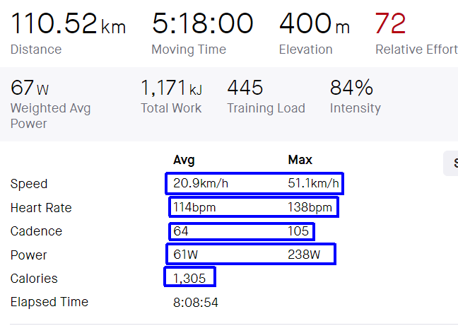

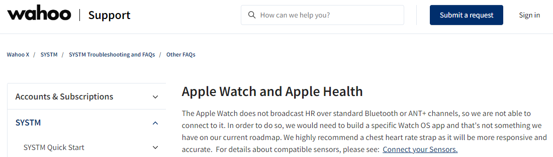

Derrek,
I do understand your frustration. You have set your expectations very high; Specialized e-bikes can give you a wealth of information about your rides as long as you accept the fact they are ANT+ centric (and do not expect such connectivity from systems of many other brands).
  • For one, your Apple Watch is not ANT+ compatible. This is not Specialized fault: it is Apple's choice. I use a Polar OH-1 wrist heart rate monitor and it connects to my ANT+ devices.
  • Mission Control can only transfer the ride data to Strava. Bosch Nyon can only transfer data to Komoot.
  • More data about your ride, such as electrical motor power can be extracted from Specialized Ride app. Start the Ride App, go to Activities and you will see more ride data based on the existing MC output. You can export a .FIT file (that you can upload to RWGPS). You can probably Share the ride to RWGPS by Sharing the FIT file (I have not tried that though).
Since a Specialized e-bike is ANT+ centric, it would be smart to equip it with an universal data centre/bridge, as the Specialized system is missing several features. As you hate the idea, it is what my Wahoo ELEMNT does for me for both Vado 5.0 and Vado SL (the latter has no display!)
Once, I wrote a large post describing what an ANT+ compatible GPS bike computer can do for you. Apart of many other things, it will connect to both Vado and a compatible HR monitor, and will upload all details of your ride to both Strava and RWGPS (and to Komoot, too!) One of other benefits is both Wahoo ELEMNT and Garmin Edge allow calibrating the e-bike wheel circumference for very precise speed and distance recording based on your e-bike's rear wheel RPM and time.
Unfortunately, it is Apple that does not want a better connectivity. And Apple is far bigger than Specialized, Wahoo or Garmin are.
The data in blue (as well as the data in the top) are a combination of Vado and Polar OH-1 data as recorded on the ride.
This is simply not true in this case. There are like 3 bikes in the world with ant+ (obviously an exaggeration, but also obviously not very prevalent in the industry. giant and specialized? yes?). It is not widely adopted. You know what every "connected" bike has? Bluetooth. All of them. Every. Single. One. (maybe also an exaggeration but not by much)
Why would apple put hardware into their devices that only supports a very small subset of cyclists in a subset of fitness activities that apple supports? The only reason is a very specific partnership between Apple and Specialized (or one or more of the other brands that do use ant+). Or apple actually deciding to build BikePlay and take over the cycling computer market (not worth the effort from an industry size standpoint in apple's eyes I would think). And, the argument can/should be made that apple would be better off "strong arming" manufacturers to use bluetooth so any bike features they build will work on any recent iphone or apple watch. Ant+ is not a technology that is prevalent enough to draw customers to a product simply to increase sales outside of the primary industry.
And, remember, it's not just Apple. Android can support all of this as well. It's bike manufacturers not opening up their data and using the connectivity that is already present. Keep in mind, phones that used to support ant+ *no longer do* in their current models. Example samsung galaxy s20 had it (and many earlier models). s21/s22 do not. Ant+ appears to be going the way of the headphone jack.
That leaves the question: What do I have to do to get all the data output that I can already gather? The answer appears to be: replace apple watch heart rate with something else. replace the phone with something else. Accept a substandard navigation/routing/control experience. Neither npe cable, or viiiiva hrm are readily available as far as I can see (at least not from reputable sellers). So, now I am limited to an ant+ bike computer (or watch!).

And Apple Watch only works with Apple Health.
It only works with iPhones which is a bit different. All the apps on my iPhone can gather the heart rate data recorded from the watch if they so choose (most of these apps do that RWGPS certainly does when it is the primary recording app). *AND* any heart rate sensor can push data to Apple Health through their apps (directly with iphone would have to be a bluetooth heart rate sensor. think fitbit). Technically, the apps are given permission to pull/push the data to/from apple health. This is how data sharing works. And it is a shining example of how all the data from specialized or any other bike manufacturer should work. Apple didn't say "you can't have the data". They said "ask permission of the user, and if granted, here it is".
Apple's "walled garden" is more accessible than the ant+ limiting devices. That's a pretty broken situation. All because ant+ bluetooth bridge devices are few and far between. Again, a $50 npe cable should technically solve all of this in theory. And, I can't imagine that capability is not within specialized ability to produce directly on their bikes. Are they worried about pissing off wahoo/garmin? Cause it might summarily eliminate the need for any of those devices vs a phone of the user's choice.
