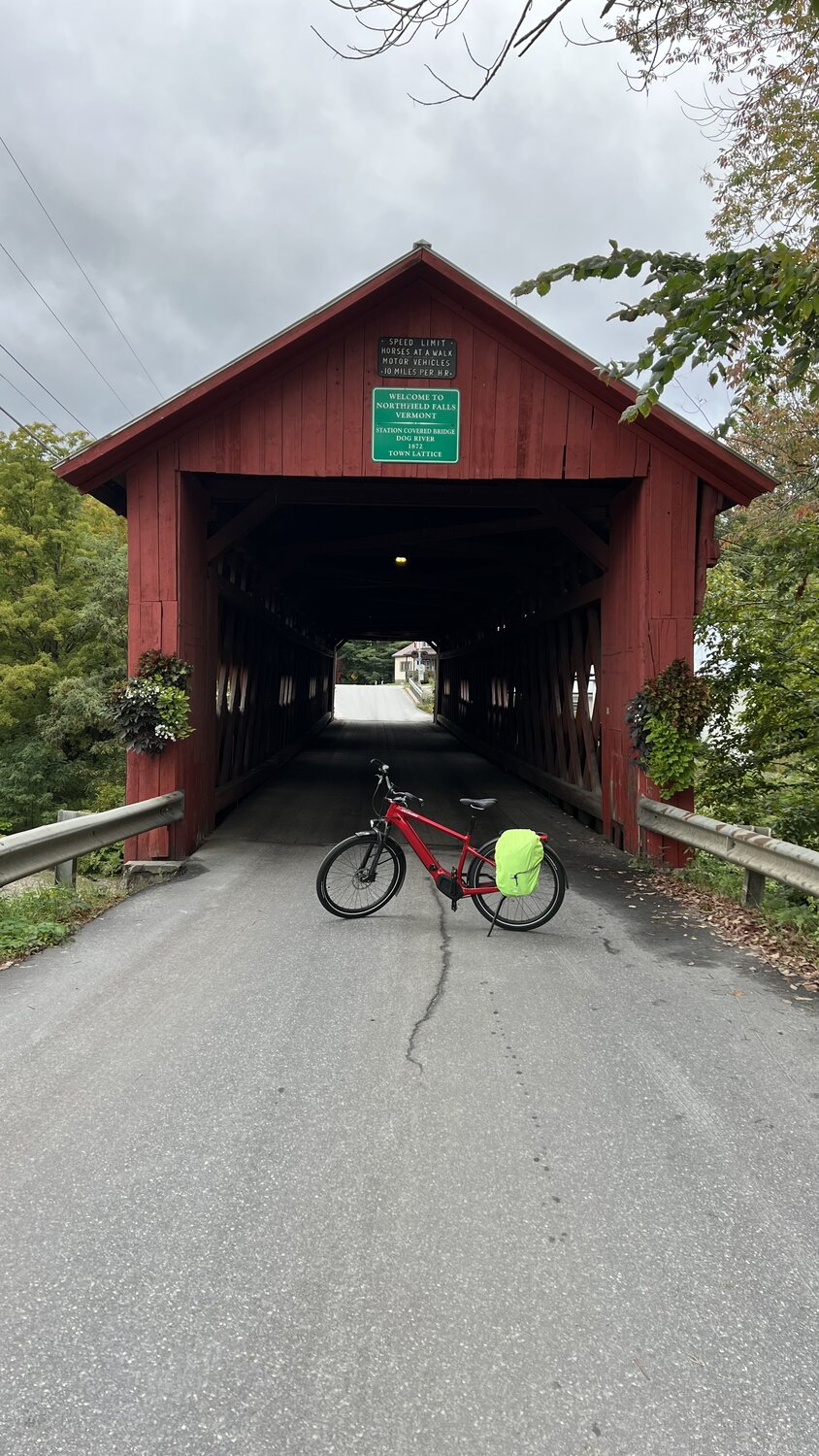

And finally, the moment you have all been waiting for….
I'm waiting for you to be making more and more miles! :)
I don’t see it going beyond what I did today on any regular basis. I simply don’t have this kind of time usually.
The plan is to incorporate more and more “life” stuff. Work from coffee shops. Get the burley nomad and grocery shop with it. Hopefully take cars to service and bike home. Etc. Maybe even do kid drop off or pickup again.
None of that reaches the mileage I did today.
