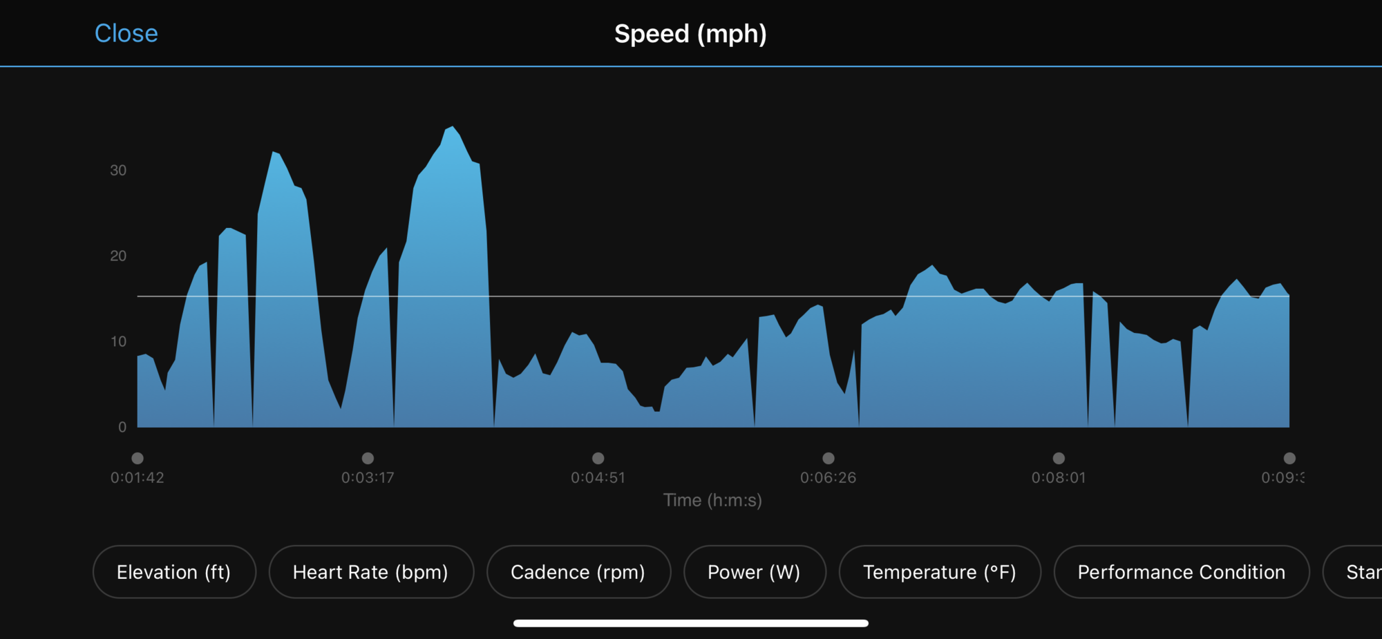

Like attached. The problem is that is recorded by the garmin. What that doesn’t answer is if the garmin is messing up or the bike isn’t broadcasting. Previous rides don’t have a lot of spikes like that. With my luck, the problem is *also* new. Will look at previous rides closer. I did not stop on the above ride except for one intersection.

that’s useful. so, we know that the garmin is seeing speed drop to 0 intermittently. do you know definitively that the speed in the chart is from the bike’s speed sensor, or GPS, or an integration of the two?
Yes, it’s the speed sensor. And, the LBS connected their diagnostics thing and found a magnetic sensor error for the day the motor stopped. That is also when it started being intermittent (to my knowledge). The first ride after that was the first with the garmin forerunner.
I am checking MC rides to see if they show the issue. But right now this looks like a sensor problem plus poor timing.

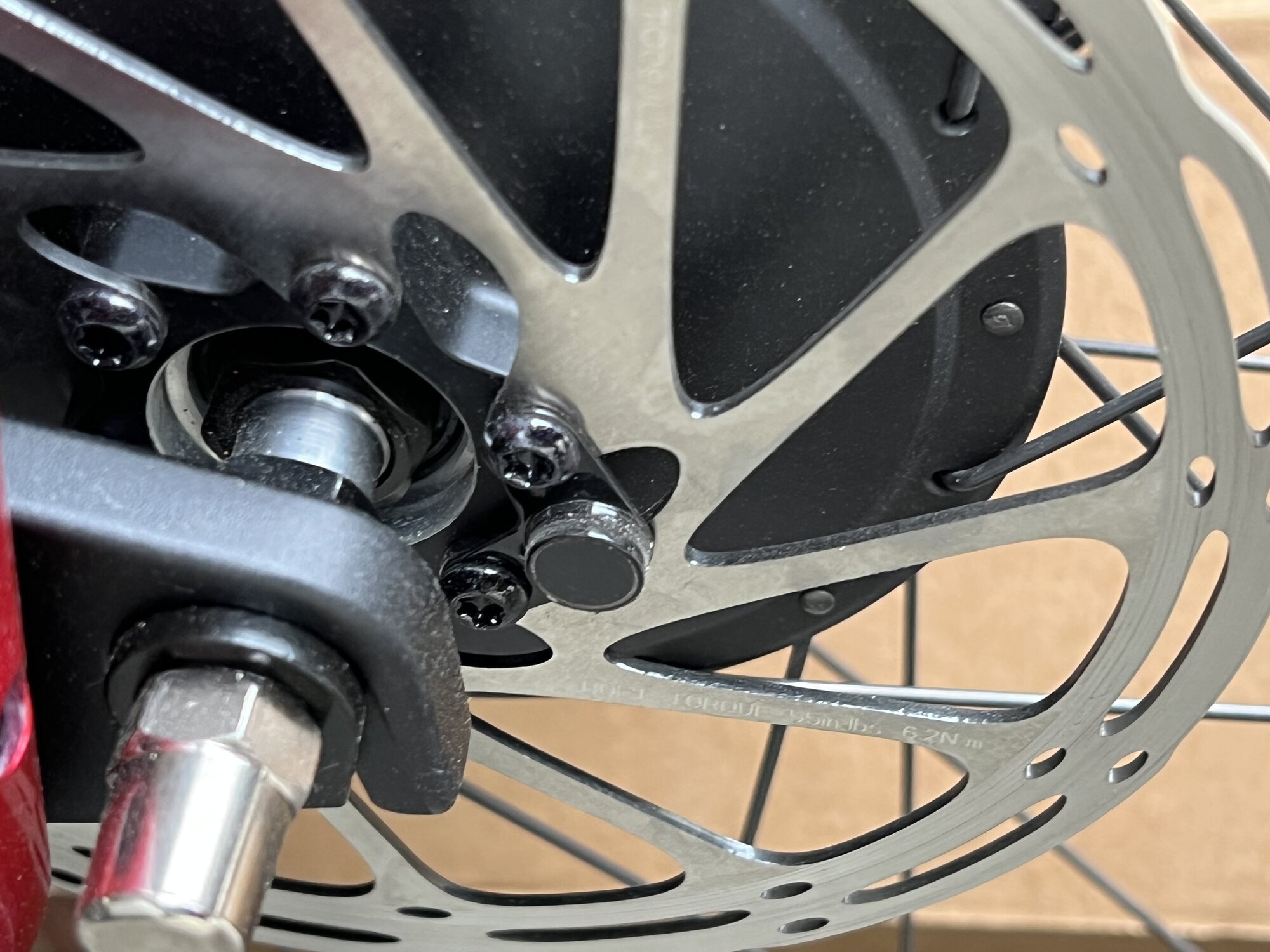

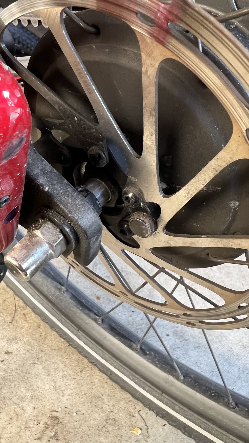

anything unusual looking with the rear magnet?
does the IGH version have the same rotor assembly that this one that @Dchilder posted?
Ok, so, the forerunner has officially entered the "I really do like it" category. I do not believe the auto-pause issue is garmin's problem (at least, not exclusively). I also suspect that switching the methodology from "when stopped" to 1, 3 or 5 mph will cause it to use an average eliminating the issue *even* with signal drop outs (I will test this while the bike is still broken).
It is *not* coasting related at all either. My ride yesterday had drops frequently while pedaling. So it clearly uses the speed sensor "exclusively" when present for auto-pause. (and frankly, it makes sense to do so when the sensor is reliable. multi-sensor auto-pause should only be valuable if some/all of the sensors are not reliable).

Finally, one observation, the speed sensor issue seems to happen more frequently when I am *not* using assist. It was triggering almost constantly when I turn the motor off in several scenarios. Garmin let's me overlay these graphs and something like 90% of the speed sensor data drops were while the motor is off. New sensor should be here sometime next week.
