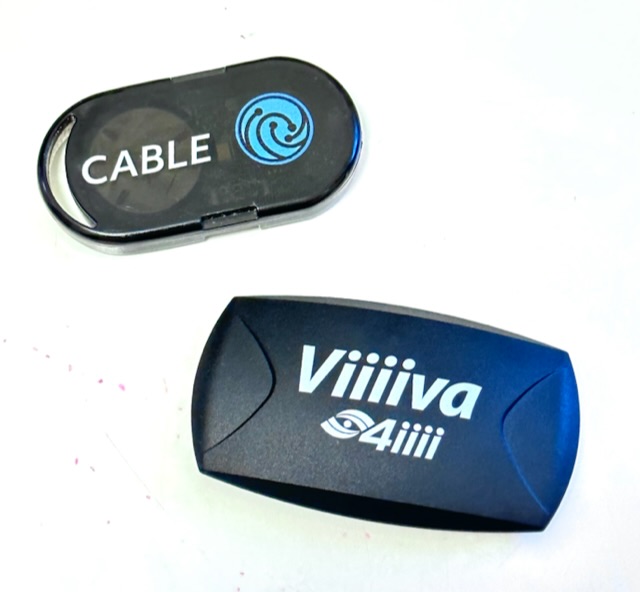

Because I am not putting an extra device on me to solve the problem. So, either NPE Cable is it, or it doesn't exist. NPE Cable can live in my bike bag. Permanently.
once again, if that’s what you want, just get the viiiva and put it in your bag. you don’t have to wear the thing to use it. you don’t have to pair the HRM channel. more things you’d know if you tried it instead of just speculating!

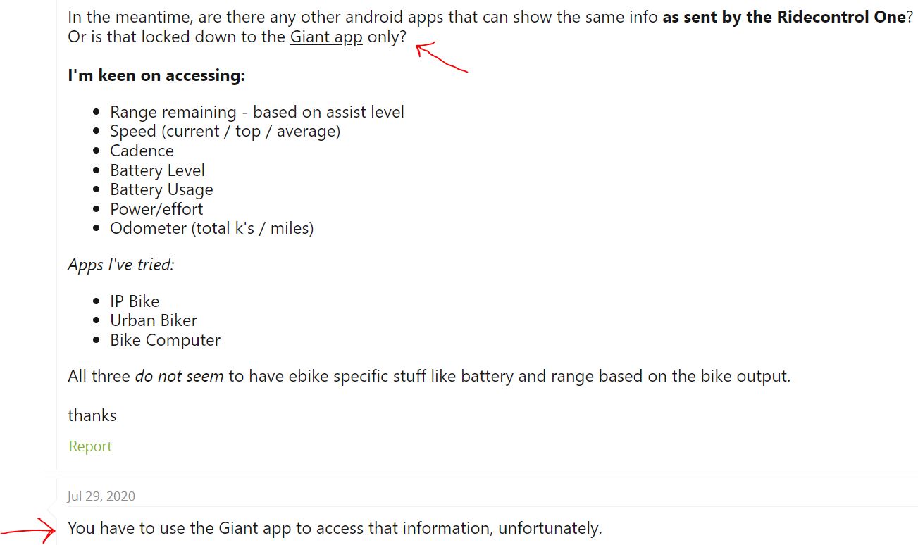

walled garden, indeed. a random app specialized undoubtedly never even thought of when they designed these bikes, displaying cadence and power on an iphone which hadn’t yet been released.
edit: doing a little research, i see that mahle, giant, and yamaha also support ANT+. the first one i looked further into is the giant ridecontrolone module, which uses the same LEV profile for ANT+ that specialized does, but, wait for it ............... by bluetooth, only connects to the giant specific app.
I do know this. Do you know you have to activate it by touching the contacts? Npe cable wakes up automatically. Am I wrong? When I stop my bike for too long, viiiiva goes to sleep. If I don’t dig out of my bag and touch the contacts again, it won’t bridge the data, because it's off. So much for coffee breaks. You can learn things without having the device. Try it out. Let me know. Did they change that feature at some point? (Technically viiiiva doesn’t support fe-c either or whatever the control profile is. Not an issue for me as far as I know)

NPE Cable and Viiiiva have shown that *basic* data could be moved using other methods. Specialized has not done this. Specialized has also left their apps in an embarrassing state. If your "criteria" is "show me others that do it", I reference you to nearly every other fitness app on the app store. Take your pick. But it's a good thing they have an "open" environment....

1. Giant Ride Control app does not connect to Apple Health.
2. Giant e-bikes have ANT+ and do not connect to Apple Watch.
3. Giant Ride Control only sends the rides to Strava
4. Giant Ride Control app is one of most pathetic e-bike apps I could use.

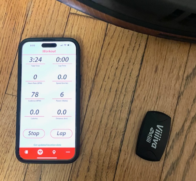

Did you actually use viiiiva or npe cable with RWGPS? Because they just told me that viiiiva is not compatible with RWGPS.

i didn’t try cable with rwgps. hard to see why it wouldn’t work, it works with other bluetooth sensor aware cycling apps, and the profiles look standard when paired to cadence. cadence has a much better pairing interface where the device and data channels are clearly identified, and you can see in real time during pairing what the content of the field is.
i can easily confirm if it works tonight. RwGPS definitely has better navigation.

so, in an illustration of the sorry state of the bluetooth profiles related to cycling, neither the viiiva or cable seem to work with RwGPS. the viiiva only shows as a heart rate monitor and the cable shows no sensors at all.
i suppose now i should be surprised retroactively that it actually works so well with cadence 😂😂 which seems to be the only app that actually looks for multiple profiles/sensors within a single device.
ANT+ has none of these issues, having been designed for this type of equipment. really too bad that phones don’t support it!
