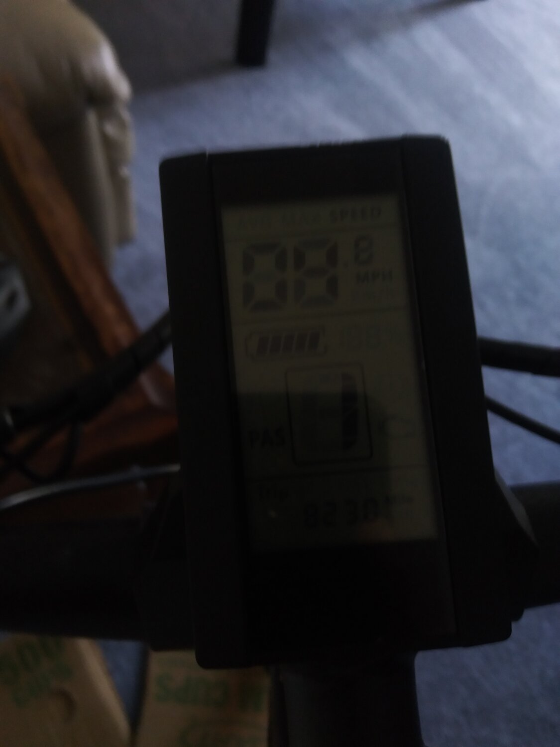

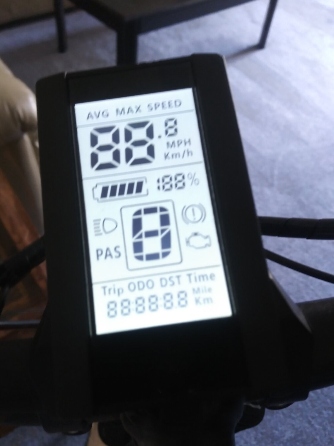

unfortunately I have tries to pedal with the pas and it wont kick on. When I push the throttle down nothing happens just pushes down. Feels weird actually now to me since im used to something moving when push down throttle. I tried to include pic of when I turn it on and then for a second the symbol that looks like an engine stays on? But only for a second? I tried to attach pics. Its kind of hard to see but on the right side under the {!} symbol but again it doesn't stay on it goes away as well.

Have you tried disconnecting the brake wires yet?

espin said its the replacement controller. My bike is a month out of warranty so its 75 bucks but they are sending me a new one and hopefully I dont have trouble installing it. He made it seem like its not that hard. Have you ever done something like that ? Either way I appreciate your time and stuff trying to help me thats awesome

Oh wow after reading that I hope I can do it. And the LCD was showing a 04e and he said that was a error code for that specific part. He said since the battery was blue when pushed and the lcd started up it was not the actual battery..so I am hoping as well. I just paid for the part for hopefully early next week I can get this back running. Your awesome man

The owners manual says 04E is an empty battery. https://www.manualslib.com/manual/1926404/Espin-Sport.html?page=16
Hmm. I talked to the guy from espin for good amount of time and we went over all stuff he thought it could be. IDK why it reads 04e when the bettery isnt empty ..it shows full charge, lights green on charger,. Maybe that was the next thing after ruling that out? Also something said about how the bike ran for like a split second for dieing today so he thinks something in there got burnt out. Thanks for link rich
