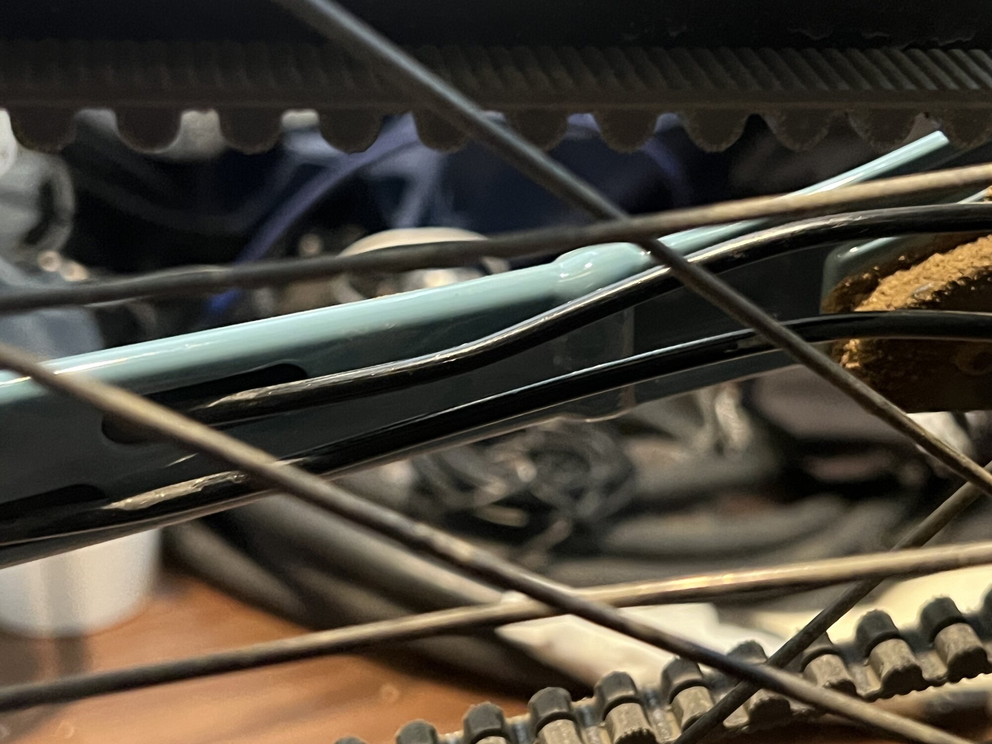

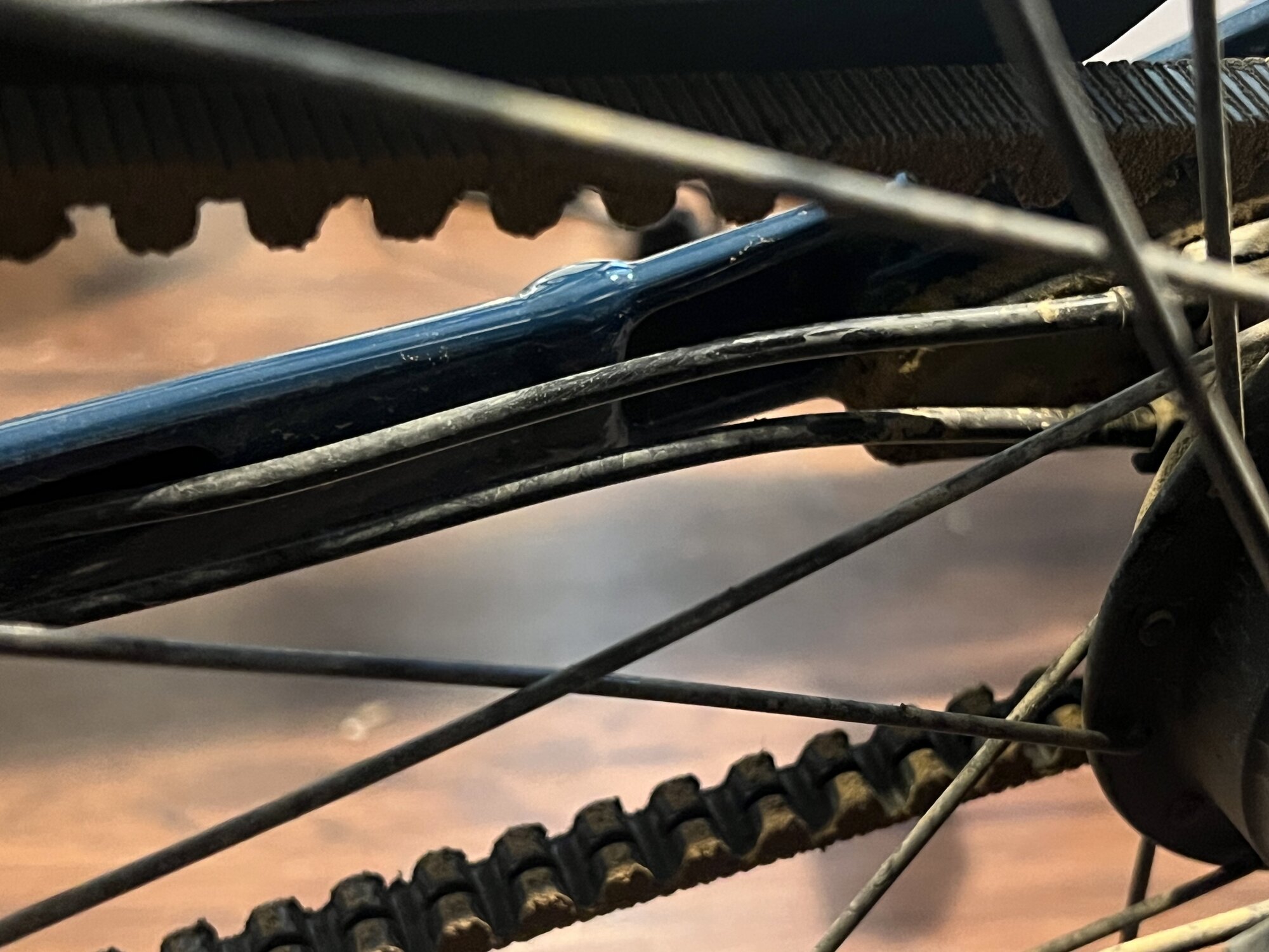

Dark blue bike - cables seem normal (bike shifts fine with no load)
Light blue - slightest bend in cable (bike shifter is stiff)

I can't tell exactly, but it looks like the light blue is not entering the sheath as straight.
