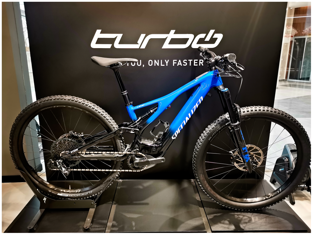

It's a beauty though!Hi friends,
I drove to Specialized Brand Store in Warsaw yesterday: the reason was to replenish my chain/small parts stock for Trance E+. Specialized Warsaw store was opened on Saturday, and they keep a lot of hardware for sale that is even hard to be bought online nowadays. Of course, I was admiring e-bikes exhibited there. And I looked a bit longer at this Levo:
Not sure what model that really was (I was not that interested). However, two details have attracted my attention: the FOX Float Rhythm 36 fork (it could be 160 mm of travel) and FOX DPX EVOL damper. Very, very similar to what I got on my Trance E+ 2 Pro. Given big price difference between Specialized and Giant e-MTBs, I left the store satisfied with my 2020 choice![]()
