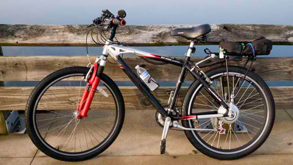

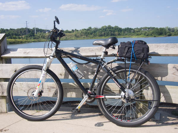

Wasn't trying to be wise guy. Just trying to be fair to the bigger spenders. I don't spend much if I don't need to. Here's one I built last year. I found this bike sitting out with the neighbor's trash. Two flat tires and no seat. Took care of that and here it is with a $170 motor kit and a pair of close-out 36V scooter batteries (75 bucks). 20 mph max on 36V, At 15 mph, I'm confident I could go 25 miles.
And a few months later, I took off the steel suspension fork and put on an alloy fork that could handle a disk brake. Then I rattle canned the frame black.
