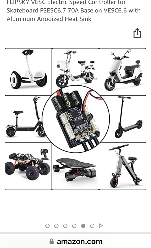

No need for a bunch of FETs and heat sinks. These days a completely different design, VESC, can be found in scoots.
