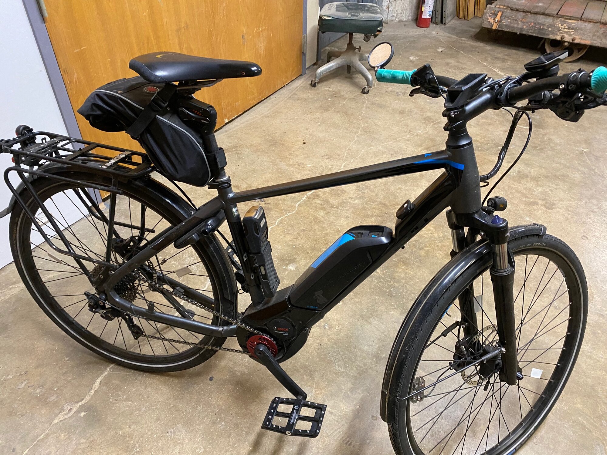

my bike is a bulls crossmover speed. and no I don't go slow I try to keep it at 22mph or so. though its in the city so lots of starting and stopping so the best I average is 18 or 19pmh. I use as little assist as I can but those speeds I am in tour the whole ride maybe putting out 160 or so watts. on our. tandem the motor cuts off at about 19 so then its just us. so that chain should last longer
Interesting, your bicycle is awfully similar to mine, same derailleur, similar geometry (Mine is a Haibike Xduro Cross).
The riding habits are also similar the only differences are my input is 200-250W range most of the time and use Eco or custom mode which is less than tour more than eco. When I go to %100 (custom mode less than Tour %120 ) I usually cruise around 25+ on flats.

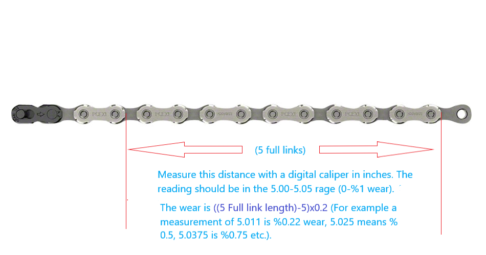

A word on chain wear measurement:
I do own a simple Parktool wear indicator but it only gives a go/no go answer.
Although I have a digital caliper, because it has the knife edges, it is very hard to reliable measure chain wear in between rollers(measurement that includes roller wear). I didn't want to spend $70 on a KMC caliper since it is nothing more than a cheap digital caliper with flat tips.
I can however measure stretch without the addition of roller wear( which is said to be the right measure since play in subsequent rollers cancel each other out) from outside, in between edges of outer plates. I use 5 full links (5 inches) and I can have consistent , repeatable measurements this way, 5.01 ~ 0.20 5.025~ 0.5, 5.05 ~ 0.1 wear.
So with a digital caliper with standard knife edges I measure my chains the following way. While the chain is under tension (measuring it on the bike is the best) measure 5 links from outside(every full link is 1" initially) since most standard digital calipers are 6" max this is a good length to get consistent measurements.
After 900 miles on the kmc 11 speed the chain still measures <%0.1. Waxing seems to work.

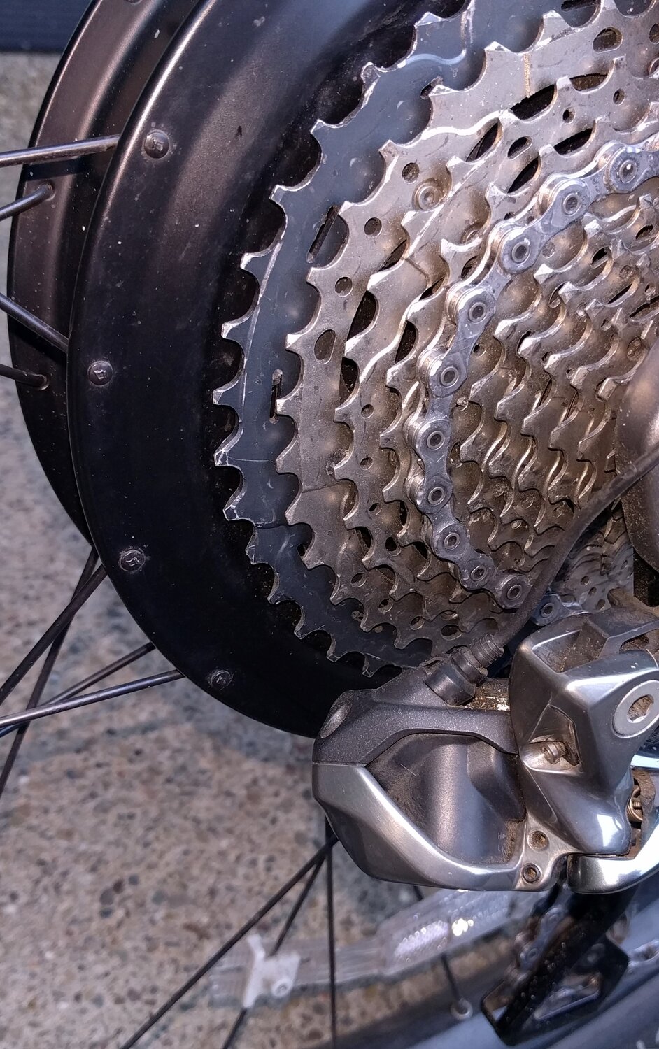

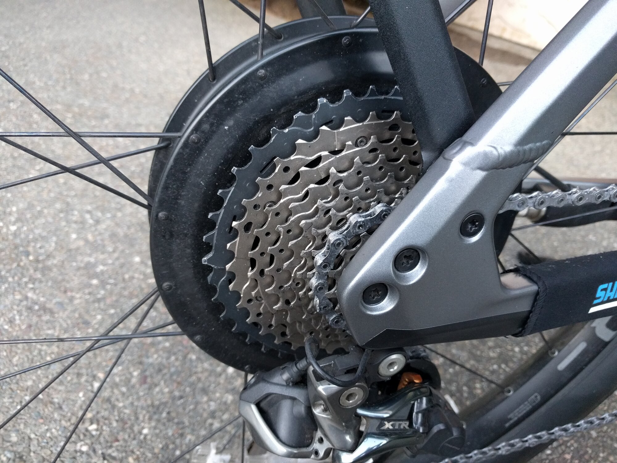

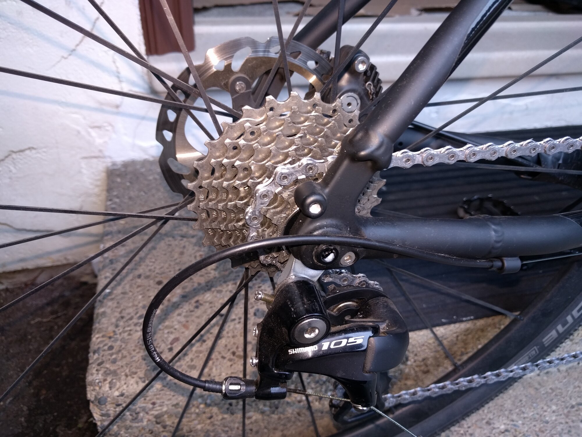

Below are recent pictures, one can see how clean they still are. Last time I cleaned these cassettes are 250 and 700 miles ago respectively.
