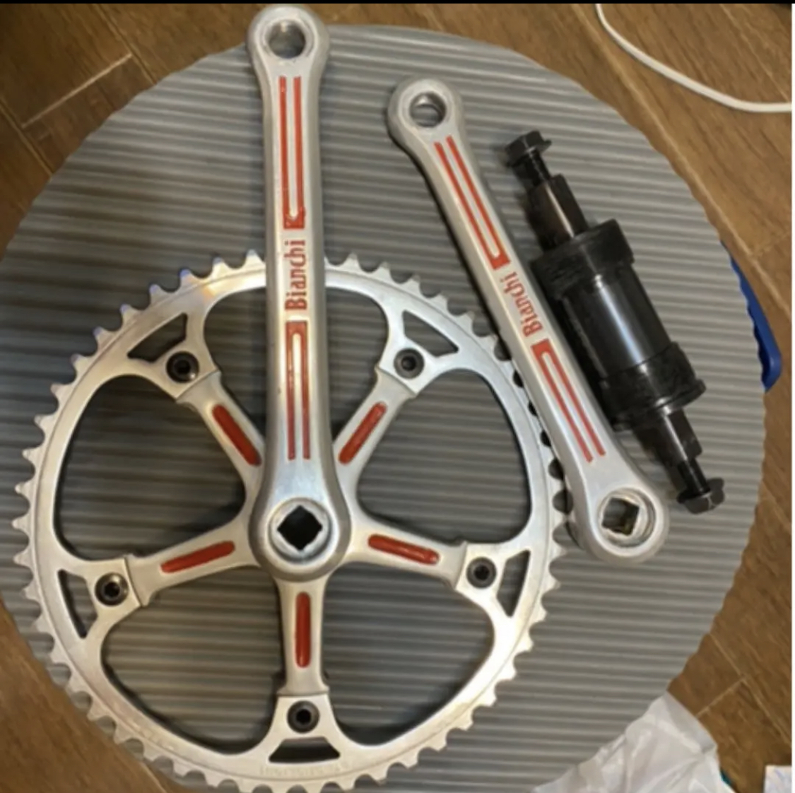

Man that’s awesome! Can’t wait to do the wife’s bike next year! The internal wiring really makes a huge difference in maintaining the classic aesthetic- paint that bad boy aluminum silver and it’ll be spot on with my wife’s bike. Do regular crank arms fit ? I’d want to figure out a way to attach this if possible:

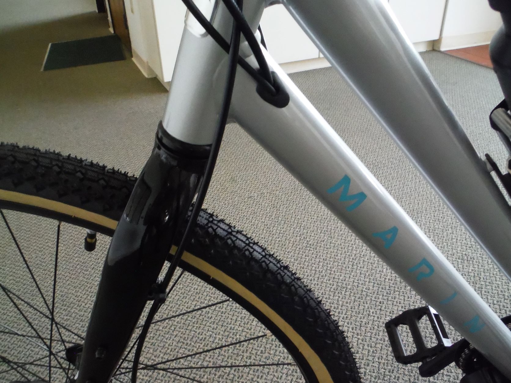

@VoltMan99, You would need to cut off the spider then use a 110 to 130 BCD spider to reuse this chainring. You will be better off installing the kit and just taking the matte black crank arms to someone such as a professional knife sharpener to get them polished out. Here is a through frame wired bike. It is a spanking new Marin. See the blue display? Note the lack of ugly connectors on the HB. It is a Class 3 ten speed. Enter into the Zen Garden of Less being More.

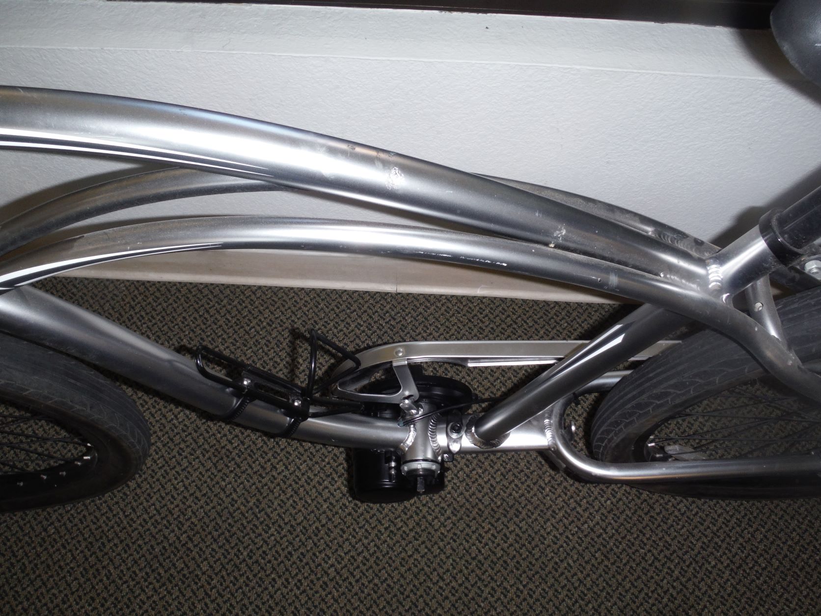

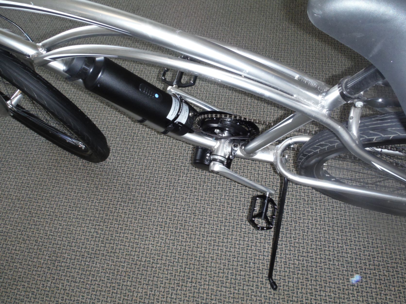

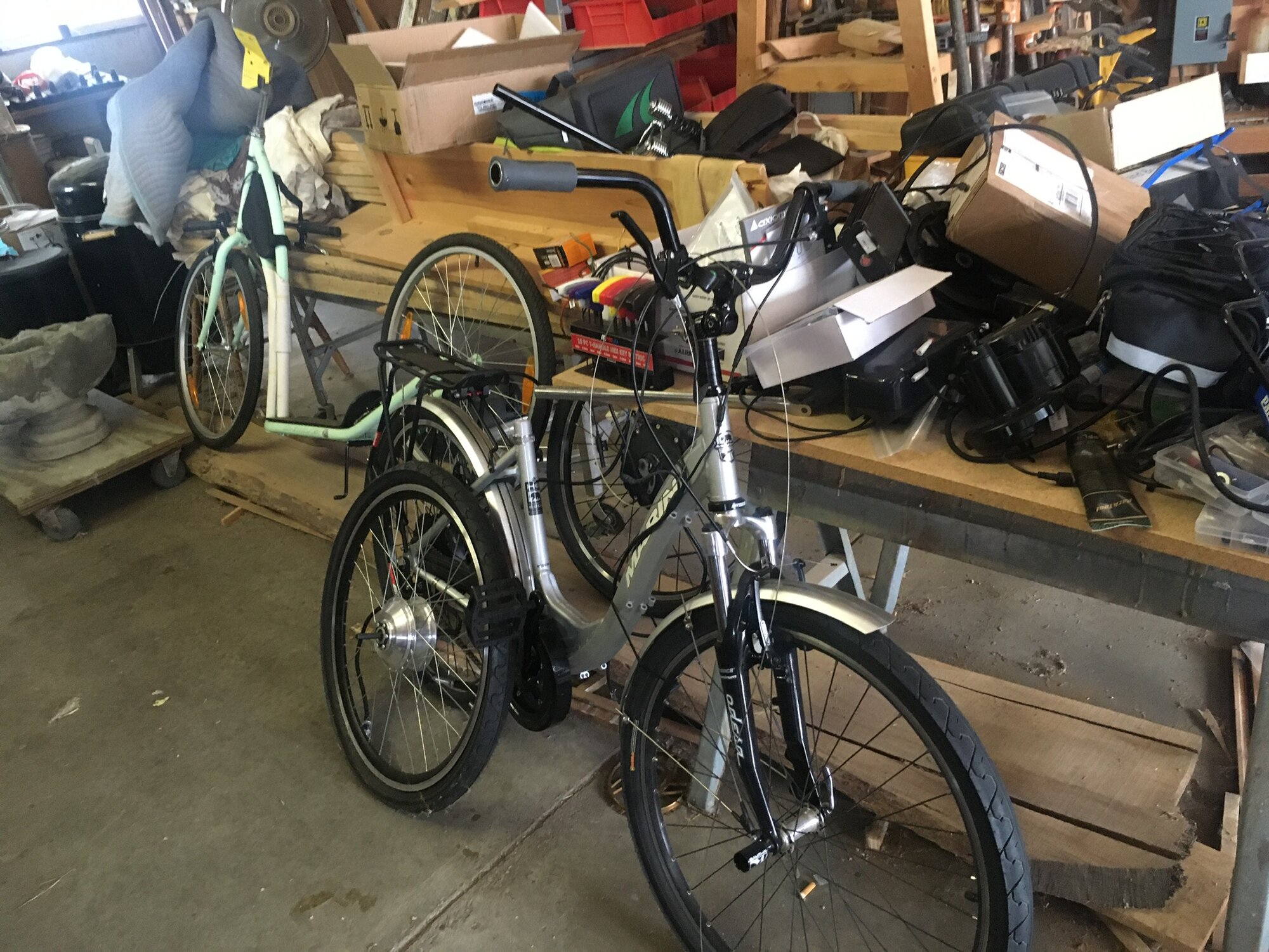

Here is the progress on today's project. Electrifying an Electra. Next it gets the chainring and crank arms. The single speed coaster brake hub will be swapped for a seven-speed coaster. New chain and done. All through frame wiring and housings. The battery slides into the water bottle cage. Class 3 cruiser.

Yikes! Your builds leave me in the dust!

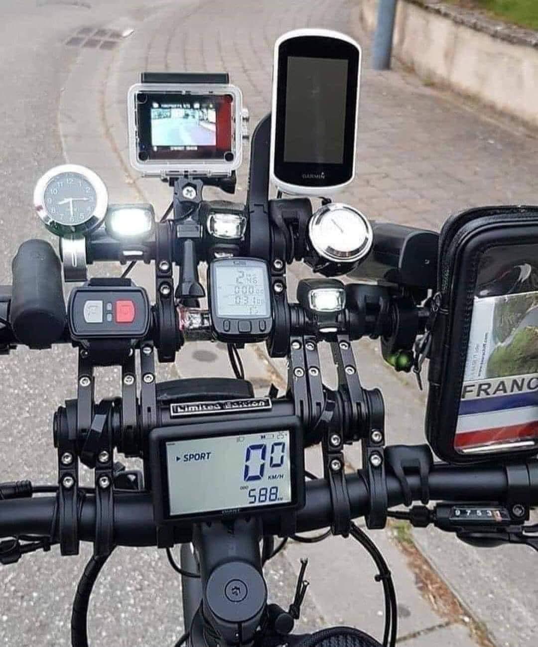

How can anyone even ride with all that stuff on the bars LOL.

The bike I am making now has two things on the HB, a shift lever with its housing and a display the size of your thumb with its wire. It is a coaster brake mid-drive with all internal routing. No one will know it is electric. I got in two rides on this perfect day.

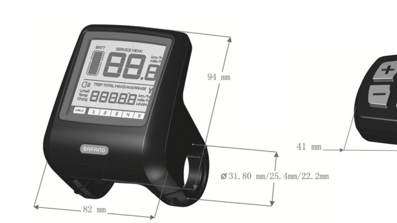

Bafang DP C07.UART 94mm x 82mm
7780 sq mm or 12 sq inches
CA versions 128mm x 57mm
7296 sq mm or 11.30882 sq inches
Let's talk about the amount of info shown on that just a little bit smaller display.,,,
