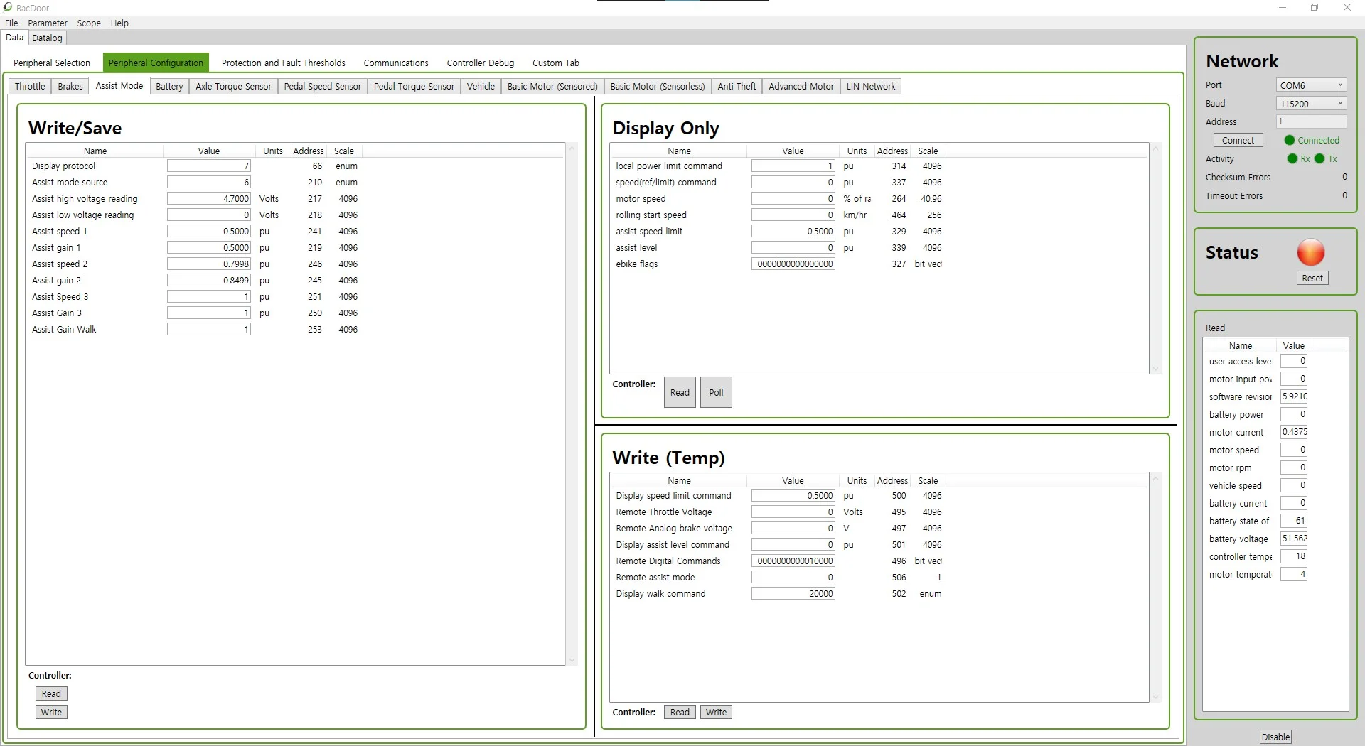

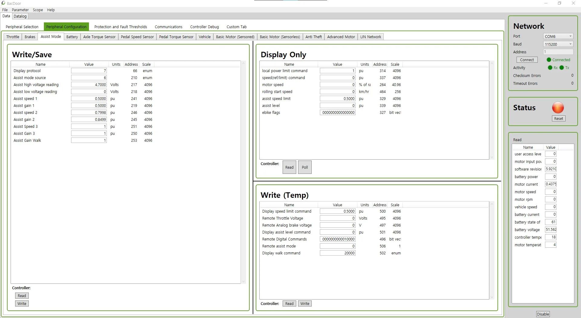

ASI has something called BACDoor software that provides access to tune about every parameter to OEMs and even for end-user, it can offer some very useful features.

Yep, that looks about right! Maybe even a little over the top, but they've set it up with write protections to keep a handle on it. Impressive. I'm sure it will be a mess at first, but as long as the end users don't need to develop their own user manual, or interpret "chinglish" into something more useful, it shouldn't take long for some common setup themes to start showing up - assuming the OEM "tune" isn't "just right" as it comes from the OEM.
