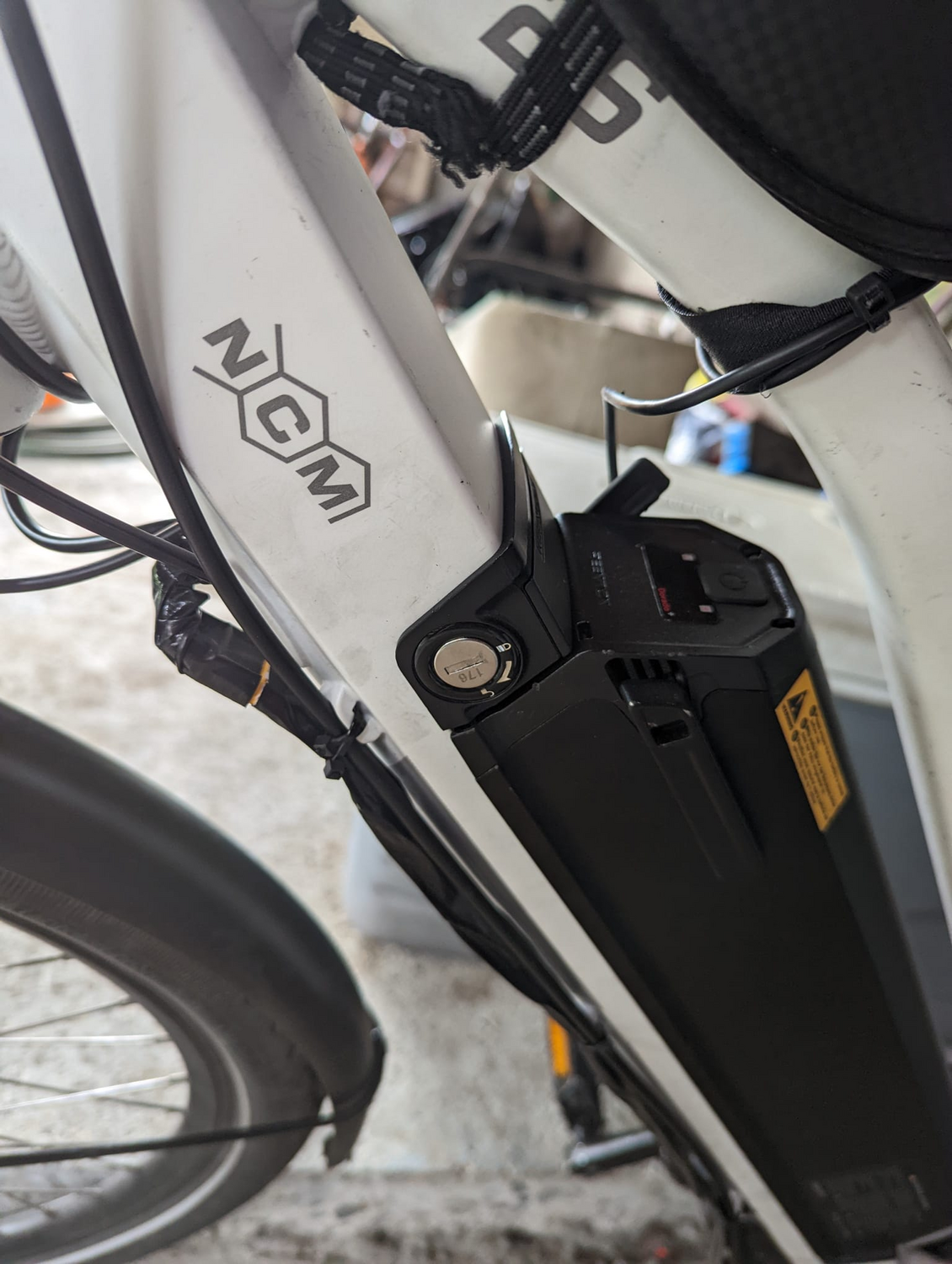

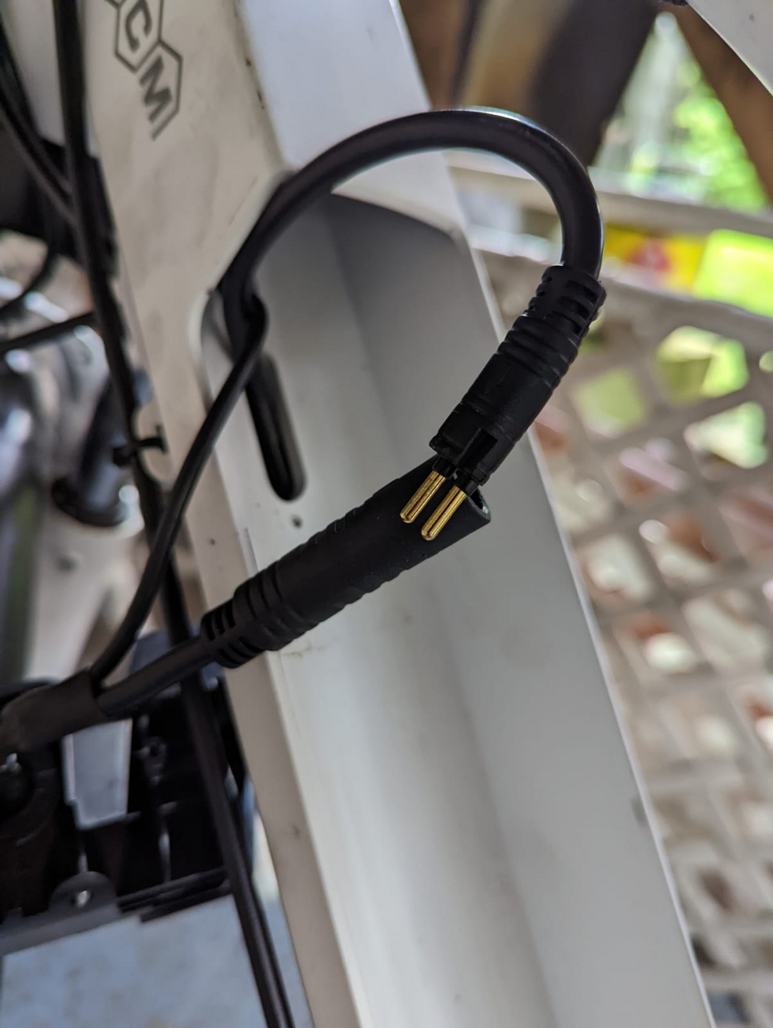

Thank you so much. So I went inside. This connector is called Julet but I couldnt find any xt60 adaptor on amazon. Is that the reason you recommend cutting the wire?
Whether you do it with adaptors, cutting wires and adding connectors, or other approaches, you would need to somehow make the 3 connections to the "blender" -- one from each of the two batteries, and one to the controller. I suppose you could even hardwire the controller connection, but not the battery connections.

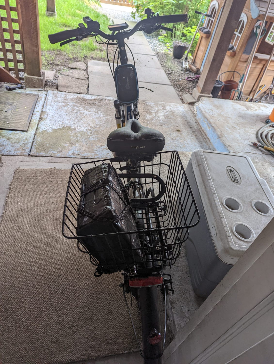

Very good...and where did you physically mount the 2nd battery on the Milano?
Dual battery balancer fits inside the frame. So, it is not in the picture.

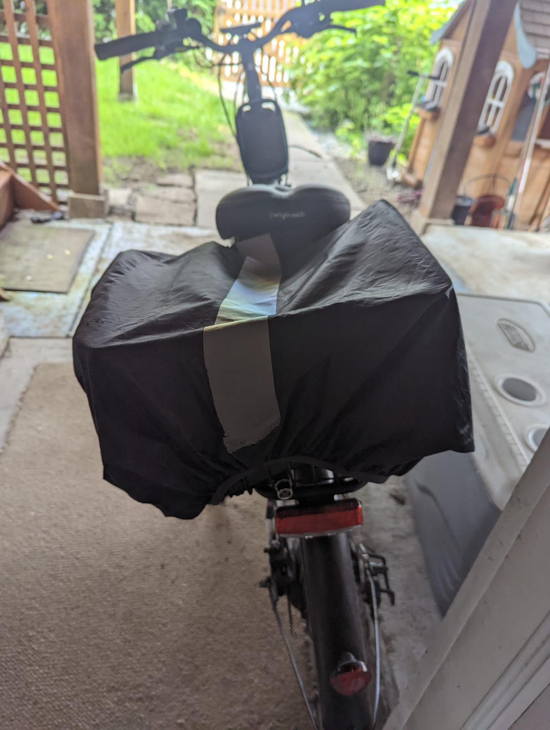

2nd battery I bought is
and here is my setup. could be more esthetically pleasant but it is fine for me.
