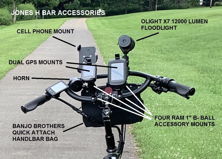

I also use the Kinekt 2.1 XL2 and was glad to see you made yours fit. I'm 6' 2" and had some doubt if there would be enough seat tube clearance. I also prefer swept back handlebars and use Jones H bars on my other bikes. From your pics, it appears there is enough slack in the control cables to allow for the swap. I prefer a slightly higher stem as well. Is there enough cable slack to allow for a 4" stem riser?

Yes, the Jones H bars are a bit spendy but they offer a lot of extra mounting space. I was originally going to get a swept back bar and add a bar extender for all my gadgets but the Jones solved both issues.
