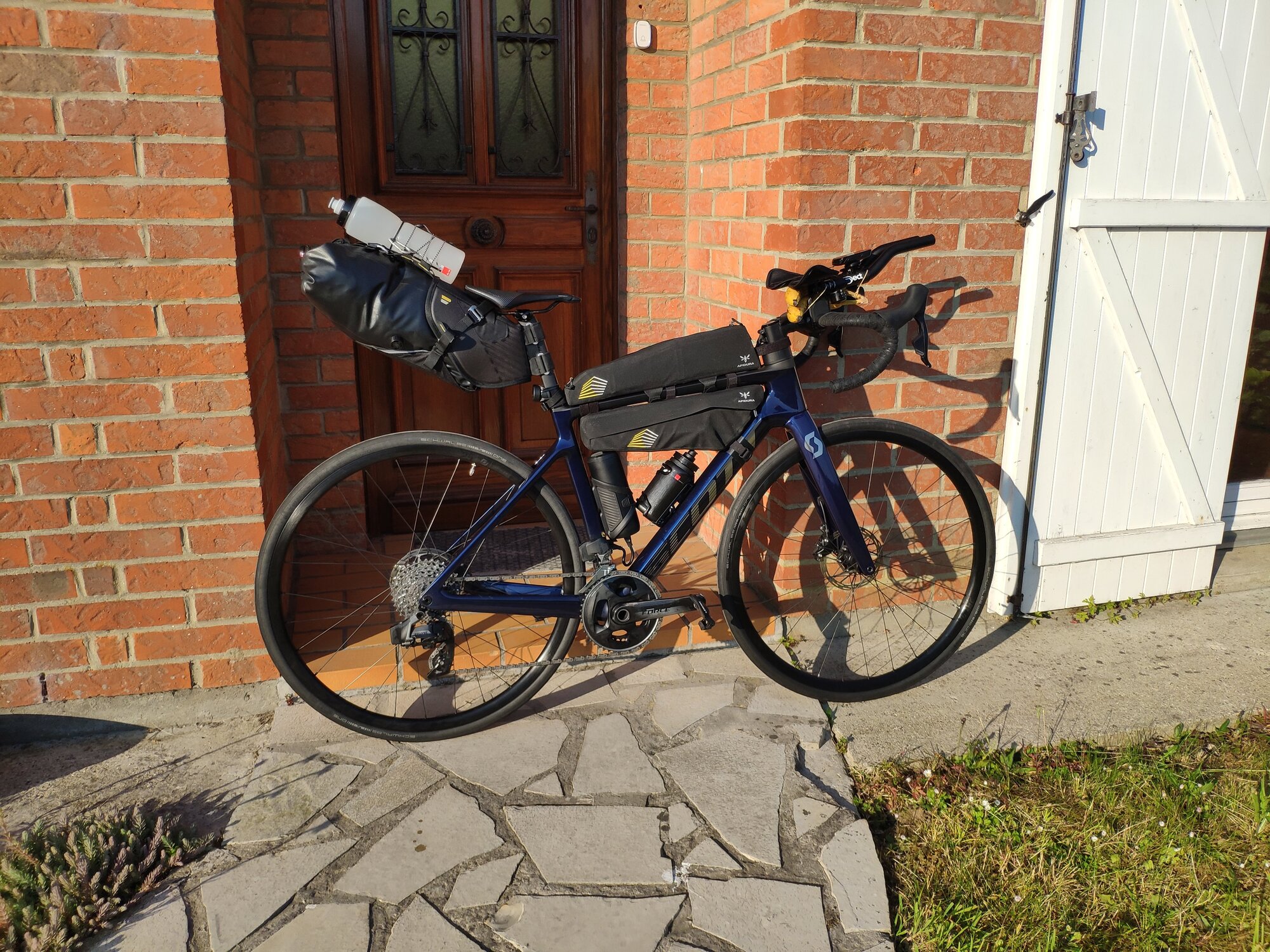

I don't know if it's written somewhere, but i just discovered accidentally that you can change level assistance to "0" (white light) with the remote.
Until now, i switched to assistance level to "0" (purple mode) by cycling modes with the ebikemotion button, but since i started bikepacking with my 2022 Scott addict eRide 20 (X20 motor), this was a pitty because of the top tube bag (see picture)...
But i was happy to discover that a long press on "less assistance button" (red arrow one) switched the assist level to "0", so i wanted to share it in case i'm not the only one to ignore it until now.
