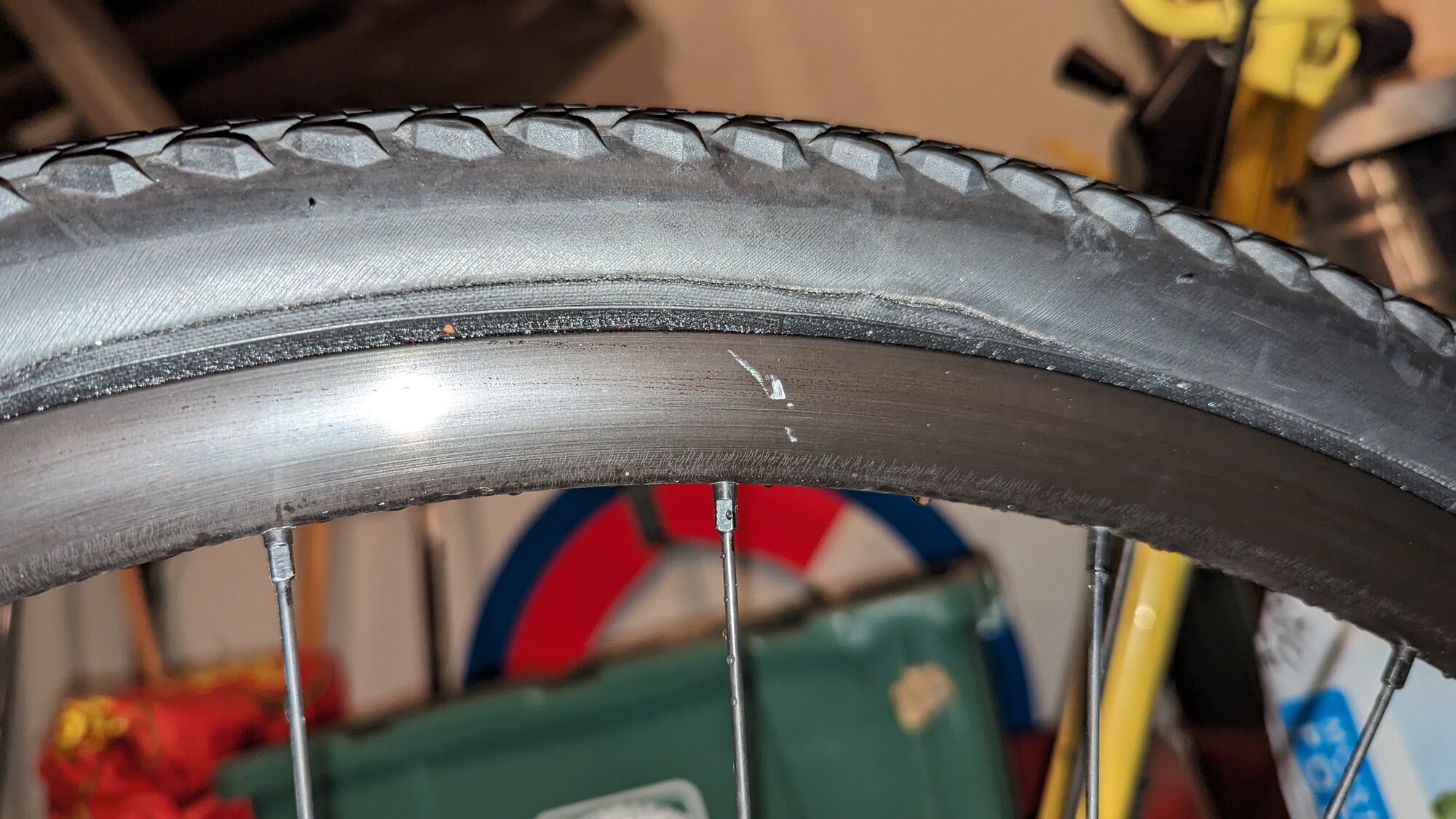

I am nearing 500 miles on these Pathfinder Pro tires that came on my new Specialized Turbo Vado SL 4.0 (non EQ).
I have had zero problems with the tires. They hold air sufficiently and I check them a couple times per week.

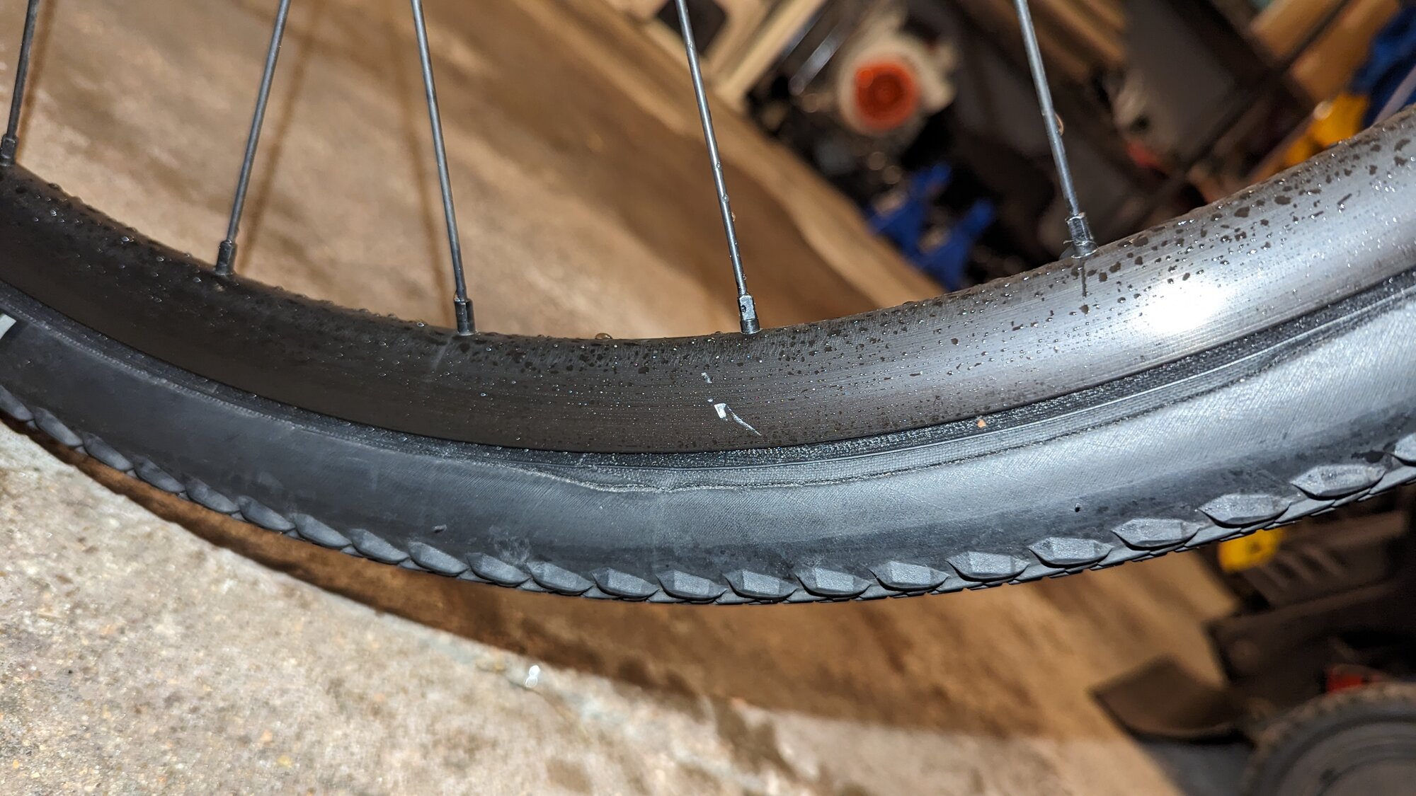

The other day I added a hitch mount platform style rack to my car. While trying it out a bit....and while the bike tires were raised closer to eye level....I observed a 'slash' type appearance along one of the sidewalls.
I would be surprised if I had somehow created this slash.....but I cannot be certain.
What do you make of this? I'm not freaking out....but it doesn't give me any comfort when traveling at near 30 mph.
I’d replace the tire. The tube holds air. That is good, but the tire, will it continue to support the tube? Looks like the bead is separating from the tire. I would definitely take it off to check closer.
If it were me, I would keep thinking about it, hoping that it won’t fail me. Replace it and no more worry.
If bike is still in warranty shop should be replacing it for free. Looks like manfacturing defect unless you have over inflated it.
I would definitely bring it to the dealer's attention in hopes of a free replacement. If they don't do it for free, pay for it yourself. It looks like a failure in the casing due to something happening on the assembly line. I doubt thats a slash.
I bet if you pull the tire off the rim you'll see more of interest than you can see now.

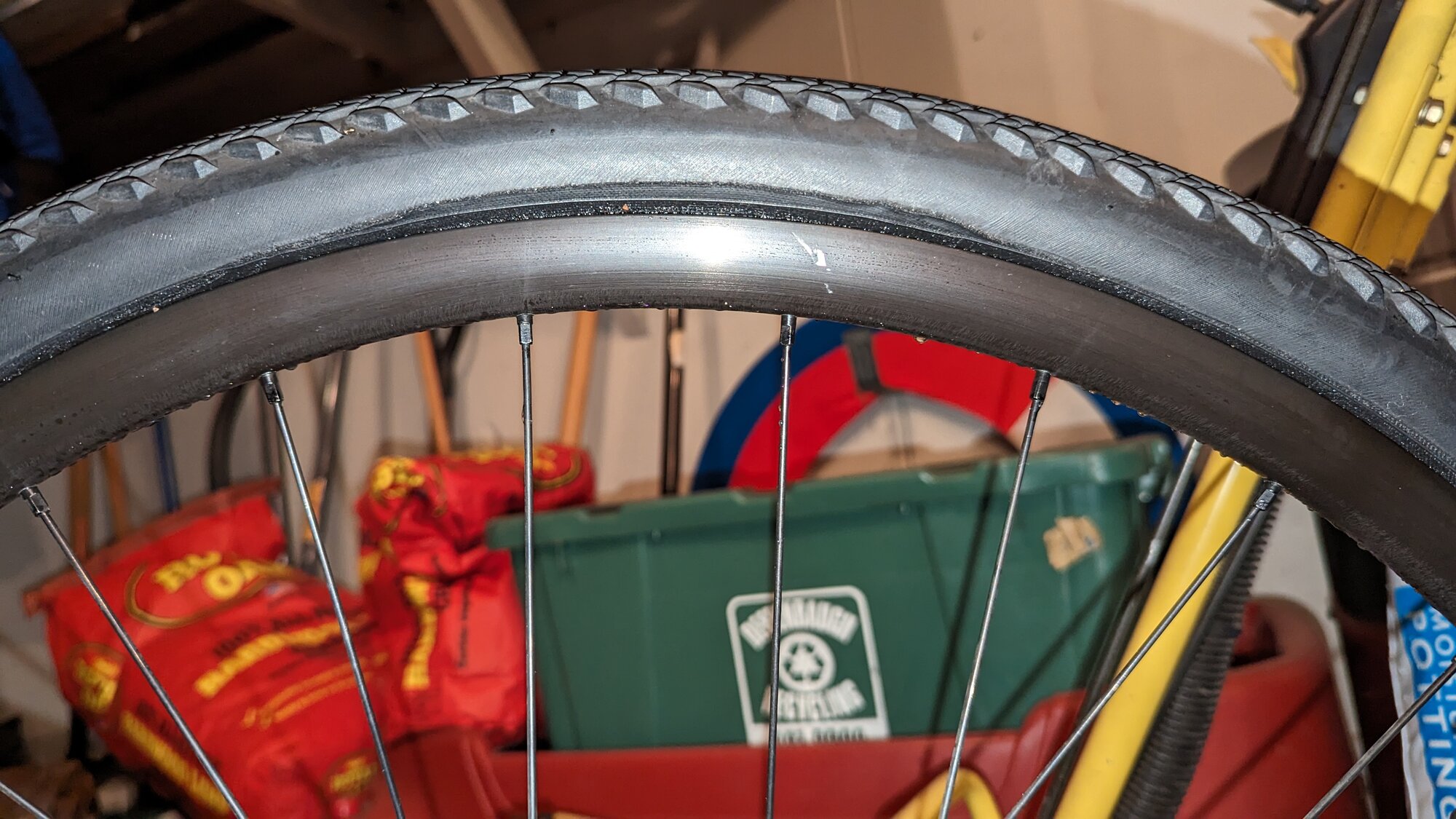

I see a pretty good nick in the rim. Maybe something got hit while you were riding?
That nick was there when I bought the bike new from the LBS. It's really superficial.
I took it back to them and they replaced it with the same tire in a 42..... Slightly wider.
I don't like it. I just ordered the tire myself in the same size that I had for $24. It'll be here in a week or so. In the meantime, at least I'll be safe
