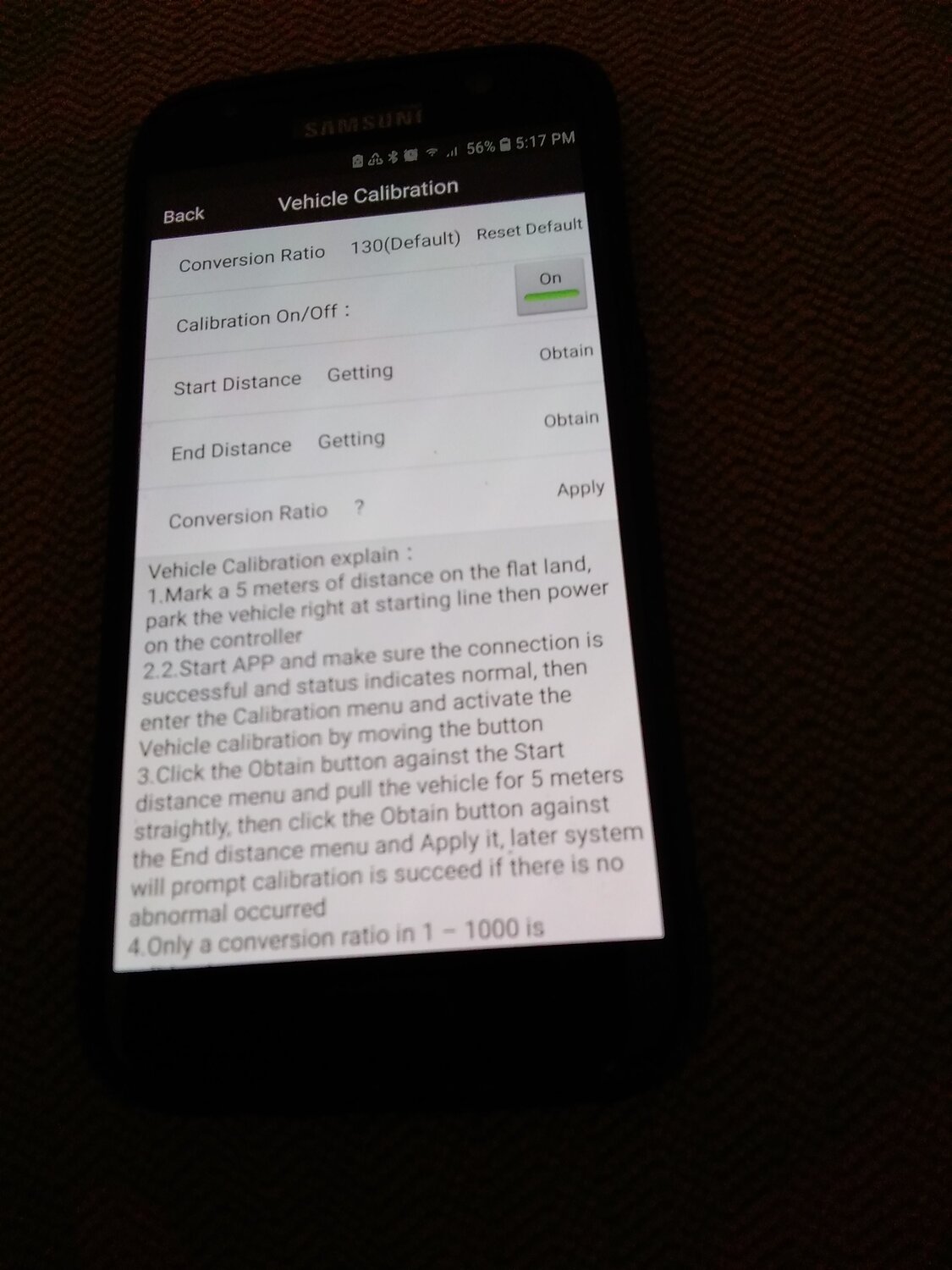

Hey, so I'm new to this forum but came across this section for help boosting the speed of my EM2. So far I've really enjoyed this bike over the year I've had it, however the one thing I'm slightly let down with is the torque from start. I'm fine with the stock speed of 55kmh, but is there any way with the app to improve the torque? I'm planning on upgrading the motor and controller in the future, but not until next riding season.
Also, if anyone with a EM2 has a group of settings they use and enjoy in the app, definitely let me know! Thanks.
I’ve got the EM3, and have it set to max for all settings. It’s been working great. Battery range will suffer but there’s got to be a trade off.
fast start =max
Soft start =off
Over speed 15,80
Speed limit off
Controller current 100
Controller phase 100
Turbo on although I’m not exactly sure what this does.
These bikes still suffer from lack of torque to get going quick off the line. This is because the factory controller is only a 35A continuous but 1000watt. And the motor is 2000w. So post warranty I will first try the shunt mod then get a new controller and batteries to support the 100a I’m planning.
