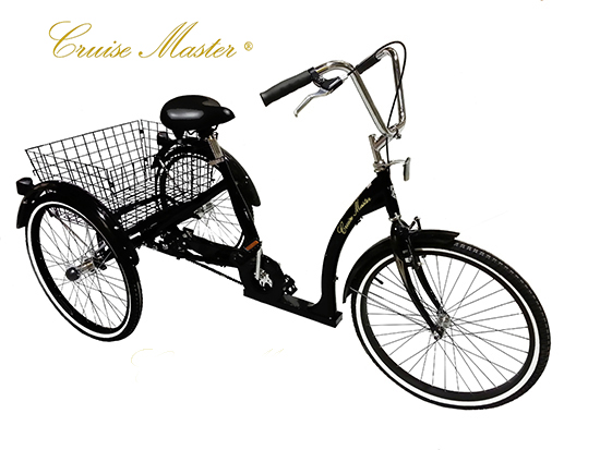

I decided on the trike linked. It has a longer deat post than Sun. sadly all have on piece cranks. Dumb. But I have some inserts from 70’s Schwinn conversion projects 5 years ago. That dashes the torque sensor, but that was just another experience project just to have hands on experience. Having quit CS calls and emails and Doug selling californiaebike I really don’t feel a pressing need.

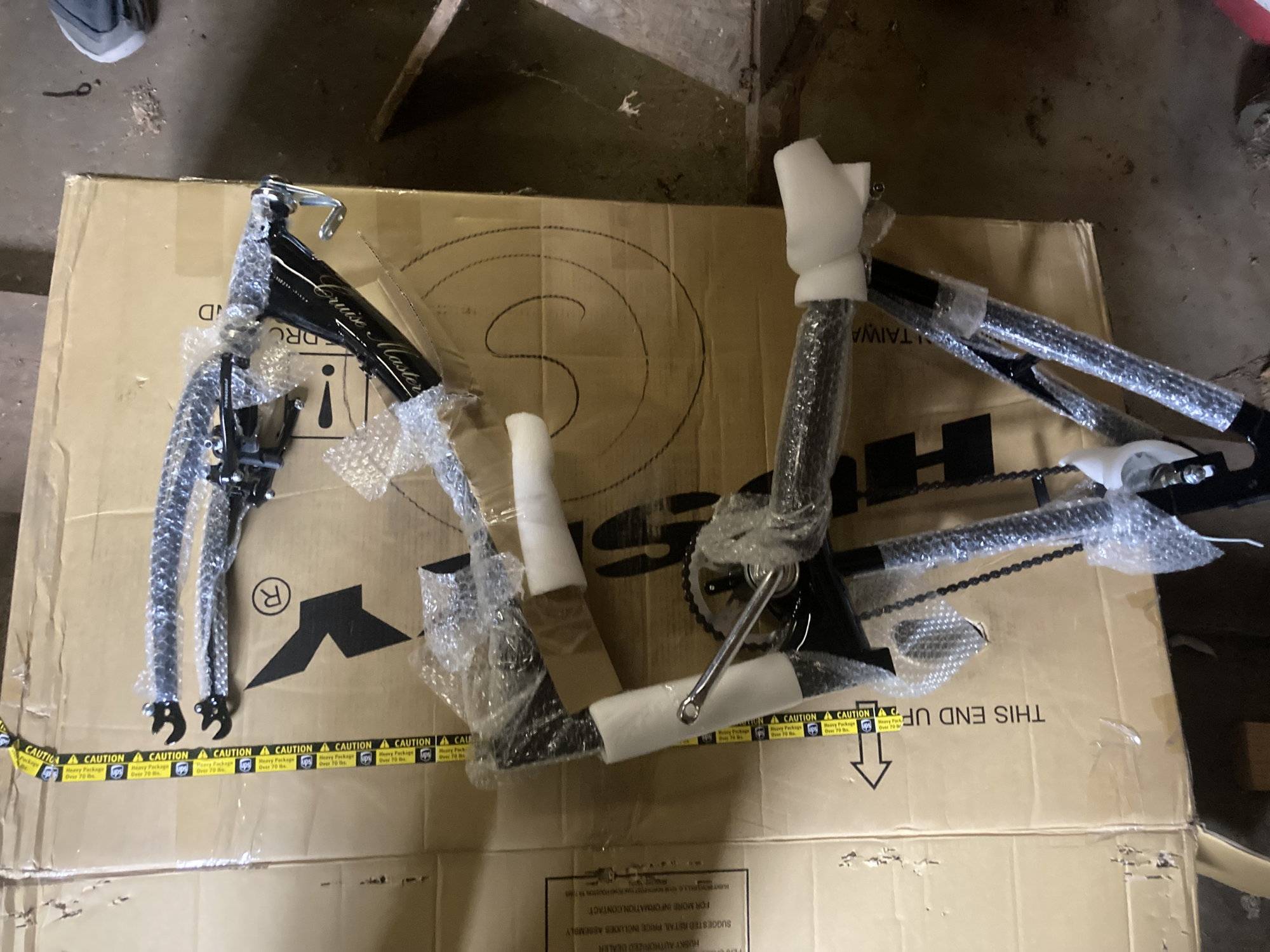

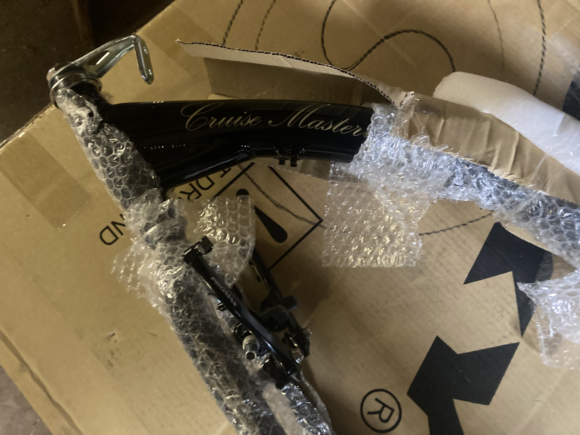

It's on!!! Actual photos soon. I'm thrilled with the frame quality. Fenders and basket are quite heavy-duty. UGLY whitewalls, but will be replaced in a week or two. Coming from BikeInn. 30% of the USA and Amazon prices. 24" Conti with Conti threaded steel Schader valves. My preferred. Everything else is nearly in place. Just a few more days of rest and recovery and the build will begin. I can't find a 24" front rack. I had wanted to put a small bottle battery on a front rack and ab EM3ev Polly case on the frame below the headset. I have a dual battery module, 48V LED front and rear lights, horn, LED running lights, 2- Grin torque arms, and more. WOOHOO!!!

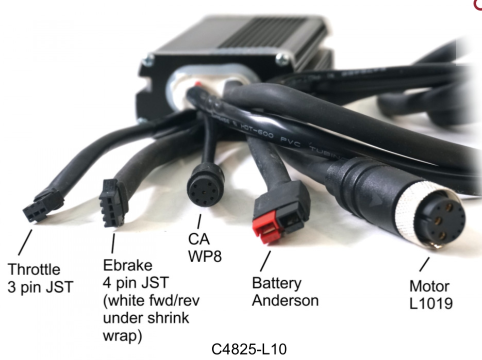

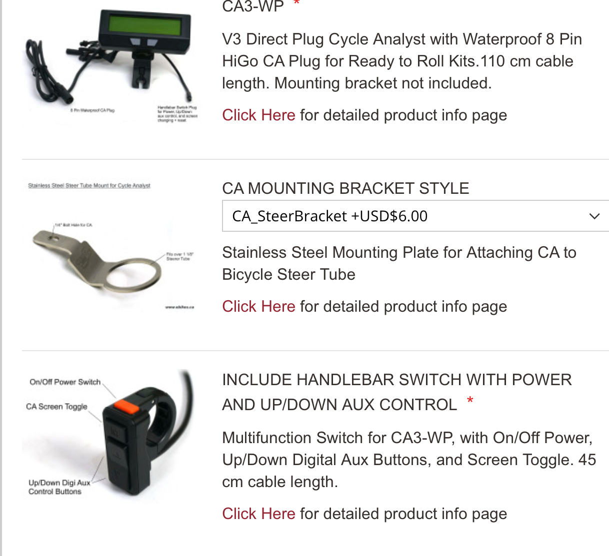

36-52V, 25A Sinewave Controller with ON/OFF switch, Proportional Regen. New Model with Waterproof L1019 Connector for Motor Plug and WP8 Cycle Analyst Connector. For direct-drive motors only, does not work well with high power geared hubs like the GMAC or eZee.

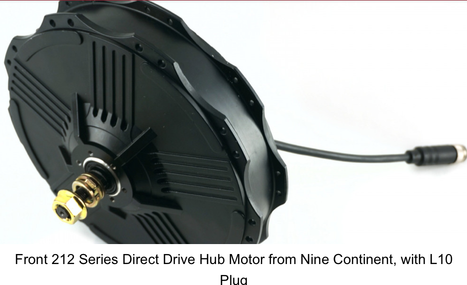

Nine Continent Front Cassette Motor, FH212 Model with Proper Bike Alignment, Statorade Ready, and L10 Connector. Standard 8.5 RPM/V Winding

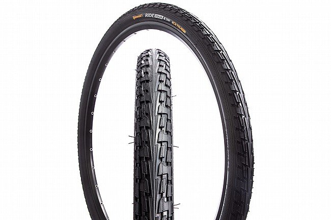

Tires, cheap whitewalls donated to HS bike group. 3 new Continental Ride Tour - 24 Inch

got a bunch done. As much as my legs and hands would allow. But good progress.
