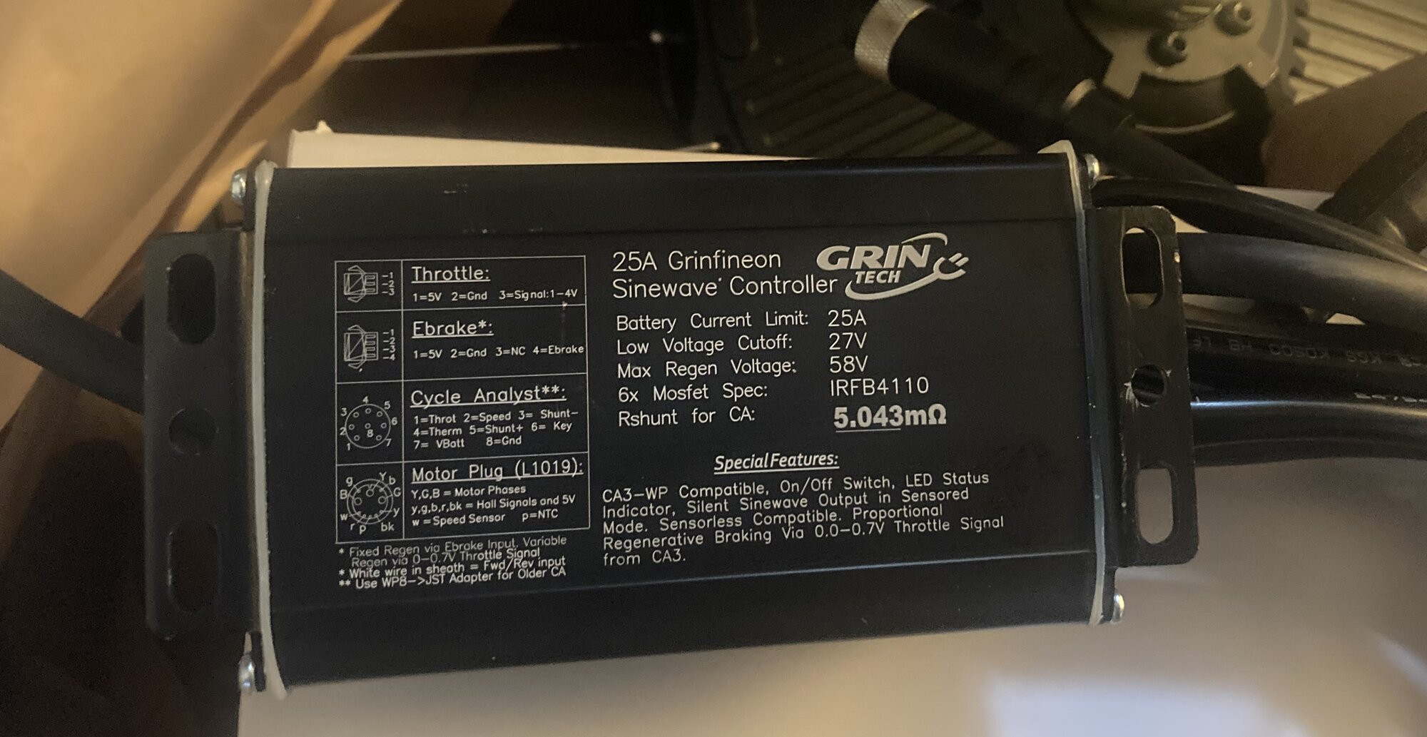

Motor, controller, EM3ev battery, needed pieces and parts arrived . Now ready for the trike.

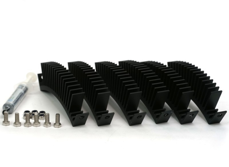

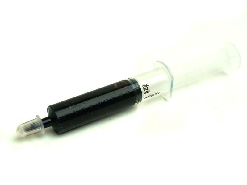

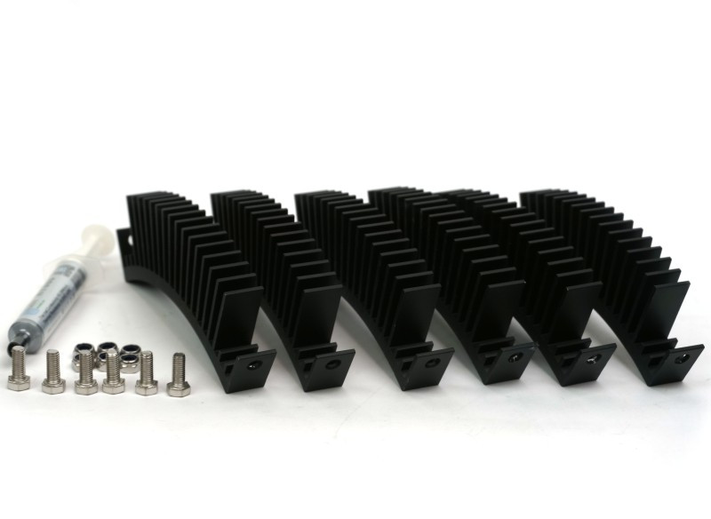

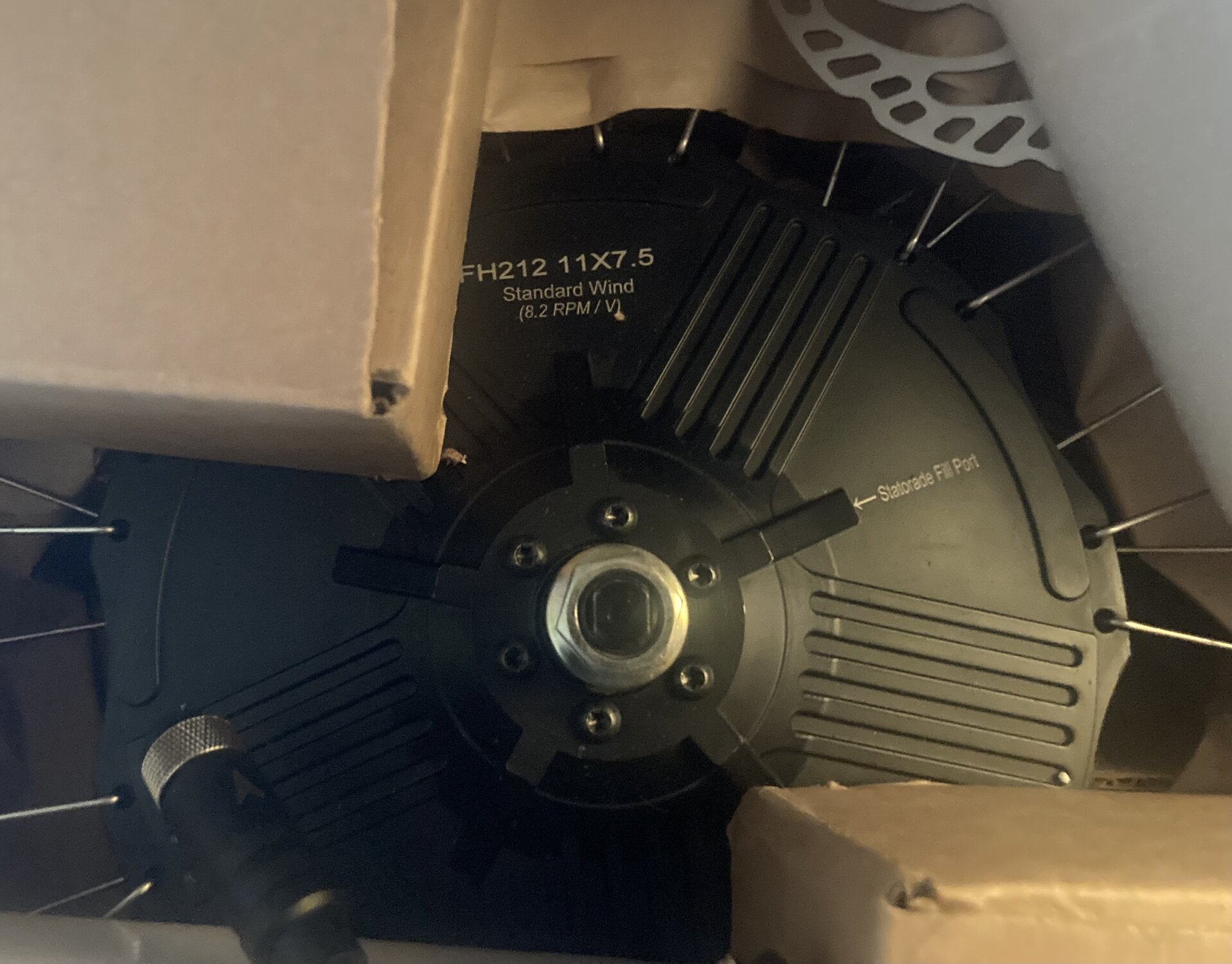

Added an order for Statoraide and Cooling fins.

Next, it’s which motor. Have MAC 10T 26” wheel rebuilt? Greenbikekit front GD? BBS01B 500W? All new.
Or,
Used MXUS FDD from my Trek Pure?
SEE POST BELOW FOR MOTOR DETAILS.
