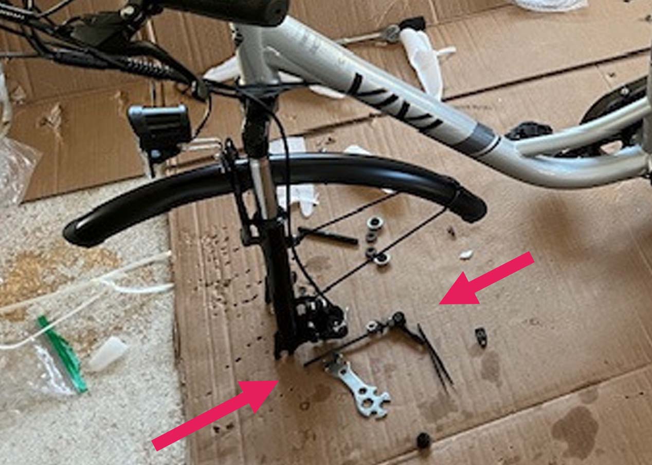

If that is a solid axle at 26tpi I just gave away 2 of those, 4130 heavy duty extra long. Both axles also had cones with dust deals, bearings and all other hardware. I ordered them from SE Racing to rebuild some loose ball hubs and managed to salvage one of the original axles. Ordered 2 and they sent me 3. If that is a solid axle getting the correct dust washers can be a bit tricky. Most of the bearing sizes are the same though. I forgot the size off the top of my head and no longer have the axles with the specs written on the bags. Good luck in sourcing the right part!
It is a quick release with skewer, not designed for this model.
Feb
Thank you, you have a QR skewer front axle.
Do you have any bearings, that came with the front tire/rim?

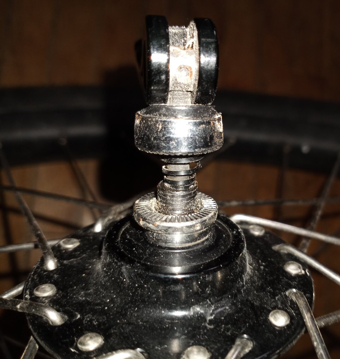

The way this front axle fits the dropouts with a QR skewer is this,
the bearing are installed in the hub, the cone bushings tapered ends are adjusted to the bearings and at the same time the axle is centered as close as possible and locked down using the thin nuts and the eyed hook lock, to have the same amount of the axle sticking out (on each end).
Then the axle/wheel is inserted into the fork drop outs, there should be the same amount of the axel sticking out in the drop out channel.
The QR skewer is then inserted thru the axle and the end is adjusted to lock down on the end of the bearing cones (see the marks around the cone end), the QR skewer is tight enough when the skewer handle leaves a mark in your hand,
(there should be about 1/8 to 1/4" space length difference/distance shorter than the drop out length space, for/on the axle.)
The axle should NOT touch either end of the locking ends
on the skewer, when locked down properly.
If you have the bearings, you can properly/safely fit the tire into the fork.

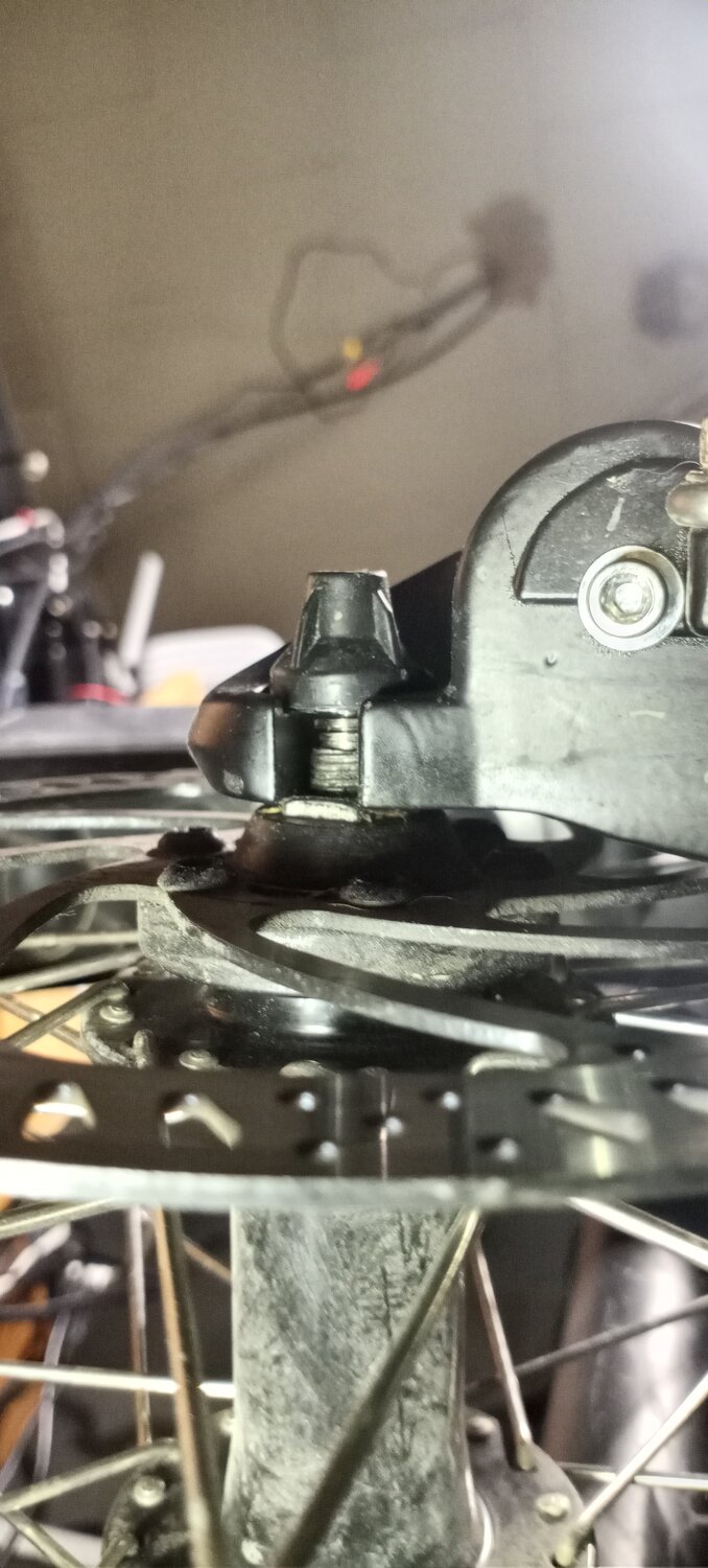

You must center the disc brake at the same time as centering the overall axle length. A lot of bikes come with disc brakes now a days.

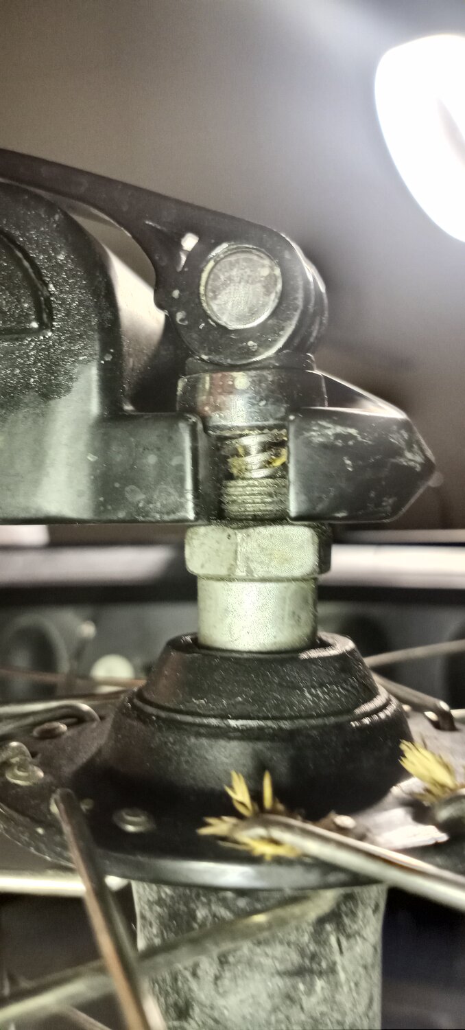

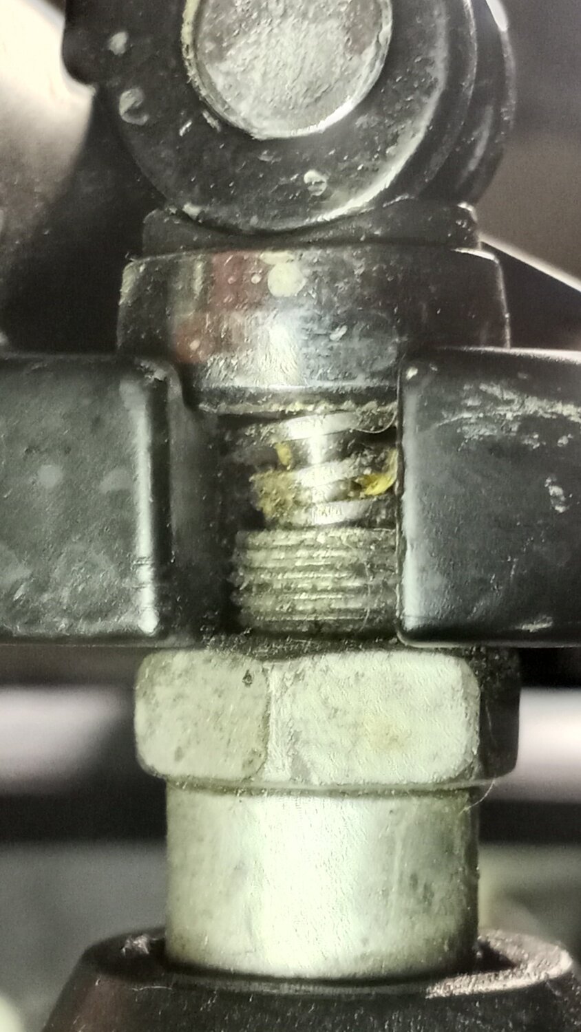

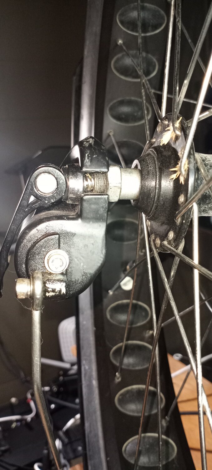

Hey Feb. It's a QR skewer, RIght here by your wheel. Insert it thru the axle of your front wheel. I usually put the lever on the side opposite the brake disk because on some bikes, the levers are long enough to get tangled in the rotor if it's loose. Then you crash.
l

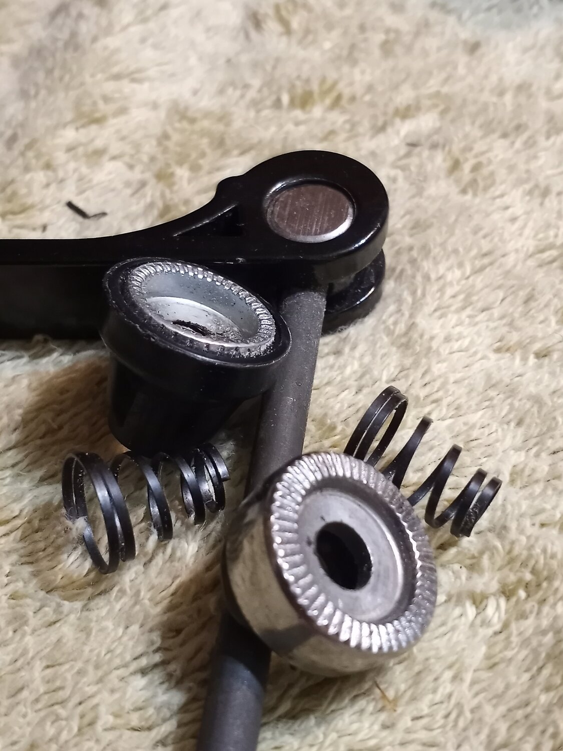

I'm posting some pictures of my QR axle with skewer for reference sake.
My threaded axle is not as wide as the dropout.
I think that you've got the same sort of thing going on with your wheel??
I have no idea why you are supposed to install the races and bearings though?
My wheel came completely assembled, and I just installed it in the dropouts and tightened up the skewer.
Did you take your wheel apart and remove the races and bearings?

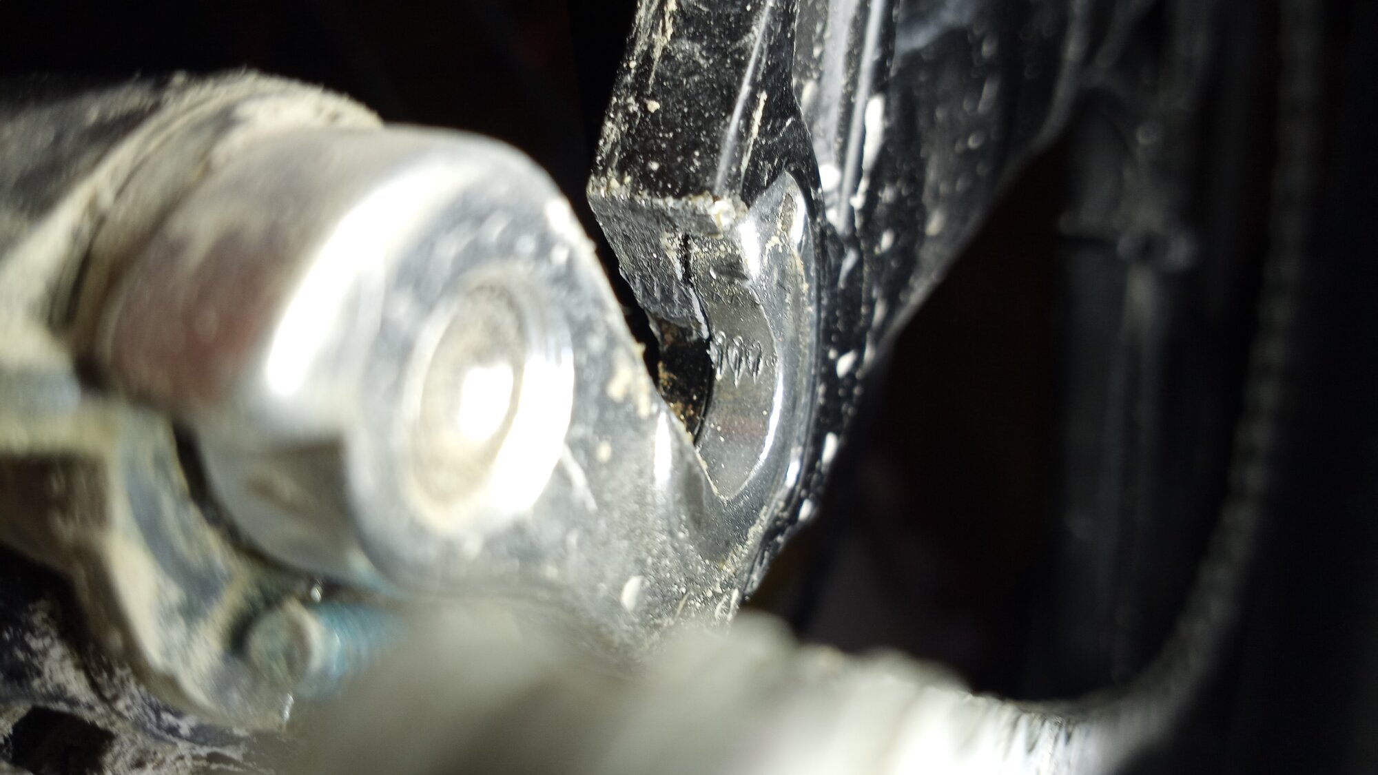

PS,..
I don't like it either.

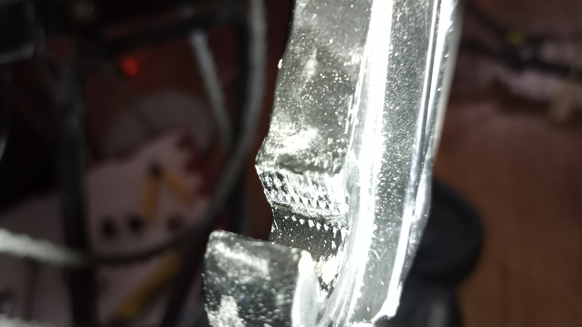

It's a piss poor design that should have been updated (lengthened) to fit the thicker aluminum forks That ALL New E-bikes have !!
There really should be a standard axle installed on aluminum forks that is about 4mm longer...
If the axle sticks out a smidgen past the drop-out, it fits inside the cupped QR nut and would still allow for a proper squeeze of the QR without it pinching the axle ends.
  • Love
Reactions: MTO
Your right.
It's made for steel forks that are half as thick.
I see no reason why a longer axle isn't Standard Issue with an aluminum fork?
Aluminum is a lot softer than steel, and the axle chews it up really good,..

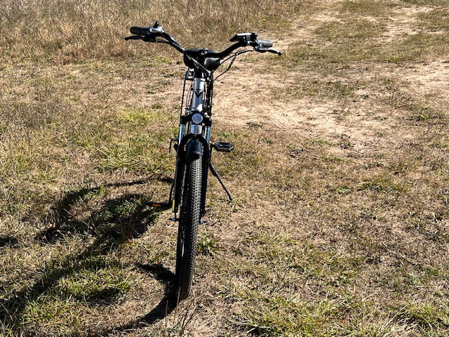

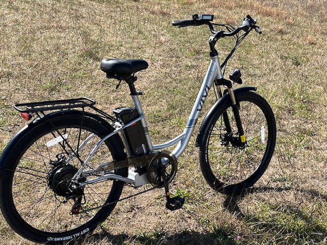

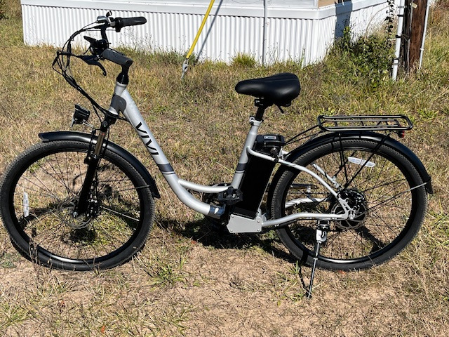

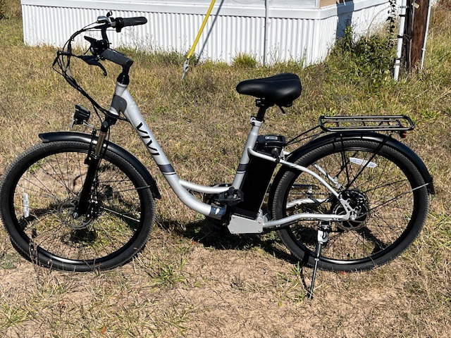

Took her out for her maiden voyage. You get what you pay for... The brakes are horrible, at least 15 ft stopping distance at even low speeds. The top pedal assist will go up to 20 mph as will cruise, but you can feel the limiter fighting with hub motor the second you go over 20 mph on cruise mode, so for now, just using top pedal assist which will go up to 22mph without cutting out. I have serious doubts about range on battery using any pedal assist except mode 1 or 2. I rode her about 9 miles/14 km in mostly the high assist and cruise modes and drained the battery half way. As I get stronger, I should be able to use the lower modes more often. Even assist level 4 is enough to make climbing tall steep hills a breeze in top gear. All in all, I'm thrilled! Here she is, the "Betty 2":
View attachment 184467View attachment 184468View attachment 184469
The only two things to mine I did was change out the weak brakes for dual piston mechanicals and did a settings hack that did away with the speed limiter. The fastest I can get it going is 29 mph with the throttle. I also mounted a spare battery so range isn’t an issue.
To be honest, I bought this ebike simply to get exercise. So, I'm happy with it and probably won't get too crazy with modding. An extra battery to carry along is definitely in my future.
