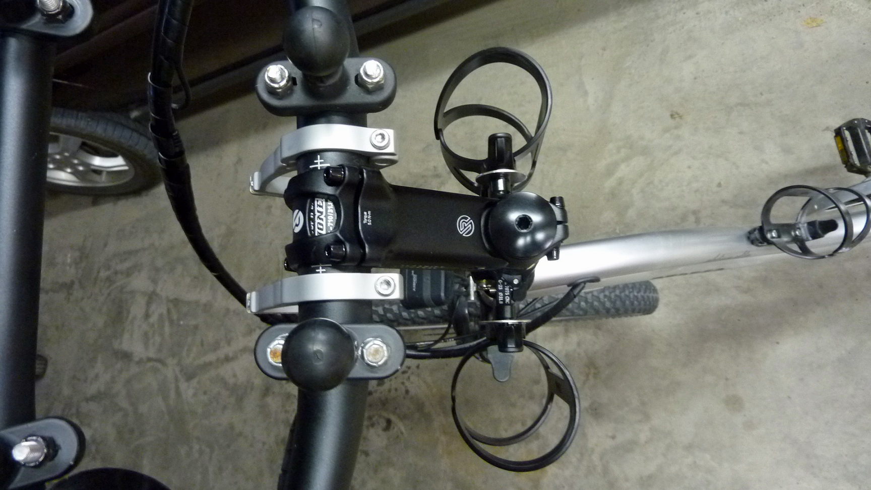

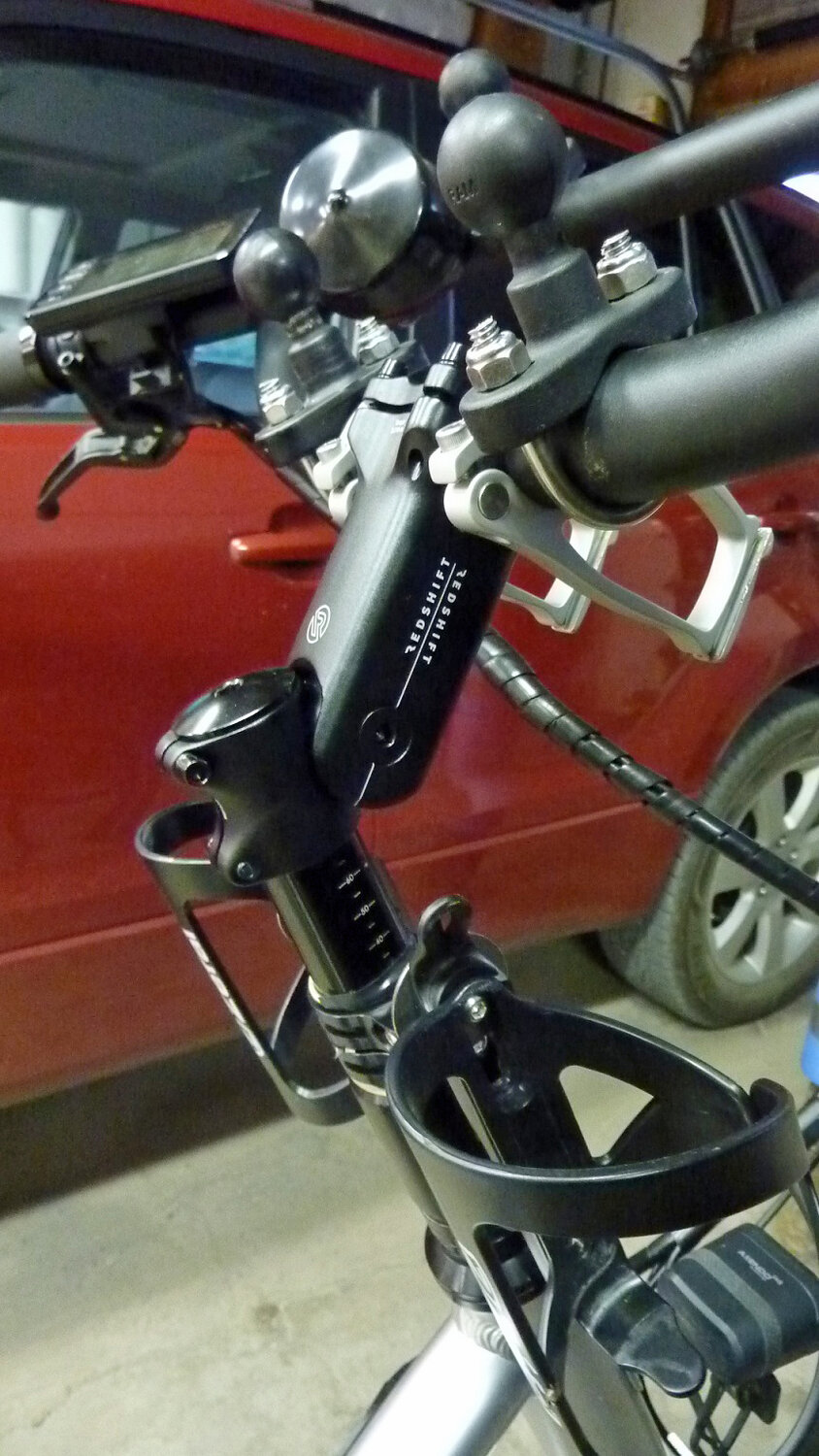

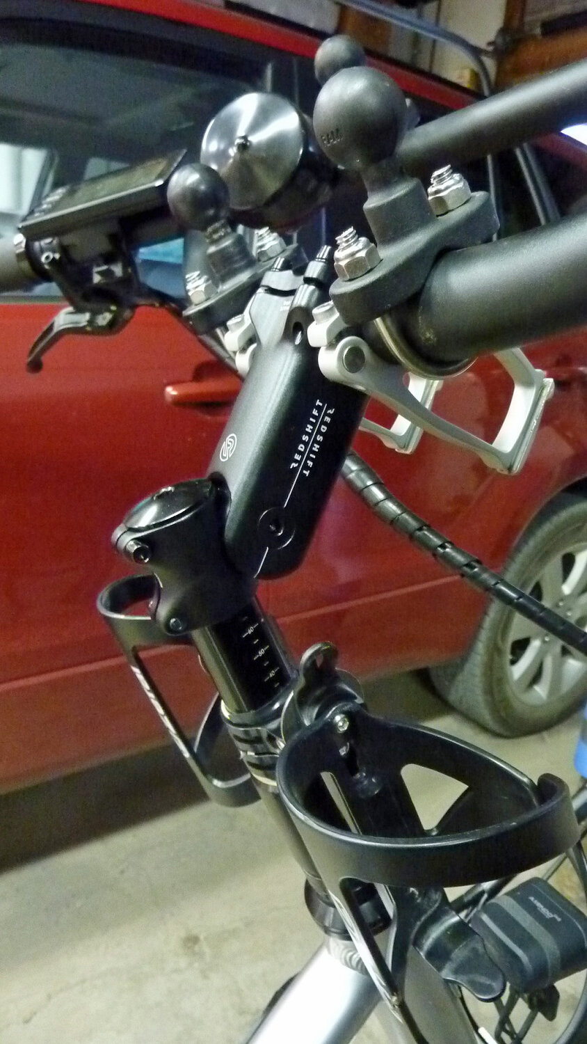

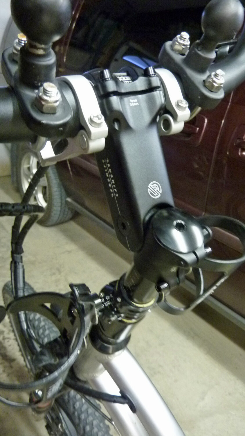

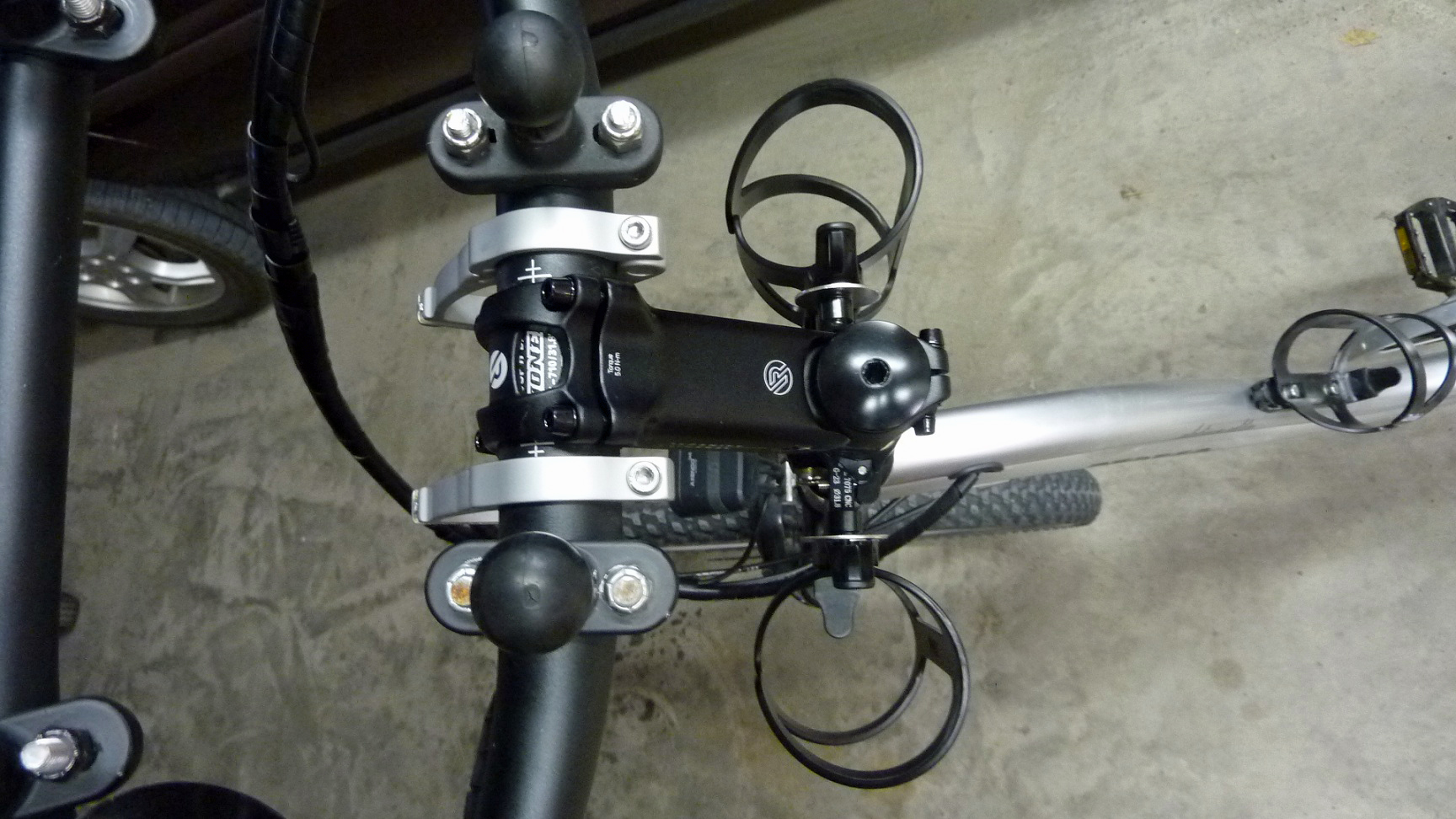

Thanks for the review... any photos? 🙂
Not very clear with all I have bolted to the bars and stem:
The Stem is designed to take downward force from drop or flat bars. The force is more angular with swept back bars but there is still some benefit.
View attachment 62535 View attachment 62536 View attachment 62537
Wow, that's high! Is that an uncut steerer tube or some sort of extension? Why do you need your bars up so high like that? Personal preference or are you like 7 feet tall?
I'm 6' 2" but I have to use a noseless saddle. It's a 6" riser bolted to the top of the steerer tube. I'm most comfortable in the butt and wrists with the bars that high.
Ah ok, that makes sense. I just saw all of that length and wasn't sure why the bars were so high. I'm sure that makes it much more like a comfort or step-thru style bike 👍
