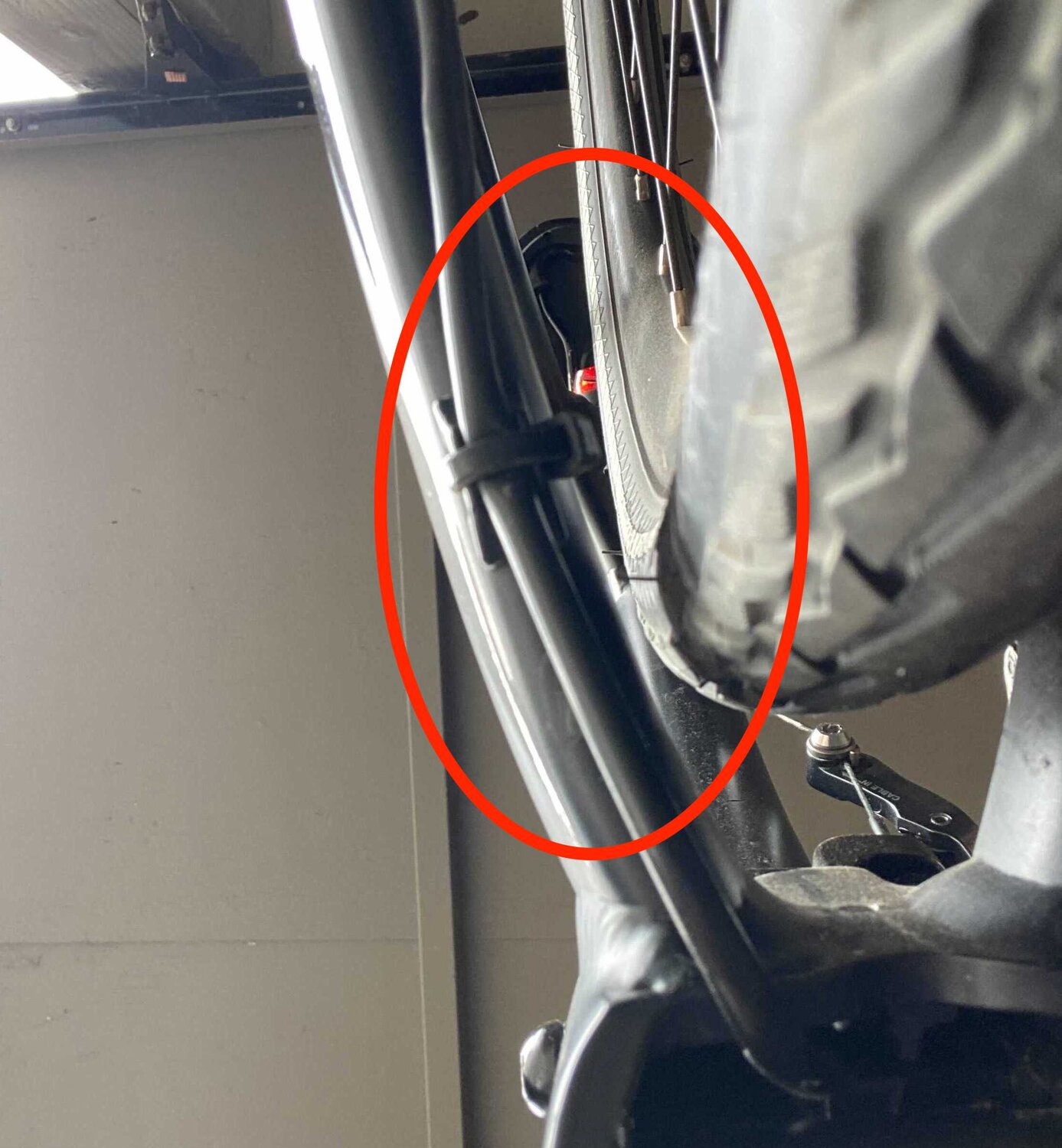

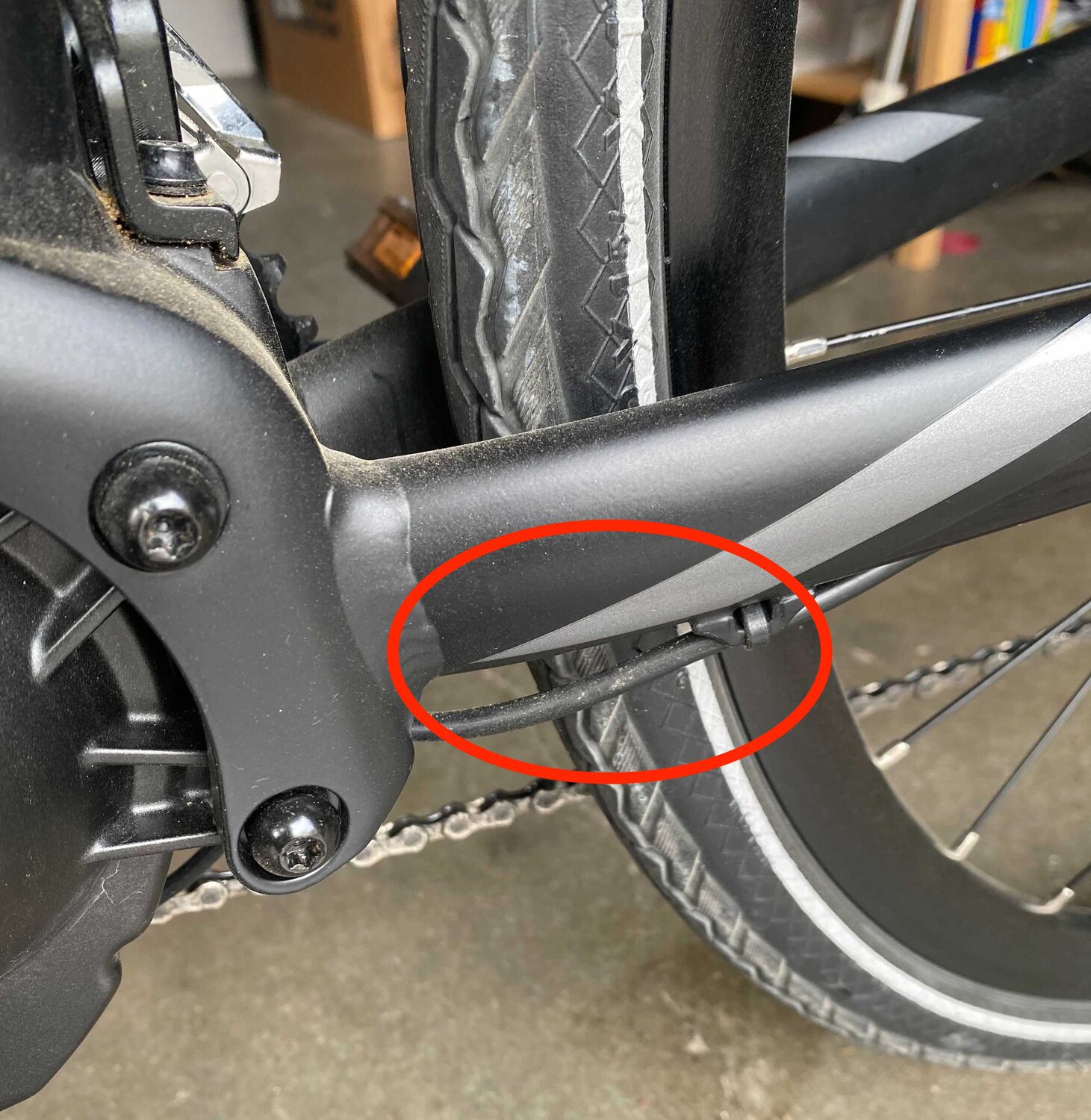

have my first malfunction at 7636 miles, error was speed senso and it killed power assist. Sucked being 26 miles into a 41 mile ride and it stops power assist
That is a bummer. I suppose one nice thing about Yamaha vs a random bike off the internet is at least there is dealer/repair network like many major brands. I hope they fix it for you soon.

Anything we can do to avoid that happening?
Assuming it's the rear wire to the speed sensor that travels underneath the non drive side chain stay. If that's the case, a visual inspection can reveal any potential problems. Make sure it's zipped tied in a position that avoids tire rub in the area near the motor mount, that's where rub would occur.

Thank you, I like to know these things so I can avoid warranty issues if possible.
You're welcome!
As a motorcycle rider and cyclist, I can say that the e-bikes that I've seen at motorcycle dealer are not as well assembled compared to a bike from a traditional bike shop. If your Yamaha was bought at motorcycle dealer, double check your bike for small things like this zipped tied wire.
