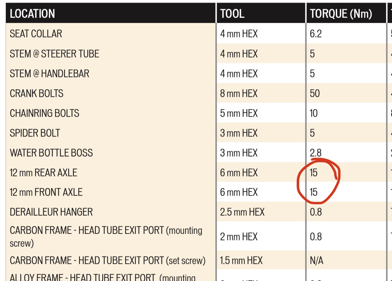

15NM is 11 pounds at a distance of one foot, or around 65 pounds at the end of the little lever arm. should not require a hammer!

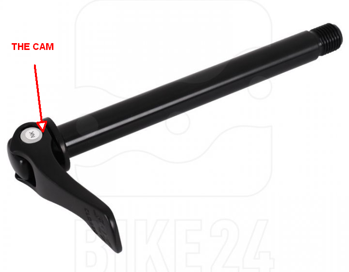

Mark, the typical 100-dollar quick-release thru-axle works on the principle you do a very few rotations until the axle lever gets to it's final position, and then you do the tightening movement by turning the lever 180 degrees. There is a small cam in the lever, and that cam does all the squeezing work! Not the rotation! And that's why a good quick-release thru-axle is expensive!

the torque spec is 15NM. not a rule of thumb, a specification ;) if you have a small torque wrench with a similar length handle to the axle (or just hold it in the same place) you could set it to 15NM and torque down a few bolts to get a feel for it.

It works very well with the cam. The lever is always turned to the same position (it cannot be done otherwise), and you always lock the lever in the same position. For 11,500 km ridden on the Trance, there was not a single rotor misalignment situation. The axles for the Trance come from FOX, which is the name in the industry. The thru-axle with the lever is in fact a precision mechanism.

P.S. It is very important to mention the virtue of the thru-axle is not the axle itself but how the hub bearings "sit" in the fork/frame. The squeezing the fork by the axle is only the secondary thing (so the wheel wouldn't wobble). I managed to ride for 20 km with the axle just tightened with my fingers on my Vado SL before I realized what I did.
The torque spec only refers to traditional thru-axles. It is the squeezing force of the axle that keeps the wheel in the position, and it is irrelevant how that force was achieved.

The sole function of the thru-axle is to squeeze two opposing elements of the frameset with given force as the hub bearings (which reside in precisely made insets in the fork/rear triangle of the frame) are secured against wobbling.
The squeezing force can be achieved by:
  • Turning the axle with a hex wrench to given torque specification, OR
  • Engaging the Quick Release lever, which is equipped with a cam that does the work.
The thru-axle does not do any other action, and it does not act as a real wheel axle.
@mschwett seems to have misunderstood the concept and got fixated on the "torque". Indeed, if you try to torque the axle with the QR lever, it is not correct. The QR lever is to be engaged.
That's it.
That's it.
A FOX QR thru-axle is twice as expensive as a traditional one.

to the original point, 15NM is absolutely the torque spec, regardless of the shape of the handle/head for these passive non-cam through axles. personally i think the lever head should also have a 6mm socket so it can be torqued correctly when at home or in the shop, but still removed easily if one finds that of value. i’m sure there’s a reason they’re not like that, but i have no idea what it is ;)

Did you watch the video guys? The guy is specifically showing a thru-axle with a simple lever. See how good it works for him and he is not concerned with the 15 Nm spec at all. And he is specifically naming the use of the thru-axle on a road bike. Only much of torque is needed as to squeeze the fork/frame to secure the hub in the insets ("drop-outs"). And as much as the bolt does not unscrew itself while riding.
MTBs use the cam-based QR thru-axles because it is very fast to secure the wheel, and it is much precise. Far greater forces act on an MTB than on a road bike!
