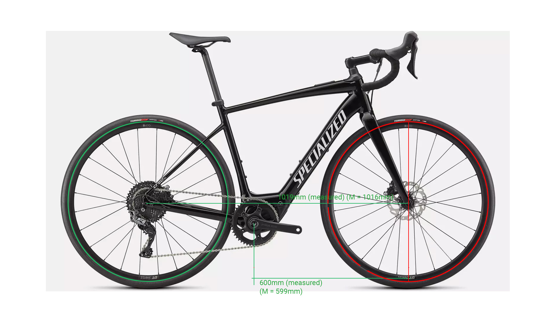

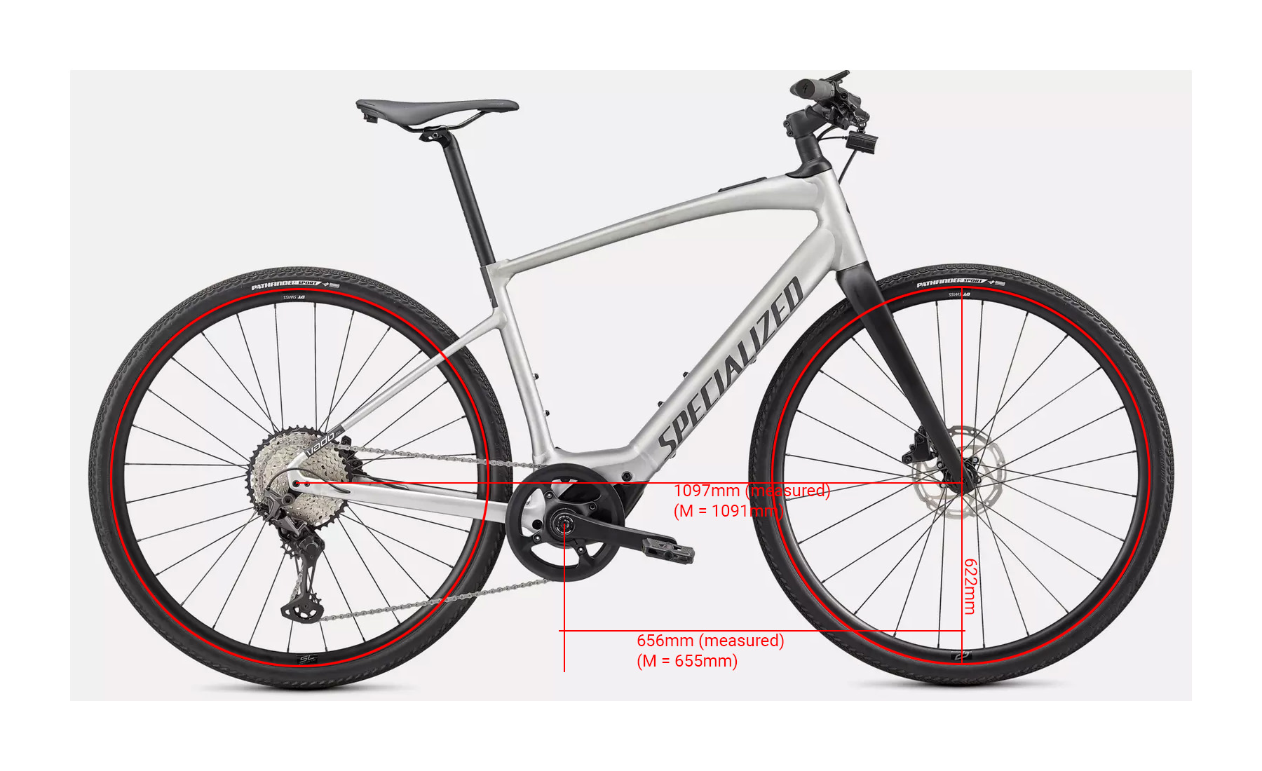

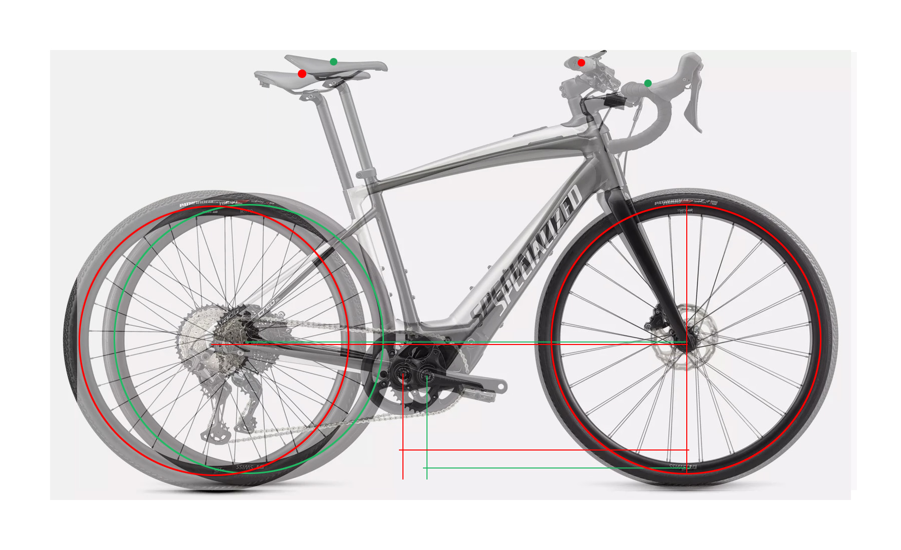

it is interesting how much the geometry of the frame varies for the two bikes. not surprising i suppose since they have different intended purposes, but remember that in many ways they're very similar. same motor, same battery, same wheels, 1x drivetrains, same frame material and basic configuration.
the photos (or renderings?) on the specialized site are quite undistorted, and a quick overlay in photoshop confirms that both are taken/rendered of a size medium bike. measured dimensions are within a half a percent of the predicted values, based on the known 622mm outer diameter of the wheels.
the vado is much longer, and the riding position relative to the front tire is much further back. of course stems and seats can be adjusted to reduce this difference, but fundamentally the frame is balanced around a different riding position. overlaid together, we see that every element of the frame is slightly different, most notably the distance from the crank to the front axle, which then triggers or is caused by different angles of the top and downtube, head tube, etc. it all makes sense given the nature of drop bars and flat bars, long road or gravel rides vs multipurpose riding, etc. one could outfit the vado with a zero offset seatpost, slide the seat forward, get a very long stem, and flip it upside down to start to bring the riding position closer to the creo (or vice versa!) but the fundamental handling characteristics driven by the wheelbase and head tube angles won't be changed by that.
this is really cool I see that you used the front fork and the wheel axel can you do a comparison picture of the two bikes by lining them up by the seat down tube and motor just to see i knew the measurements do not change appreciated
Creo is lowerd and compact riding position for more of aerodynamics and handling

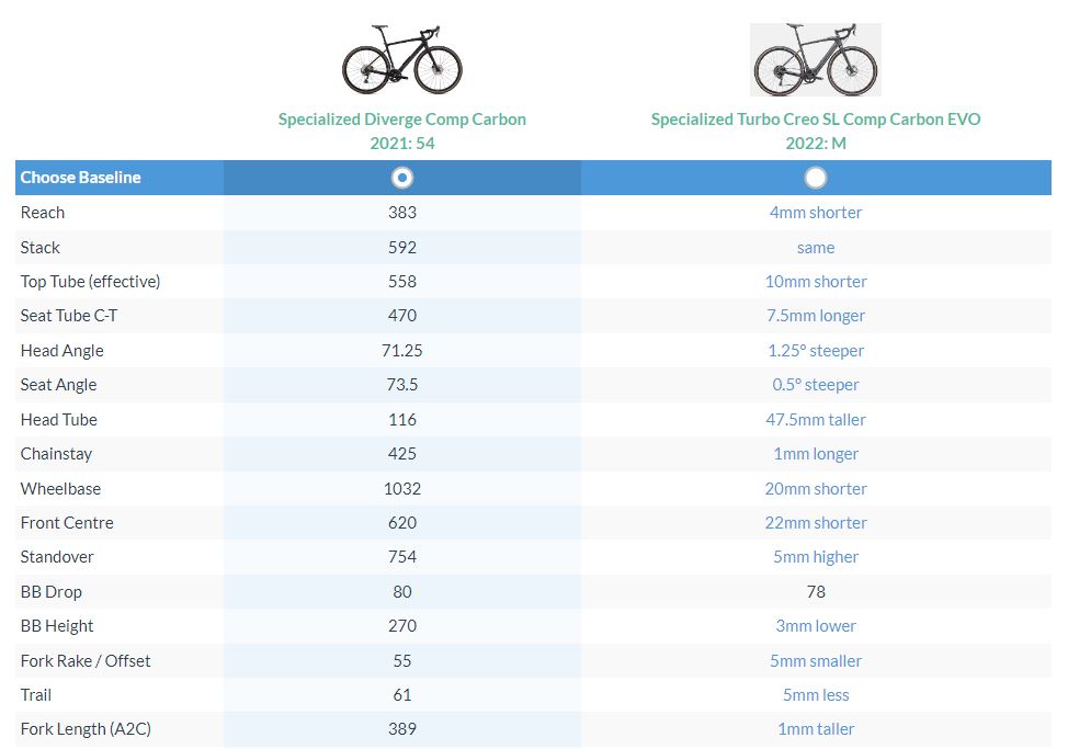

Published geometry is pretty close - 73.5º seat tube angle and 70mm BB drop on the Vado SL for all sizes, and the Creo SL has 74º to 73º seat tube angle and 80.5mm to 75.5mm BB drop depending on size.
So - seat tube angle is nearly the same, and the motor may up to 1cm lower relative to the axles on the Creo vs Vado SL. Seat to BB (motor) distance will depend on seat height which is set to fit the rider. Not sure that's all that much an indicator of being lower enough to matter.
Perhaps the better metric is Stack - ranging from 595mm to 696mm on the Vado SL and 575mm to 675mm on the Creo. Comparing the size medium models, the Vado's 626mm stack will give a more upright seating position than the Creo's 592mm, though this also doesn't account for the significant impact of different stem length/rise nor differences in flatbar sweep/rise vs dropbar hand position on the hoods. The riding positions are sufficiently different that I wouldn't assume the same frame size to give an equivalent comfort level without some additional tweaking. Especially if the rider isn't used to the body
positioning of a drop bar bike.

that doesn't make a lot of sense. when you put the bikes next to each other, were the seat and bars in approximately the same position? the stack (vertical distance from crank to bars) and reach (horizontal distance from crank to bars) on a 54 diverge and M creo are within millimeters of each other. you should easily be able to adjust the seatpost, saddle rails, stem, bars, and hoods to literally have exactly the same relationship on those two bikes. which creo were you riding? one of the carbon ones, i assume? otherwise the comparison to a carbon diverge will bring in a lot of other differences...
the seat tube angle is a scant half a degree different. they're really very similar, with the major difference being the angle of the fork and wheelbase.

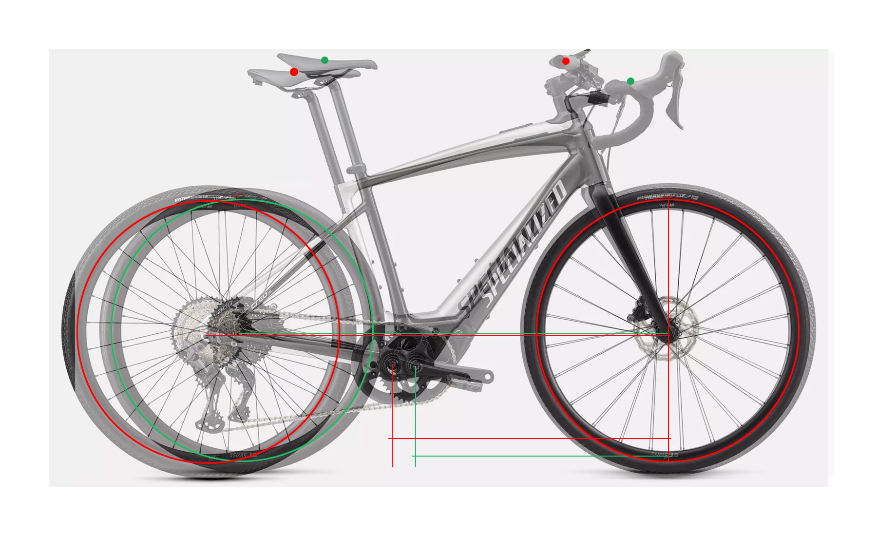

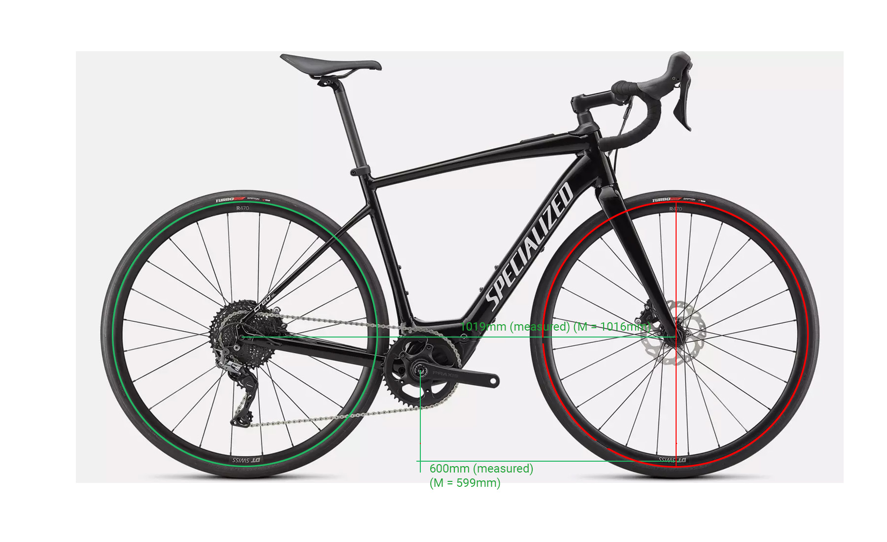

Sorry I did not get back to this sooner. This is a great comparison. I would have used the motor as primary the datum. The rear derailleur mount is the secondary datum. The front front fork as used in days of old is a derived point and can be changed by swapping forks and is not a good datum to use. The same with the handle bar position. This all used to be much easier when you could assume the top tube was horizontal.
