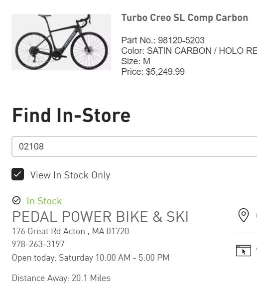

the comp carbon is widely available at shops in the US for $5,250, at least in the L and larger sizes I just looked at. $750 more for the carbon bike is a no brainer for anyone planning on long road rides, IMO, unless a lot of cargo is required!

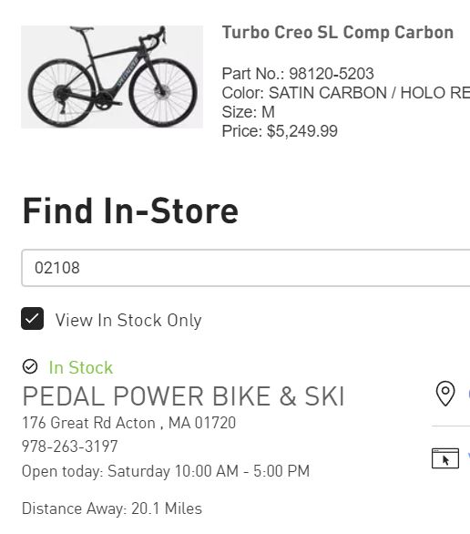

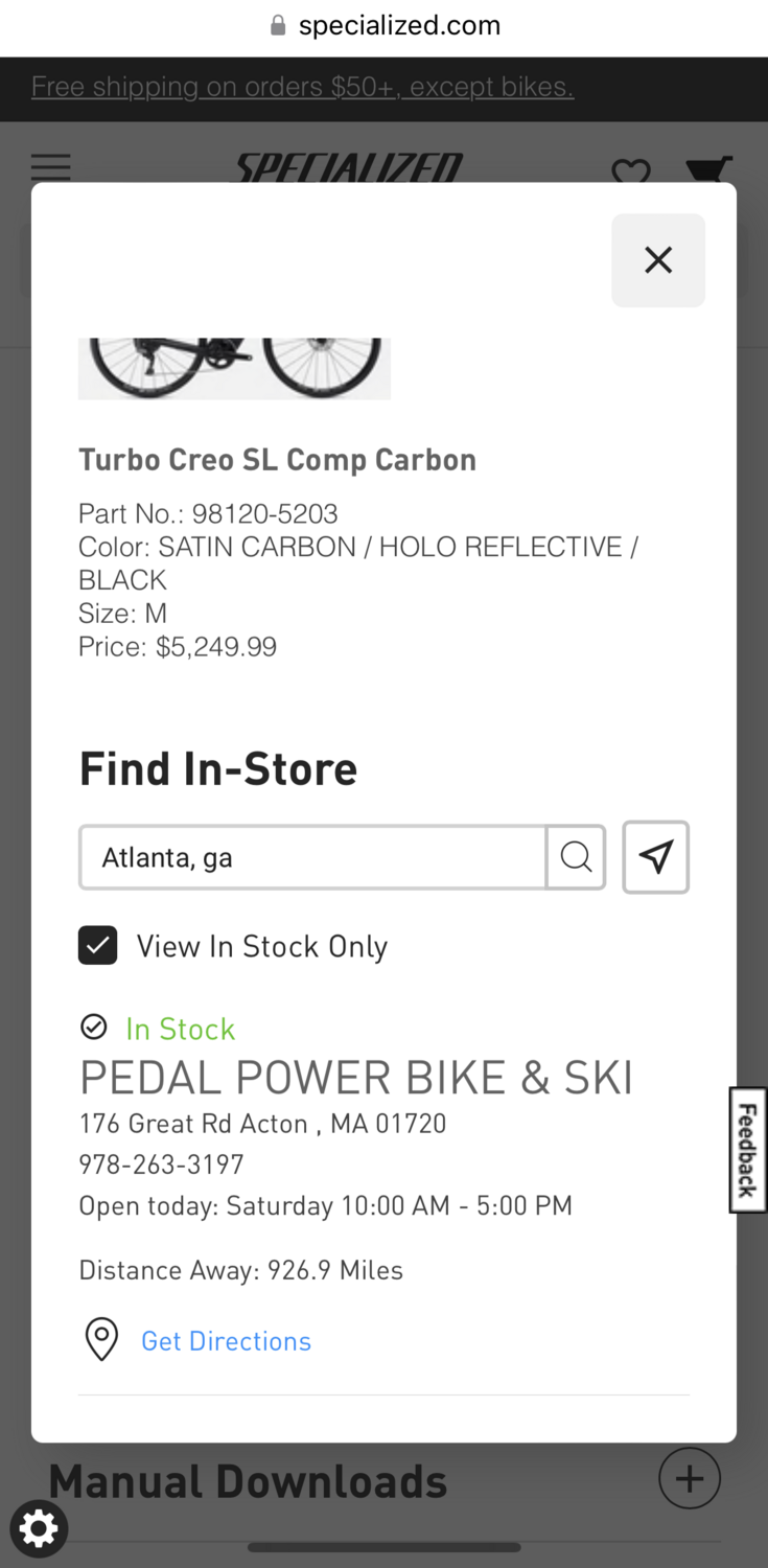

Which shops, please?
Specialized site shows 920 miles away for the nearest medium 2021 Comp Carbon (in Massachusetts). There’s a Large slightly closer in Pennsylvania, only 680 miles away. No Smalls showing as available in store.
Yes, there are closer XLs but buying two sizes too big would be wasted money.
The somewhat more plentiful but still a couple hours distant 2022 models are $6000.

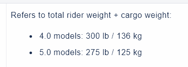

Guys, I read this thread with great interest. You have opened my eyes to many aspects of Creo I was not aware before! For instance, the low structural weight limit of Creos in general, or issues to install the rack in particular. Currently, I weigh 96 kg (around 212 lbs). Even because of that alone the Creo is not for me!
Now, it made me thinking... what is the structural weight limit of Vado SL? Anyone?
P.S. And think I could have bought the SL 5.0... For me, a heavy rider and my cargo!

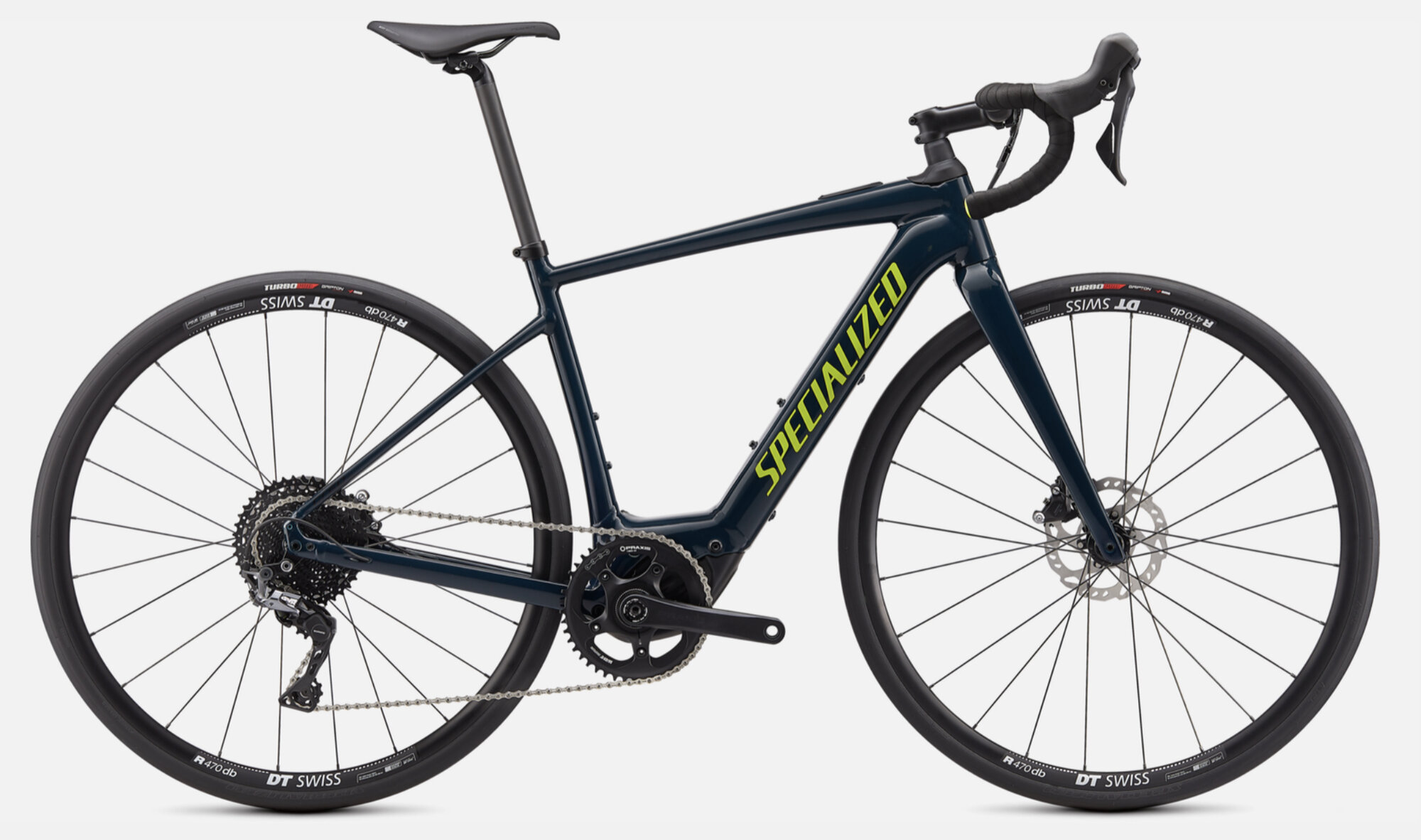

it’s definitely not the same frame. the creo carbon and e5 share the same geometry, which is different geometry by quite a bit from the Vado SL, which was designed for flat bars and a more upright riding position. there are many differences, readily apparent even just by looking at them.

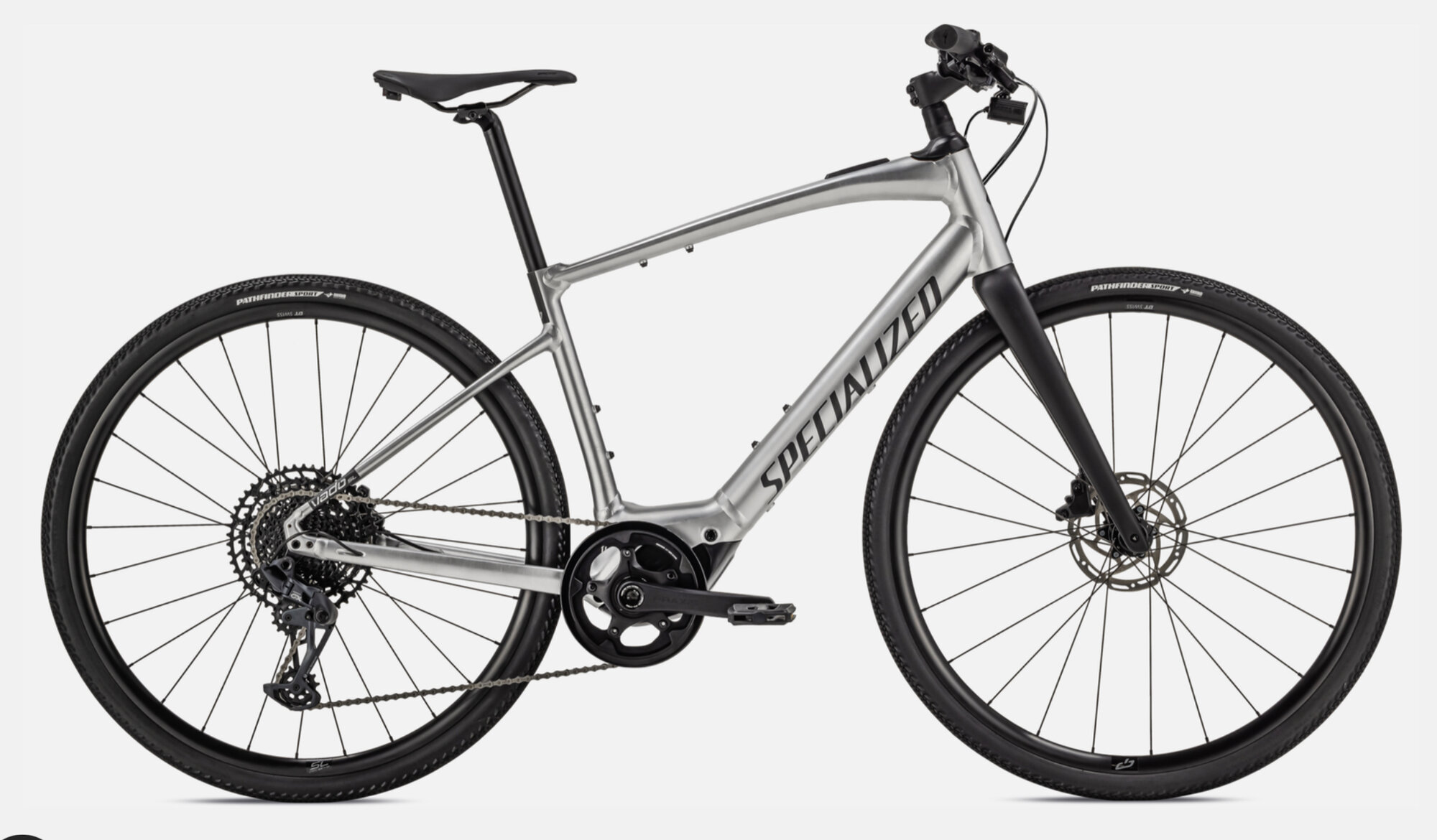

The Vado SL has a much longer, more stable geometry. Which makes it great for trail and forestry road type riding. In fact the wheelbase and slacker head angle & long chain stays are similiar to traditional (older hard tail/rigid) MTBs. Or something like the Surly Ghost Grappler an MTB inspired drop bar, gravel or monster cross bike:

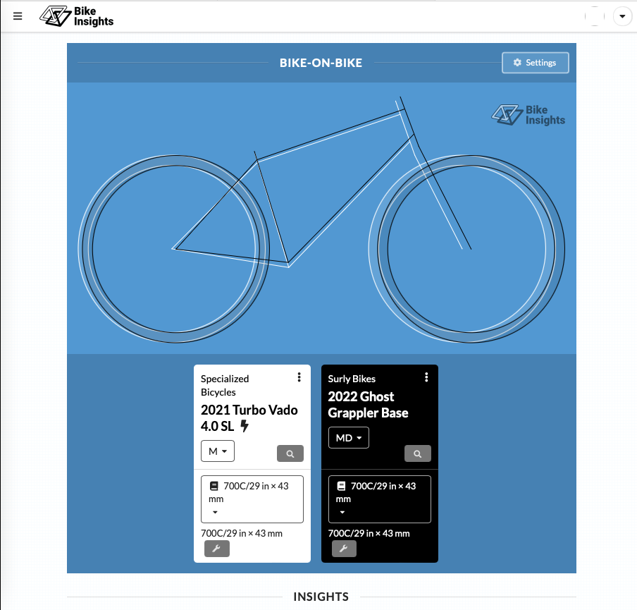

Vado SL and Ghost Grappler:

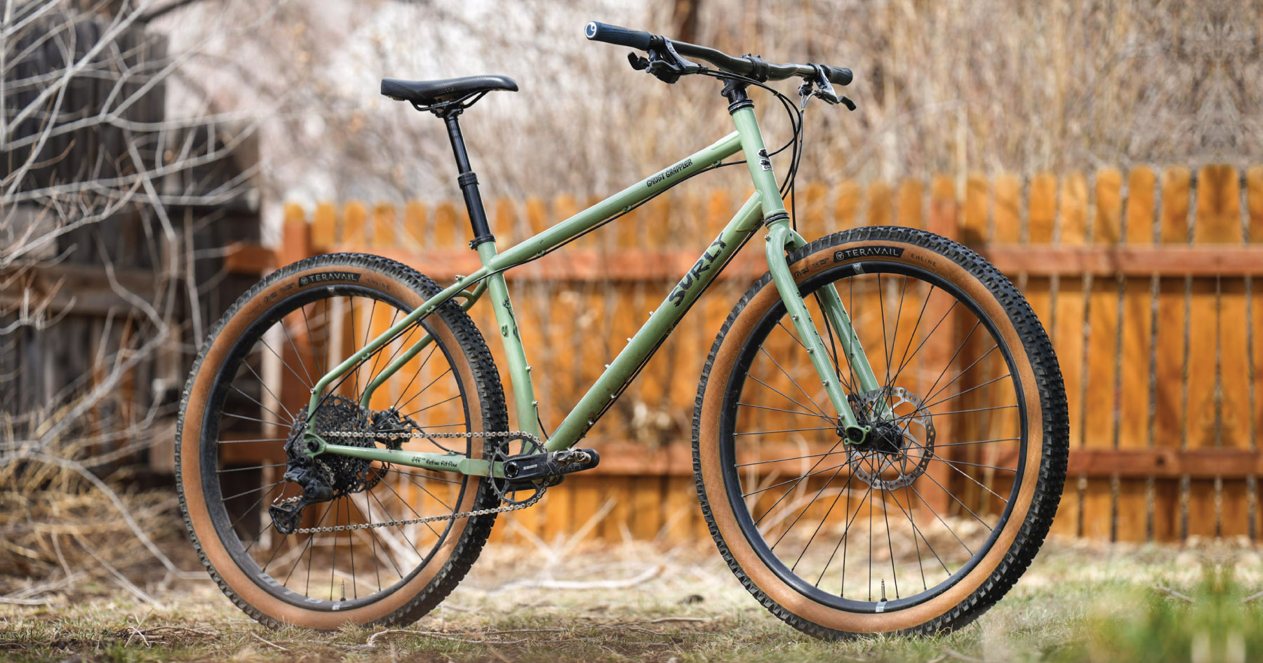

Ghost Grappler with flat bars. It has of course much wider clearance for fat tyres than the Vado SL:

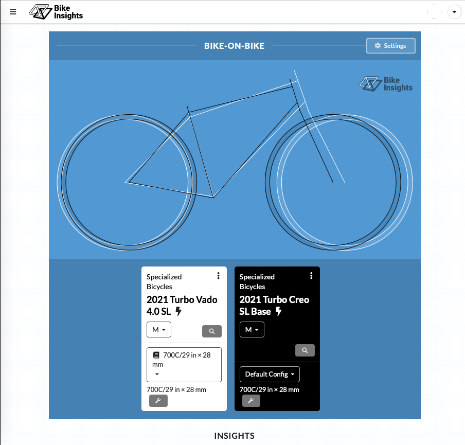

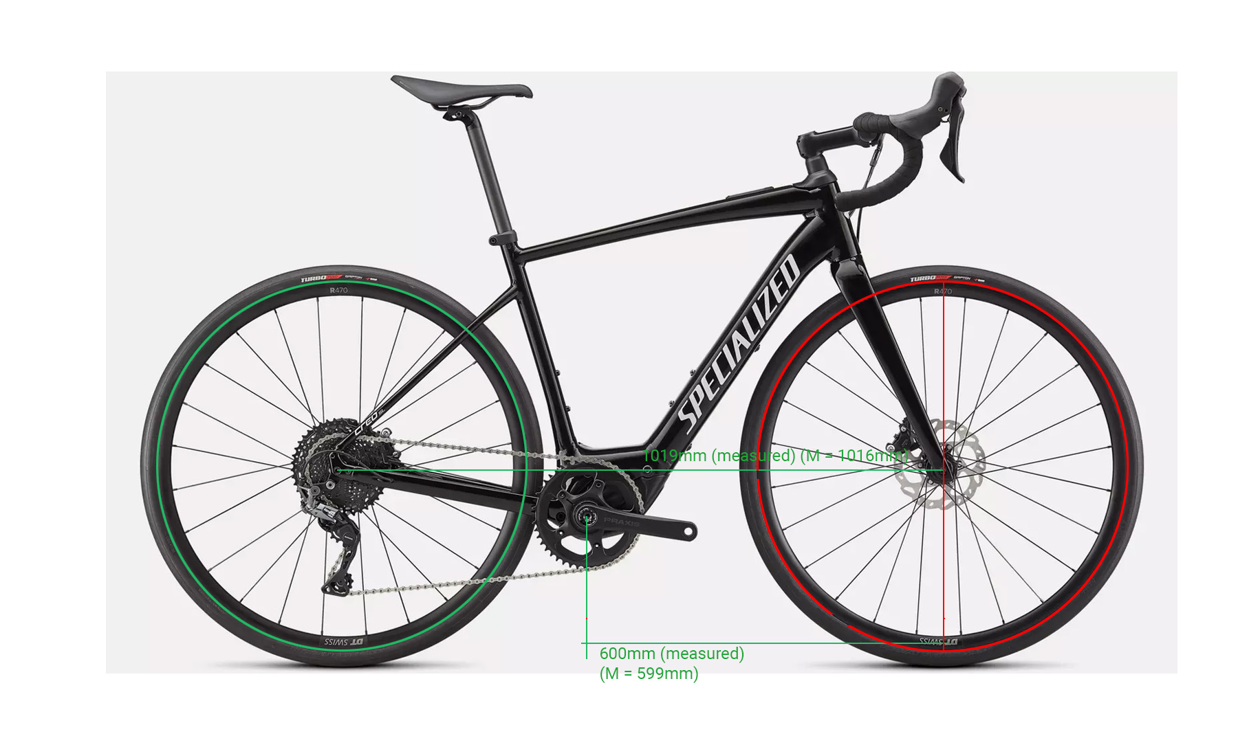

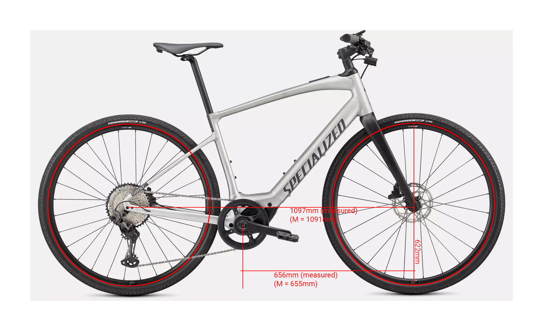

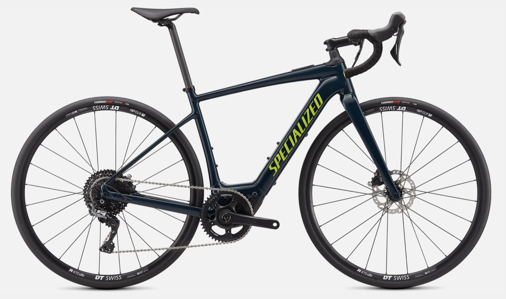

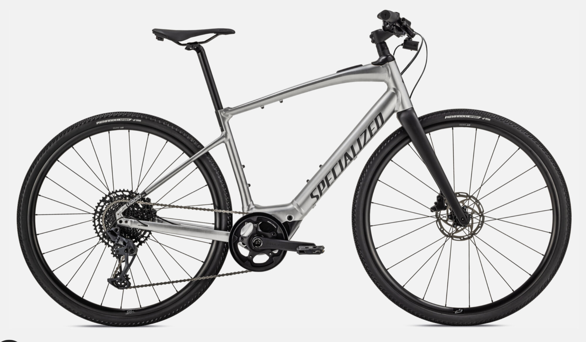

Vado SL V Creo, you can see immediately the Creo is shorter:
i show one in acton, medium, black. they do not seem hard to find, but i'm sure in some parts of the country the nearest is a few hundred miles.
Turns out that is the one closest to me too.
Rather a bit further from Atlanta though…
… and may be the only one east of the Mississippi…

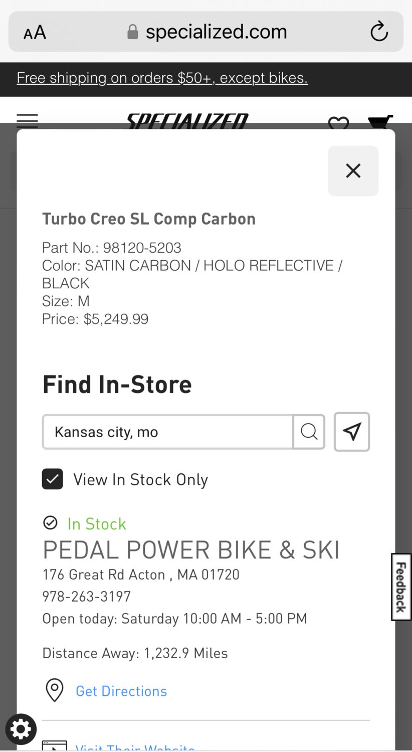

ah lol, i interpreted your post that you were IN massachussetts! medium definitely harder to find - one in cali, a couple in the midwest, one in boston. not unreasonably far if it's the one you really want, i suppose!
ah, yes, that explains it then.
distance unfortunately adds cost - time/fuel to go get it or cost to get shop to ship to a local store for them to build and deliver. Eats up a lot of the $750 delta to a 2022 comp carbon when there’s couple within a two hour drive.

I agree they are not exactly the same frame but Specialized and most manufactures do not post enough data to accurately draw the two frames. The Vado SL looks like a value engineered E5 Version 2 with some simplifications near the head tube to reduce the manufacturing cost for the larger parts batch run and lower price point of the Vado SL. The data tables on their model geometry pages shows mostly derived dimensions and they can be changed by different fork size and fork headset spacers or seat posts. I would not be able to say the geometry of the bare frame is significantly different. We don't even know if the two frames in the photos are nominally the same size. They do say on the support site the chainstay of the E5 is longer than the FACT 11r carbon frame along with kick stand and fender mounts. Why would a Creo have a kick stand or was it orignally designed to be used on the Vado SL but came out too expensive? The parts list on the support site even shows some parts shared between models for example S192300032 FRK MY20 CREO SL (SIZE LG) & VADO SL 5.0 (SIZE SM) STN CARBON.
I really like the Bike Insights web site but we don't know if the submitters to the database used a frame carefully measured on a table or if they just drew it from published marketing data.

not sure what you’re getting at here… no doubt there are many similarities. they’re both aluminum e bike frames made by specialized.
but one is for a drop bar road bike, the other for a flat bar hybrid/fitness bike. the geometry is substantially different due to the bars. i am sure they are of similar quality and share manufacturing processes.

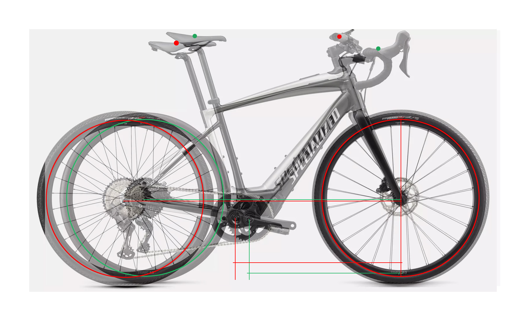

it is interesting how much the geometry of the frame varies for the two bikes. not surprising i suppose since they have different intended purposes, but remember that in many ways they're very similar. same motor, same battery, same wheels, 1x drivetrains, same frame material and basic configuration.
the photos (or renderings?) on the specialized site are quite undistorted, and a quick overlay in photoshop confirms that both are taken/rendered of a size medium bike. measured dimensions are within a half a percent of the predicted values, based on the known 622mm outer diameter of the wheels.
the vado is much longer, and the riding position relative to the front tire is much further back. of course stems and seats can be adjusted to reduce this difference, but fundamentally the frame is balanced around a different riding position. overlaid together, we see that every element of the frame is slightly different, most notably the distance from the crank to the front axle, which then triggers or is caused by different angles of the top and downtube, head tube, etc. it all makes sense given the nature of drop bars and flat bars, long road or gravel rides vs multipurpose riding, etc. one could outfit the vado with a zero offset seatpost, slide the seat forward, get a very long stem, and flip it upside down to start to bring the riding position closer to the creo (or vice versa!) but the fundamental handling characteristics driven by the wheelbase and head tube angles won't be changed by that.

Does your overlay picture prove the Creo has a longer reach than the Vado SL? Or, am I wrong?
yes, quite a bit. to get lower you have to reach further, assuming your elbows are in line with your shoulders and not sticking out like big air brakes :)
