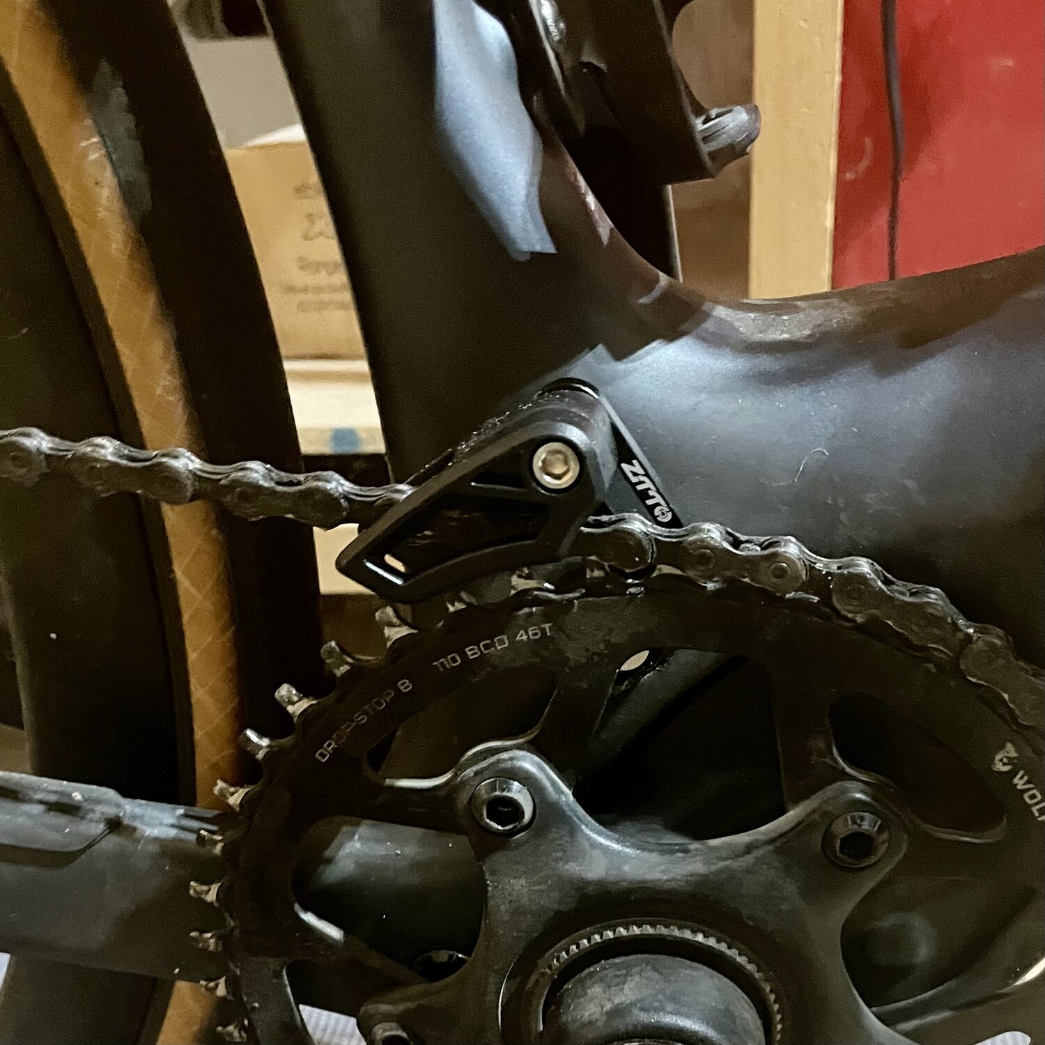

Don't think he's ridden the Garbaruk yet, and the drops occurred with the Praxis.
I also noticed a slight outward shift in the chain line with my Wolftooth - I think the original Praxis is slightly dished while the replacement chainrings are flat.
Yep. Haven’t ridden the Garbaruk yet.
The Praxis is dished as you say. I’m still looking into getting some shims to adjust the Garbaruk line. In the meantime I’ve ordered a new chain - just in case..;-)

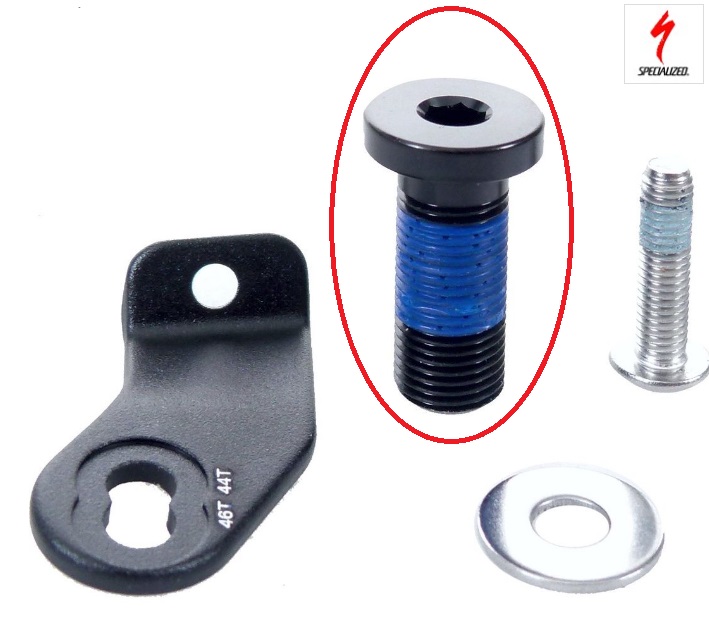

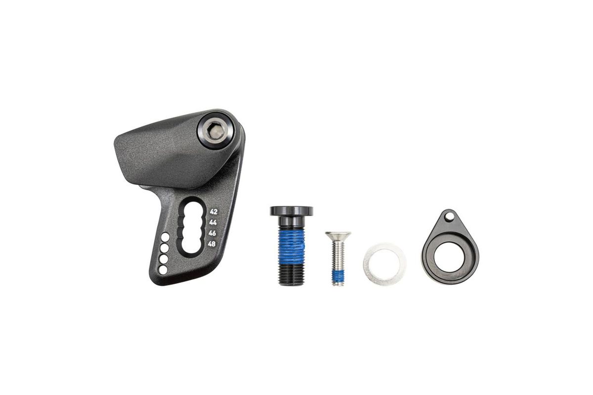

Guys, can we buy this kind of bolt? (Lost mine)
Bolt that have female thread inside.
Google binary bolt female thread inside.
Include thread pitch in your description.

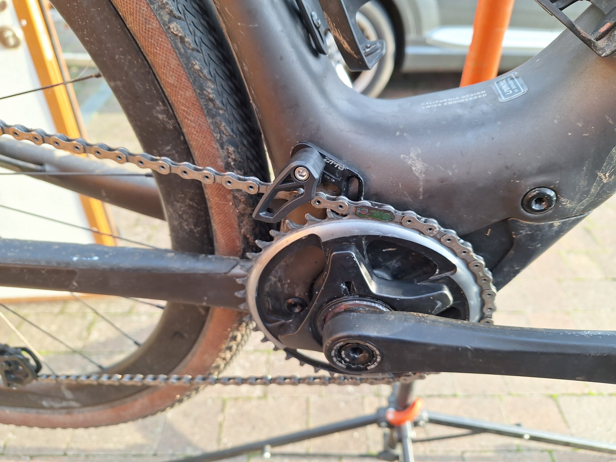

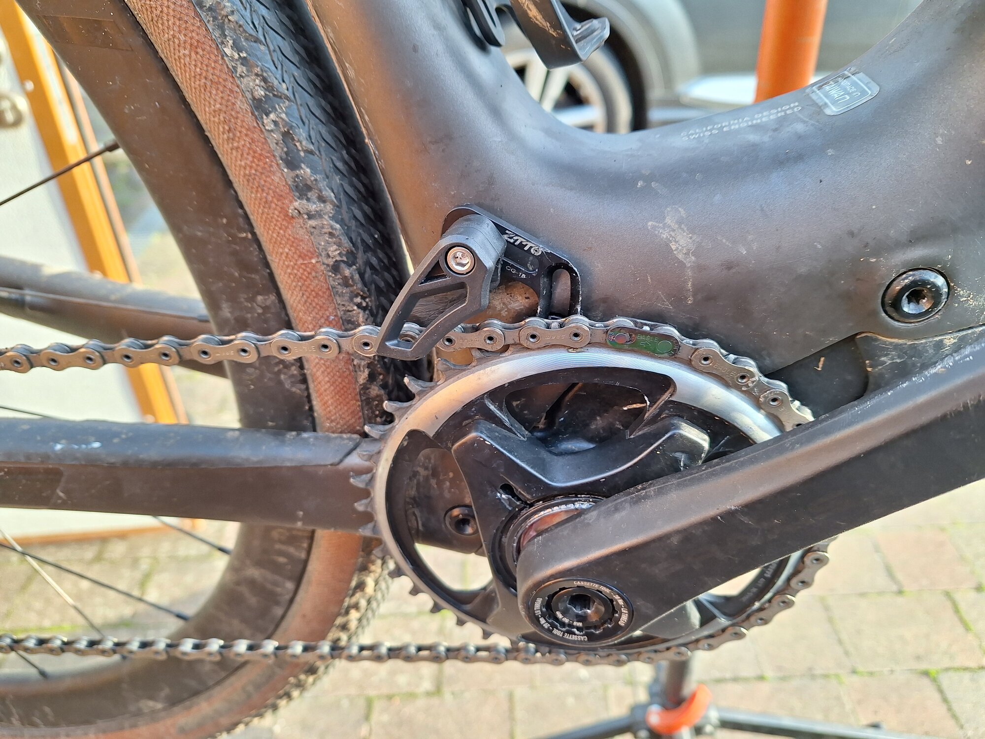

I know this is somewhat reviving an old thread, but I bought this chainguard from aliexpress

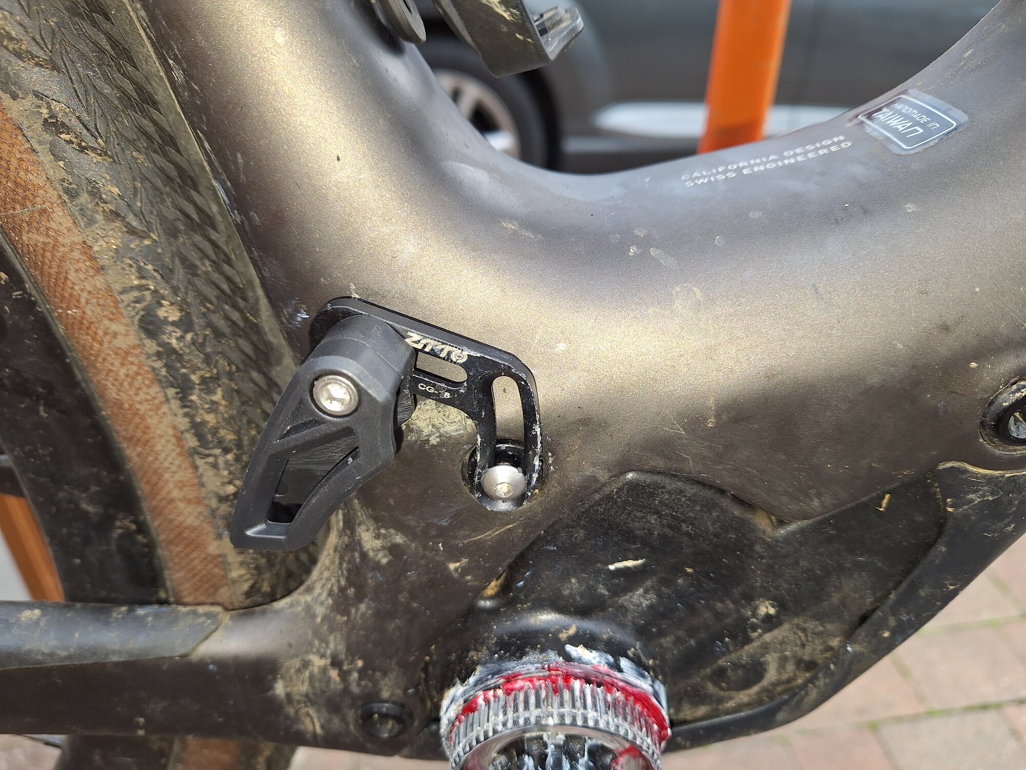

it is an almost perfect fit for the Creo V1. It projects slightly too far out away from the bike (1 or 2mm) such that the chain will catch when in the biggest rear cog, , but the aluminium of the bracket is soft enough to bend by hand with pliers or a vice, and the guide itself is soft plastic, easy to shave 1 mm off the inside face. An hour of tweaking and it works. I'm running a 40T.
smallest rear cog:
largest rear cog
without chainring:

cost me £3, but still, its super-cheap. Buy 2, in case you break it whilst doing the bending - I wasn't sure if I might, so I got 2!
FYI I used the same bolt as on the original guide, I should probably replace it with a countersunk head to get better fit on the face of the new mount.
