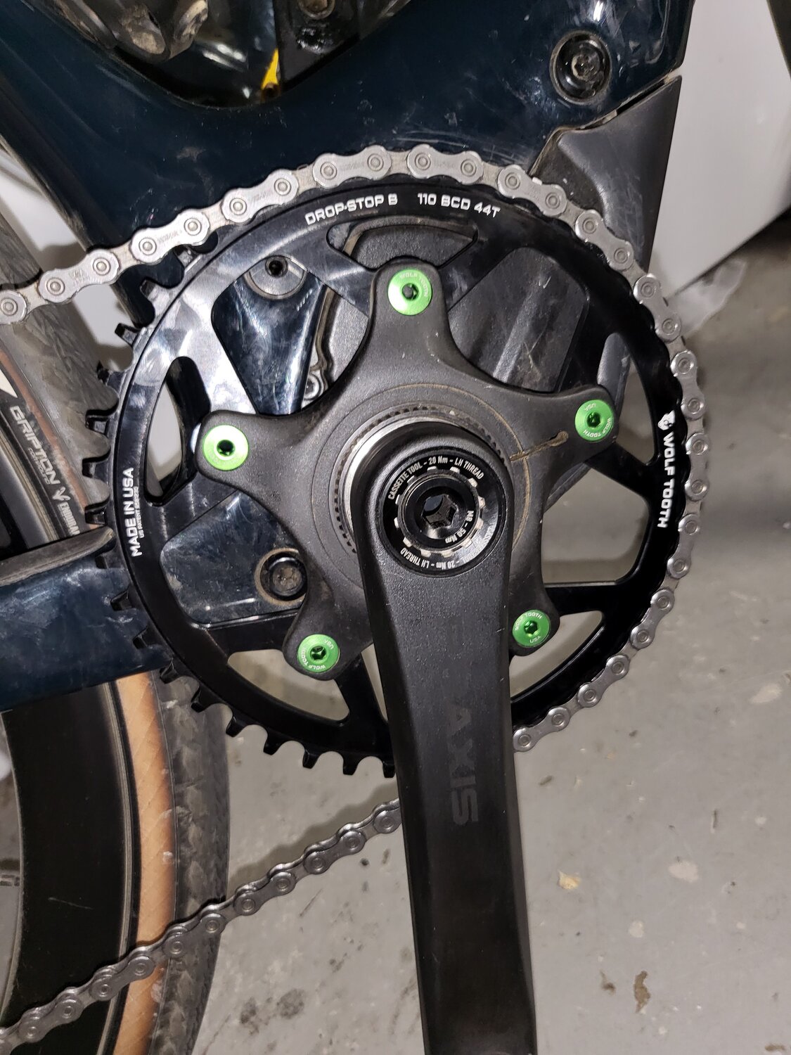

Ok, here is my newly installed chain ring with green bolts. It was pretty easy to do. Appreciate everyone's help!!

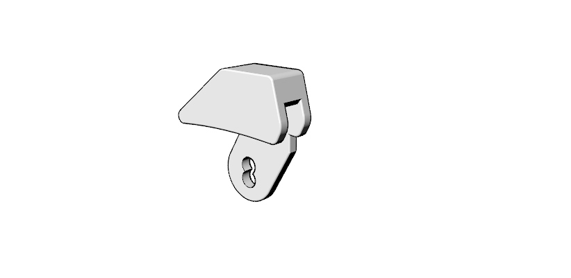

Hello everyone, i have same problem on creo chain drop. I work on a real chain guide next time. Printed in 3d with laser in nylon. I will see
regards🤞

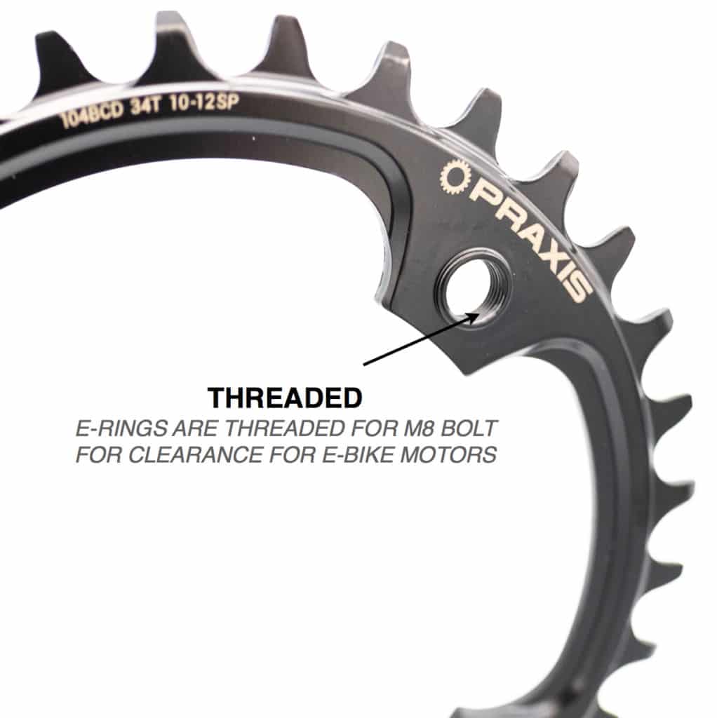

Hi, I'm interested in how you have mount the garbaruk chainring, i is without integreted threads?

The Garbaruk chainring fits the standard spider and is a very quick change. Super impressed with their quality. You need 110BCD 5 arm narrow wide. Comes in lots of colours to

Ok thanks for info to change to a smaller chainring. But i don`t understund how fix you them without thread? You use another screw and nut?
I draw a first chain guide for creo. Next step print it with a fast resin printer.
Sorry, yea standard 2 piece chainring bolts doe the job, The front threads into the rear
You just buy a set of five chainring bolts with nuts. I really recommend buying steel bolts (as opposite to aluminium ones). The tightening torque is 5 Nm.

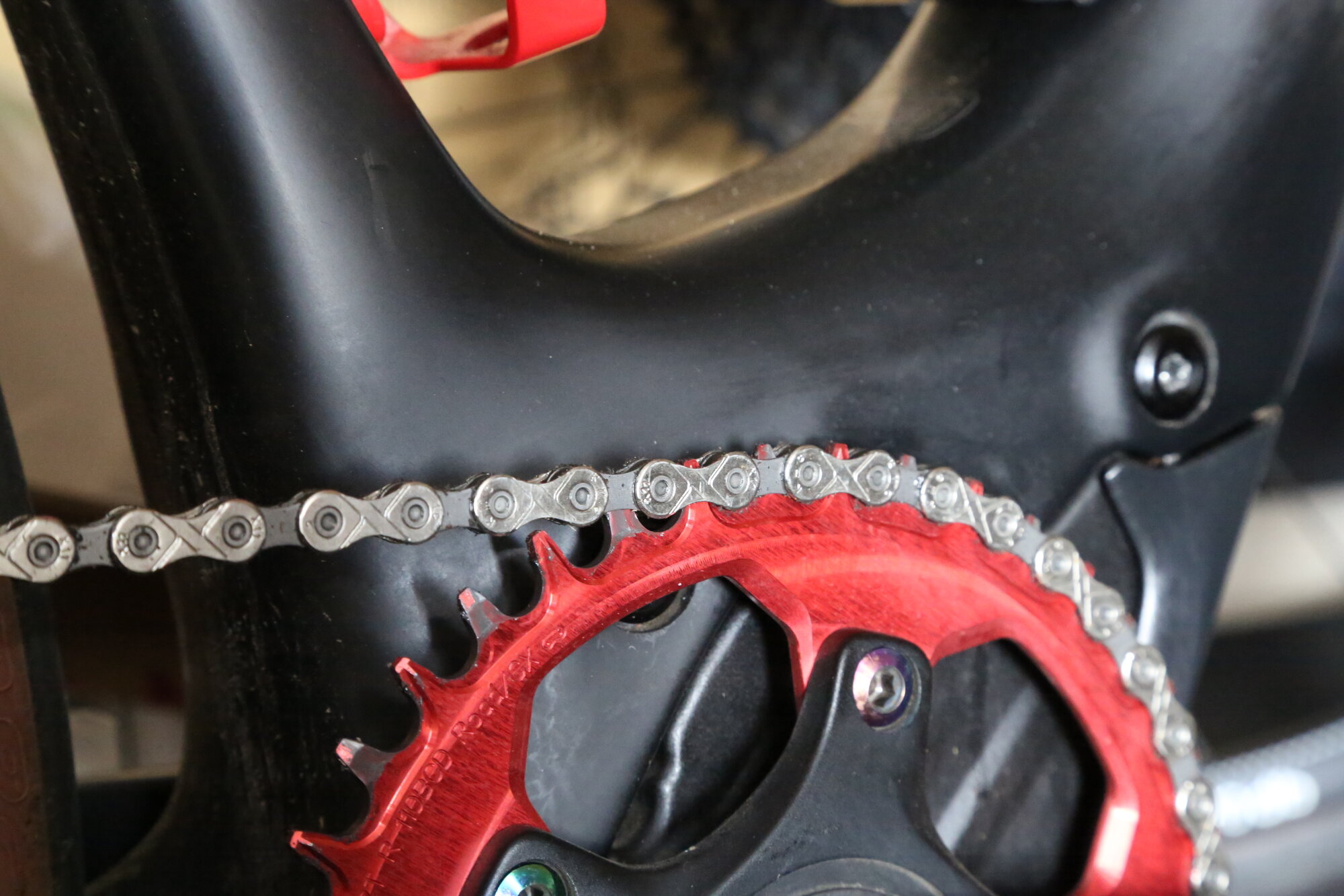

Hi. I’m really late to the party! I can answer your question - sort of.
I finally got a garbaruk chainring today since I’ve had two chain drops on my Creo, each time being a right bugger to sort out (on the road) since the chain gets caught between the frame and chainring. But you’re right - the chain line is different, but in my case the garbaruk took the chain line further out from the frame, meaning the chainring lines up with a higher gear than with the Praxis. I assume this will lead to greater chain wear on the lower gears so it’s not ideal. However it does mean there’s greater clearance between the frame and chainring so a dropped chain wouldn’t be such a pain.
I suppose it may be possible to put some washers in to move the chainline in, but then you’d lose some of the clearance.
I haven’t had chance to actually ride the bike with the new chainring - I’ll keep you posted.

Odd for a Garbaruk to drop like that. Is the Chainring smaller in teeth, did you adjust the chain length accordingly and is the clutch on?
Don't think he's ridden the Garbaruk yet, and the drops occurred with the Praxis.
I also noticed a slight outward shift in the chain line with my Wolftooth - I think the original Praxis is slightly dished while the replacement chainrings are flat.
