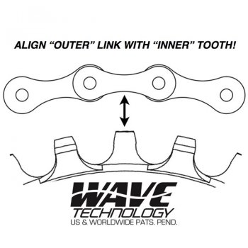

Also adding to the potential complications is the WAVE technology chain ring where the outside plates of darn chain have to be aligned specifically with the teeth pattern!
Placing the chain wrongly onto a Narrow-Wide or WAVE chainring will make the chain drop.

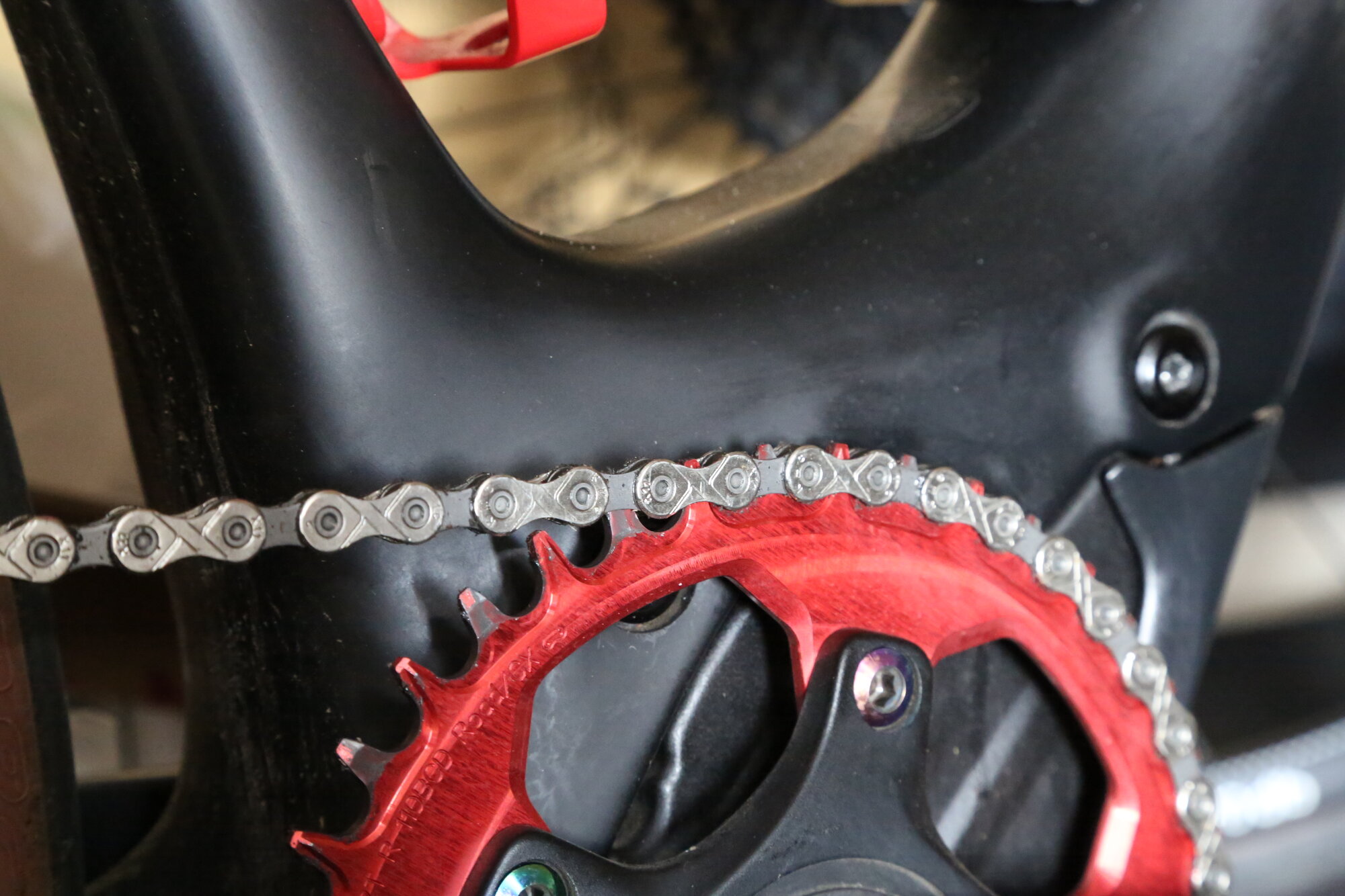

I use the Garbaruk Narrow Wide chainring. It has taller teeth than most, giving less chance of the chain being dropped and I have never lost one. These are also half the weight of the Praxis one you get as standard

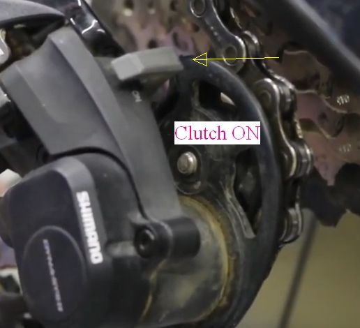

I was having this problem regularly, especially while shifting rapidly in a descent. Then, by accident, I happened to read the Shimano manual for the GRX rear derailleur and discovered it had a clutch (which was designed to prevent this). Checked, and sure enough, my bike disengaged it; you have to in order to remove the rear wheel. So, check this out first. Resetting it ended my chain-dropping problem.

I now carry these two images on my phone. One showing the clutch engaged and one of the WAVE tech alignment.
