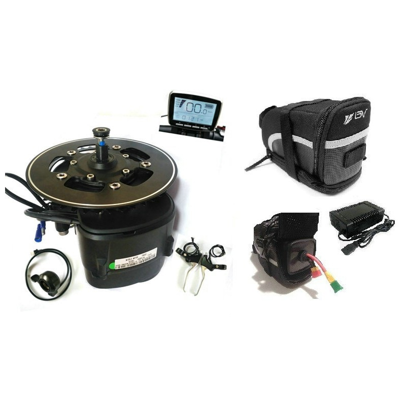

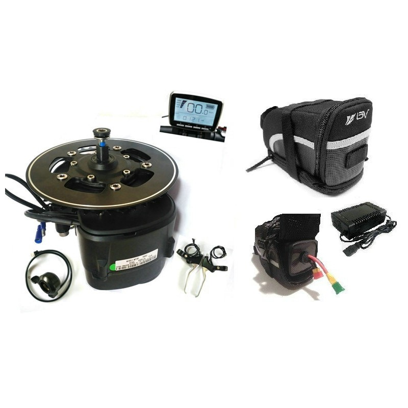

If you don't mind the larger VLCD5 display recycles-ebike sells this kit including a 8ah seat bag battery for $500.
