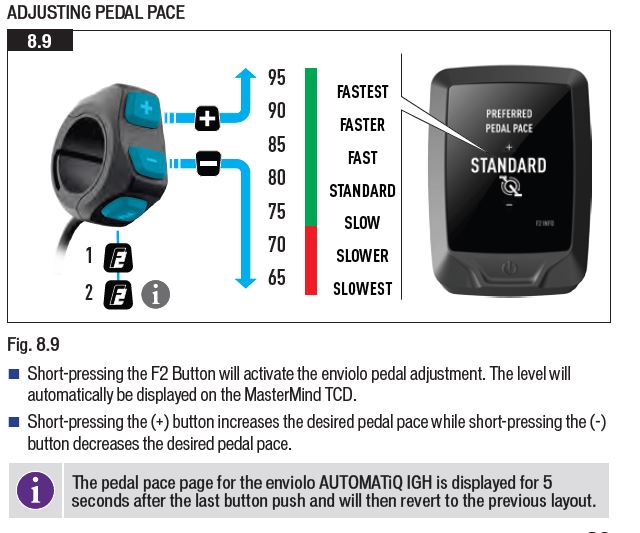

I can’t seem to find this setting , could somebody give a step by step instructions to test/set this to lower cadence? I would appreciate it
Hi,
A lower cadence is available from software version MM TCD Display firmware 29.E.0. (2023/08/02) replaces 20.E.0 Required for Enviolo Automatic IGH bikes
Features: An improved cadence mapping for automatic IGH cycling
Unfortunately, the image in the manual is still with the older software! After the update, the values changed: 50 - 60- 70- 75- 80-85-90
50 = Slowest - 60 = Slower - 70 = Slow - 75 = Standard - 80 = Fast - 85 = Faster - 90 = Fastest
