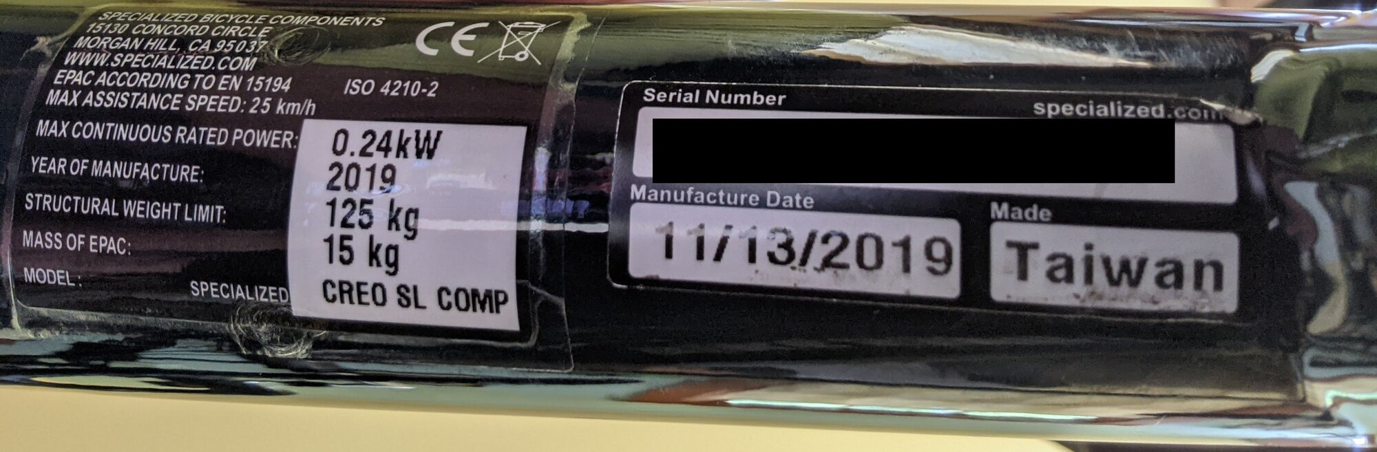

Okay, I went out riding today. I found a flat almost straight-away section and started pedaling furiously. I had the bike to about 22 mph in Eco (30/60, I think) when the path started to curve. I still felt the motor in the mix. It was not like when you Press/HOLD the Power Sector Button (and the motor drops out). In a RESTRICTED bike would the motor simply drop out like the Press/Hold or would it resist the pedaling higher speed. Again, my label (USofA bike) shows the 25km/h limit so would it have dropped out at around 15mph if it were restricted?
When you reach the cutoff speed, the motor doesn't "resist" your pedaling, but it does suddenly get harder exactly as if you'd changed to "Off" mode. You definitely know that you're not being assisted any longer.
@kahn: All signs show your Creo is at the Class 3, and the 25 km/h label had just been placed there in Taiwan before your e-bike was imported in the United States. The distributor must have reprogrammed the Creo batch to meet your regional requirements.

Good description of how it works. I did hear my motor "purring" yesterday so I'm fairly certain my bike is set to US standards. I know I can hit 45mph on a good downhill with the motor "off" as I did that plunging down the eastside of our Cascade Mountains about a month or two ago. It is thrilling fun hitting those top speeds on the right downhill road. I was doing 30 to 40 mph for quite a long stretch. Even in the city I can hit 25 mph - Seattle is a more gentle San Francisco-like terrain city. But I hope to do one more test on another path with a long flat straight-away.
My central USA delivered Creo CC does not have the sticker on the left and it is definitely not cutting out at 25 km/hr. I wish it did have the sticker as I sometimes ride in areas which Class 3 riding is technically not allowed and it might keep me from getting a ticket someday.;)
My theory is your bike came from a Specialized distributorship which also ships outside the US. Those that go outside the US are set to Class 1 limits and use metric units; perhaps by default. Yours was programmed as a Class 3 ride if you could hear to motor at 22 mph.
I guess it is possible that a distributor might service Seattle and possibly Canada. I see what you mean - with my "restricted sticker" I should be able to claim innocence and have a sticker to prove it! I will have to copy that back to my phone. Goes next to my vaccination picture!
