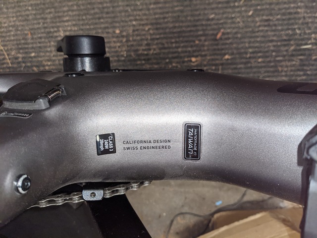

In Post #40 above, I posted a picture of a label found under my top tube near where is joins the seat tube. The label says that my US purchased Creo is set for a "Maximum Assistance Speed: 25km/h". I don't know if that is true or not as I have never really checked any limitations while riding. But now I'm curious if others with either the Creo or other SL and maybe other bikes have a similar label and what it might show. And this question would apply to any Specialized e-bikes either from Europe, the US, Canada or Asia. Again, from the above thread, I cannot find any label on my Creo specifying its CLASS.

Kahn: the sticker on your Creo might result from importing a number of Euro Creos to the U.S. during the pandemic supply chain crisis. It is highly probable that your e-bike has already been set to Class 3. Or not. In the latter case, it can be easily reprogrammed to Class 3.

You can change the Vado/Como to either 32kph or 45kph but there's no sticker that's available. I haven't messed with the SL's all that much but I suspect it's the same. For a Vado AL class 1 alternative check out the BMC Amp bikes, can be in the low 30's weight wise, Shimano class 1 pedal assist, pretty cool!
(I’m the o.p.) My friend asked her local Specialized store if it is possible to restrict the Vado SL to meet class 1 standards and was told no, it can’t be done. She then emailed Specialized corporate with the same question and was told Yes, it is an easy process that can be done at the local store. She bought one and hasn’t decided if she will have it restricted, but has written confirmation that it can be done if she chooses.
On a US Creo it is on top of the motor housing by the seat tube. It might be obscured by a water bottle.
My class 3 stickers for the Vado SL and Creo are up a few inches higher on the seat tube very close to the interface with the motor housing. I have water bottle/RE Battery holders installed so they are typically covered up. Not sure if they were placed there by the factory or the LBS. I like the location. If I'm ever riding where class 3 bikes are not allowed it will be hard to find them and/or I can claim ignorance.
My Vado sl 4.0 sticker is on the seat tube, just below the water bottle mount. “Class 3, 240 W, 28 mph”

Okay, I went out riding today. I found a flat almost straight-away section and started pedaling furiously. I had the bike to about 22 mph in Eco (30/60, I think) when the path started to curve. I still felt the motor in the mix. It was not like when you Press/HOLD the Power Sector Button (and the motor drops out). In a RESTRICTED bike would the motor simply drop out like the Press/Hold or would it resist the pedaling higher speed. Again, my label (USofA bike) shows the 25km/h limit so would it have dropped out at around 15mph if it were restricted?
