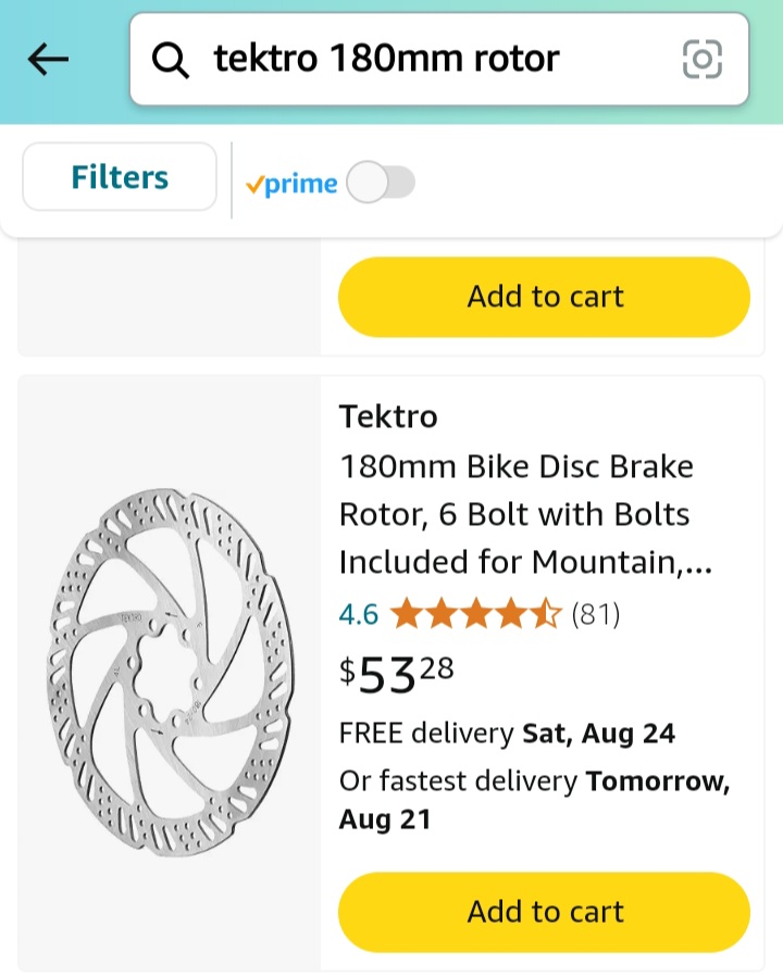

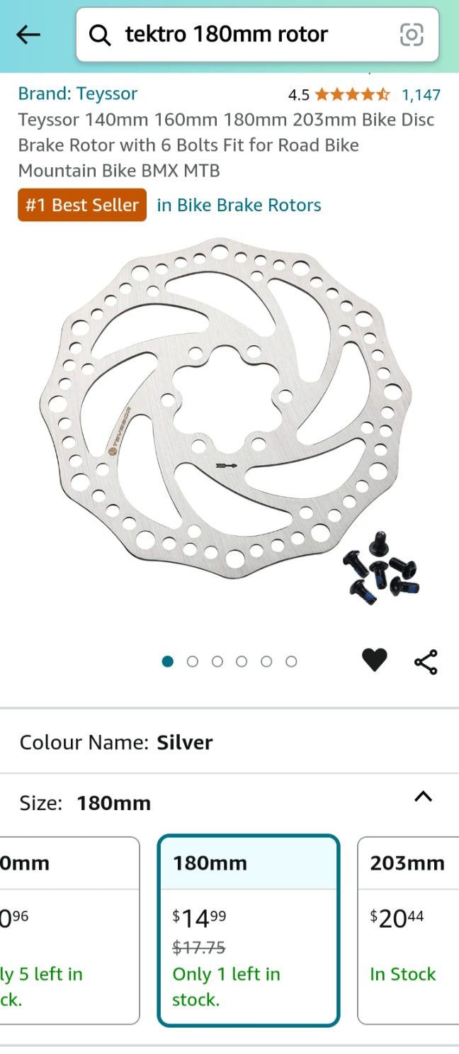

A was looking at replacement rotors for my e-bike on Amazon and the off brand version was less than ⅓ the price,..
I'm just going to get the cheap ones if I get new ones.

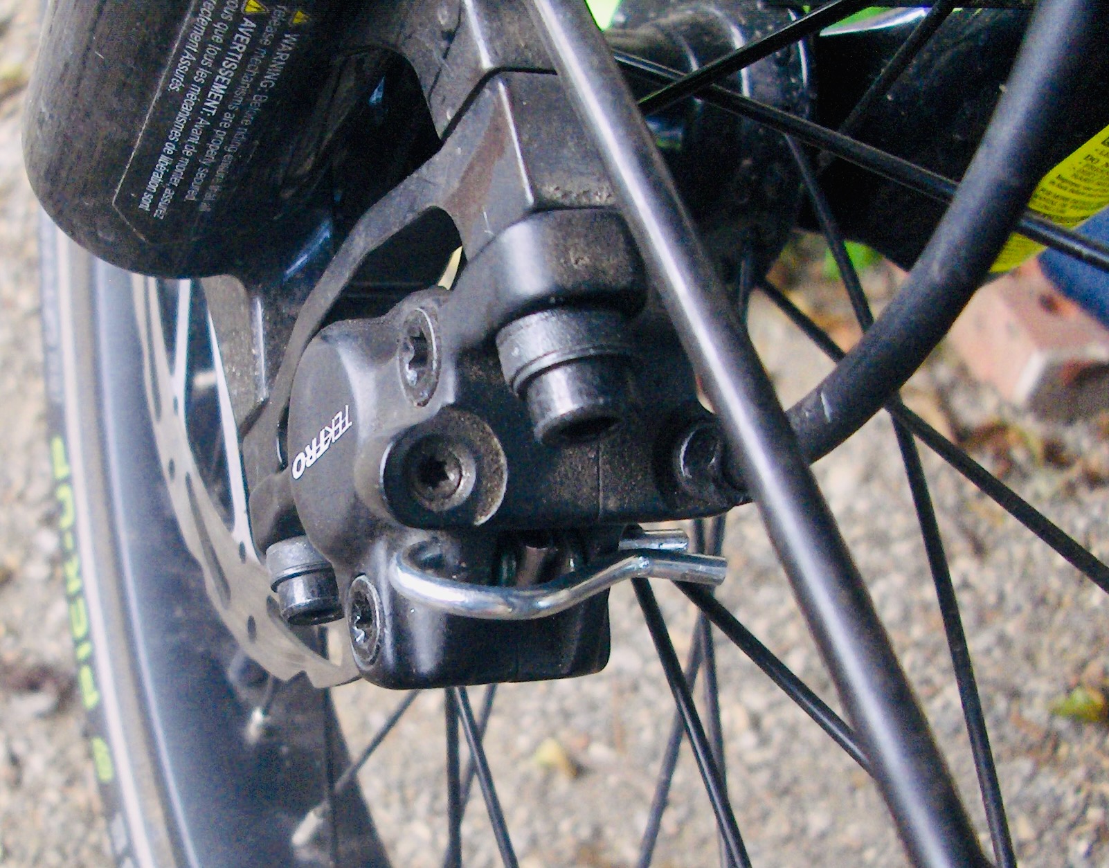

What's this? A 1/8" R-clip for brake pads? I'll bet it would also hold a playing card to hit the spokes so folks will think I'm on a smokeless Vespa!
