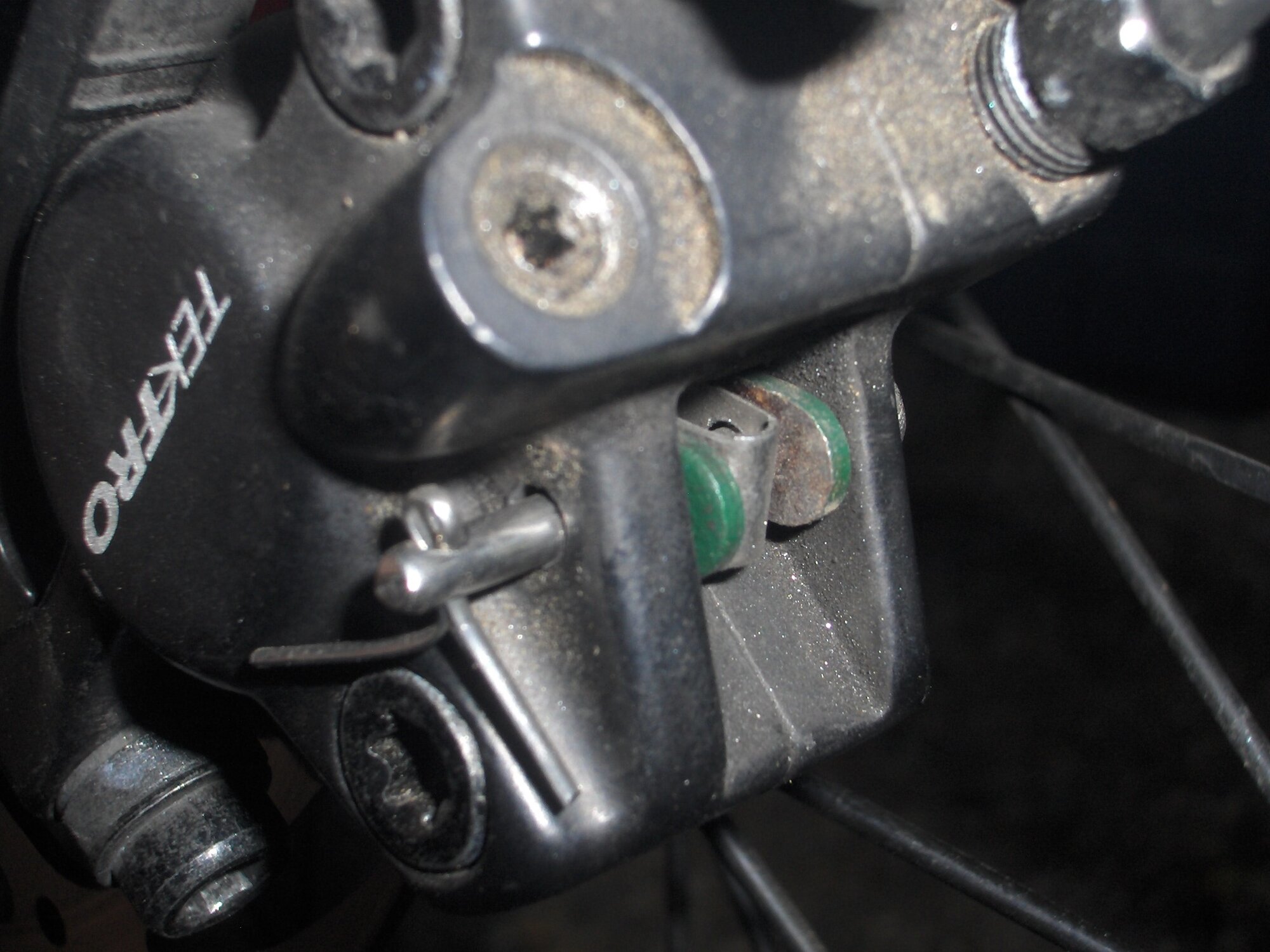

I get up to 23 mph descending a hill near my house. I usually brake at the bottom to slow for the speed bump. Last week, when I applied the brakes, there was a clanking sound. It continued when I released and reapplied the brakes. I was afraid I might be incurring serious mechanical damage or might be thrown to the pavement.
It went away within seconds. I checked the bike and found no explanation. In the following days it happened at that spot several more times. I didn’t know which wheel it was coming from or if it was coming from a wheel. It continued whether or not I was braking, whether or not the motor was on, and whether or not I was pedaling. Generally it clanked once per wheel revolution but could happen more than once.
The last time, when I reapplied the brake, it changed from a clanking to a brushing sound that I recognized. It happens when a pad leaves a footprint after you brake to a complete stop with a hot disk. In this case, it happened with no stop.
Maybe a thicker deposit of pad material on the disc could clank and do so even with the brake released. As the watts of heat on the pad surface vary as the product of force and speed, the surface would tend more to get hot and soft at 23 mph than at lower speeds. I hadn’t felt any lurching or lever pulsing.
I checked the derailleur adjustment. I took both wheels off to better check discs and calipers and make sure all 72 spokes rang.
I reassembled the bike and tried what I should have done several days earlier: applying one brake at a time. At normal speeds, each was quiet. On the hill, I heard a faint ticking, like a mechanical wrist watch, from the front brake. If a tiny spot of pad material on the disc could cause ticking, a bigger spot might cause clanking.
Before the trouble started, I’d left the bike in the carport for a couple of days without riding it. During the night, it would cool nearly to the dew point. If I didn’t ride during the day, there would be no warming to dry it out. I think the pads had absorbed enough moisture from the air that when I braked at 23 mph, the heat could instantly cause a little lump to stick to the disc. When my clevis pins arrive, it should be easier to remove pads to check for pitting.
In 1 minute on low, my heat gun can raise the temperature of the outboard side of a caliper by 70 F. The inboard side gets almost as hot. I heated the caliper several times and have had no more trouble. I’ll keep my heat gun in the garage. At times when pads could be damp, a minute or two per caliper could help the pads.

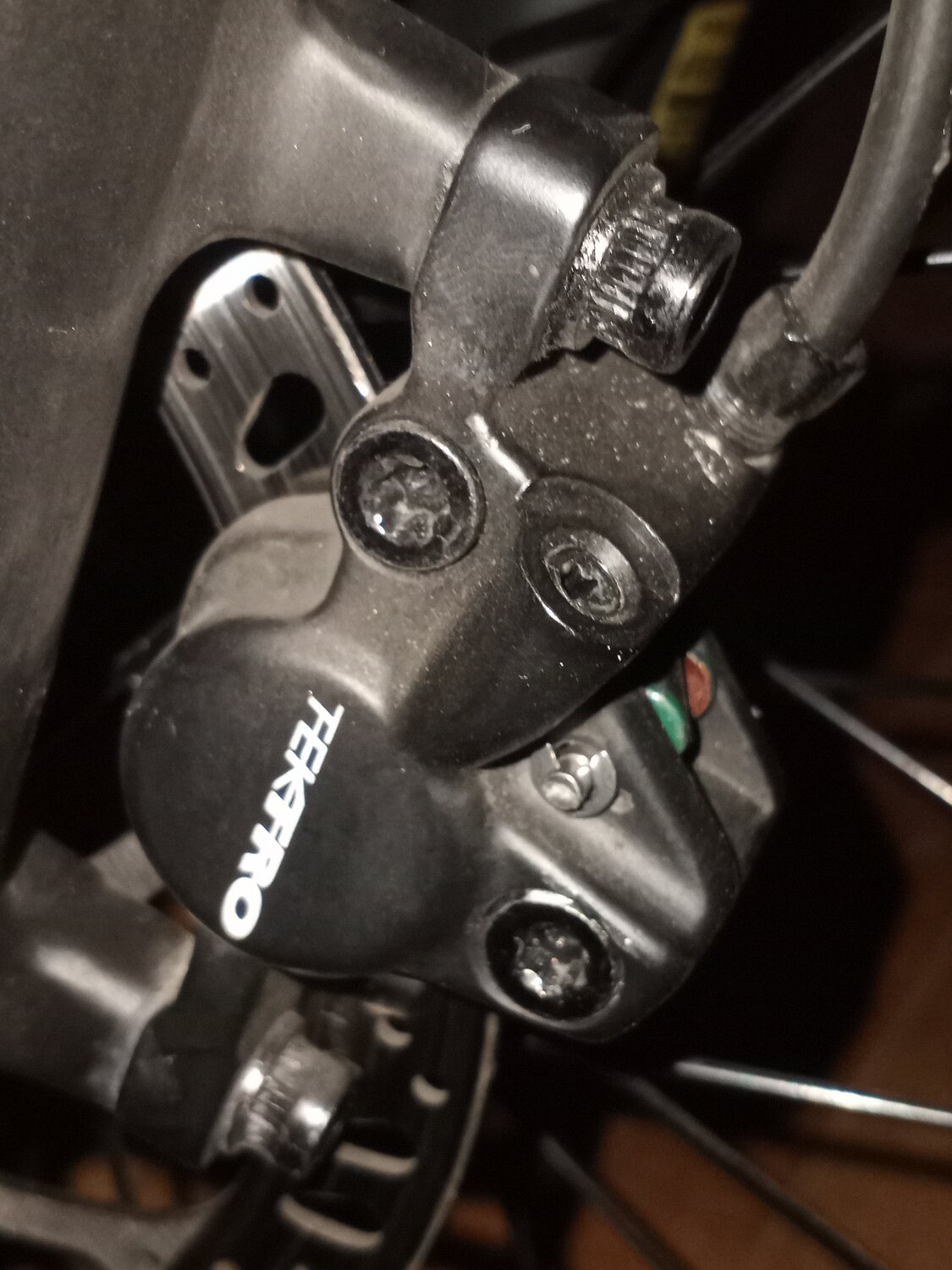

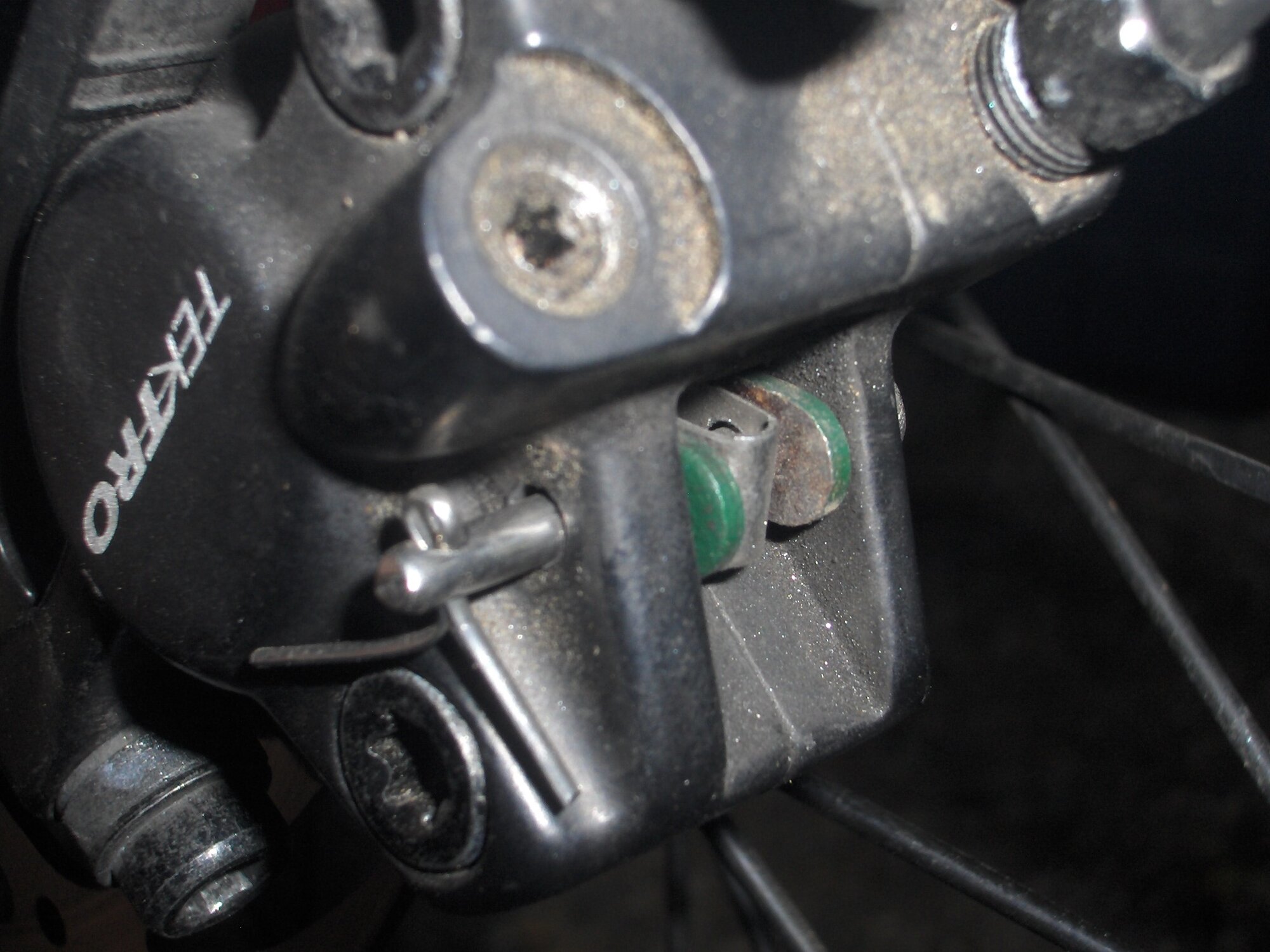

Tektro HD E350. It was again working fine but for a faint click on each revolution. Using the brake wasn't wearing it away, so I washed and rebedded the disc. Now it works like new.
I got the idea of washing the disc from the other bike, with Tektro Aries brakes. During a month without being used, it seems the pads absorbed so much moisture that they wouldn't hold at first, and they wore down in a handful of stops. New pads restored performance, but breaking hard with the front felt like riding on a gravel road. Washing the disc fixed it.

My problems have come from pads. Shimano says if you use resin pads in a rainy environment, you'll need to replace them every few rides. I think that's not all, that the resin can make the disc surface uneven if it comes off the pad too fast. I also think humidity can cause it even if it hasn't rained for weeks.
After clanking incidents over a period of days, a couple of minutes with a heat gun kept it from recurring. I experimented further. After a day's riding, I left the bike in the closed garage overnight, where the warmth probably kept the relative humidity below 75%. Twenty minutes before riding, I gave each caliper 1 minute from the heat gun in case even in the relatively dry garage it had absorbed moisture.
To test brakes, I apply them one at a time. I'd always found that if I wanted equal braking, I would have had to pull one lever or the other a little harder. This time, equal pulls seemed to produce equal braking. I concluded that resin pads often have enough moisture to affect braking, and one is likely to be drier than the other. Before a day's riding, a couple of minutes with a heat gun may help me get the best out of resin pads.
Another solution would be to use metal pads, which are said to have drawbacks.

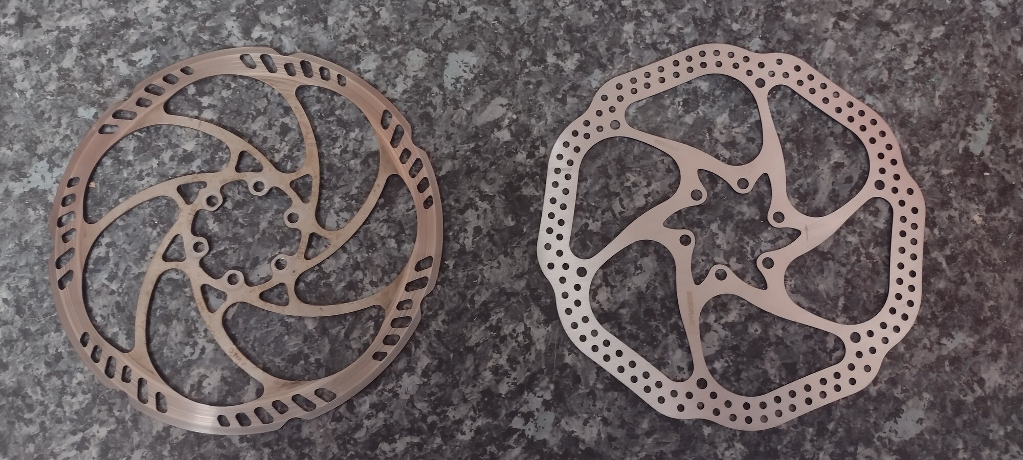

I was getting some terrible juddering from my Haibikes front brake, I was worried it was going to snap the fork !
I guessed the front disc was warped or worn out, so to diagnose it I bought a generic 180mm disc off Amazon for 9 quid, next day delivery..
Pretty cheap.
I didnt realise that price was for two.
Heres the original Magura and the other disc, it turned out they were just a few mm bigger and scraped the caliper, a quick filing fixed that.
9 quid for two, next day free delivery
Should be good.
I guess leaving the bike in 100% humidity softened the pads so that they could leave a deposit that caused clanking. It hasn't happened since I used a heat gun on the calipers, which I assume dried the pads. The brakes were fine except that the front brake was rough if I braked hard. Washing the disc cured it except for a "brrrp" between 15 and 13 mph, braking hard with the front. It wasn't violent. It was like what you might feel and hear dragging something with rubber feet across a smooth, wet floor, as the rubber rapidly catches and lets go. A light machine gun might shoot 600 rounds a minute. This was faster.
The first time, I washed it in a sink with washing soda and dish liquid. A washed it again, this time without removing it from the wheel, using dish liquid and a scrub cloth for dishes. The "brrrp" is still there, between 15 and 13 mph, but it's softer. My guess is that there's still a deposit on the disc, and I need a better way to wash it.

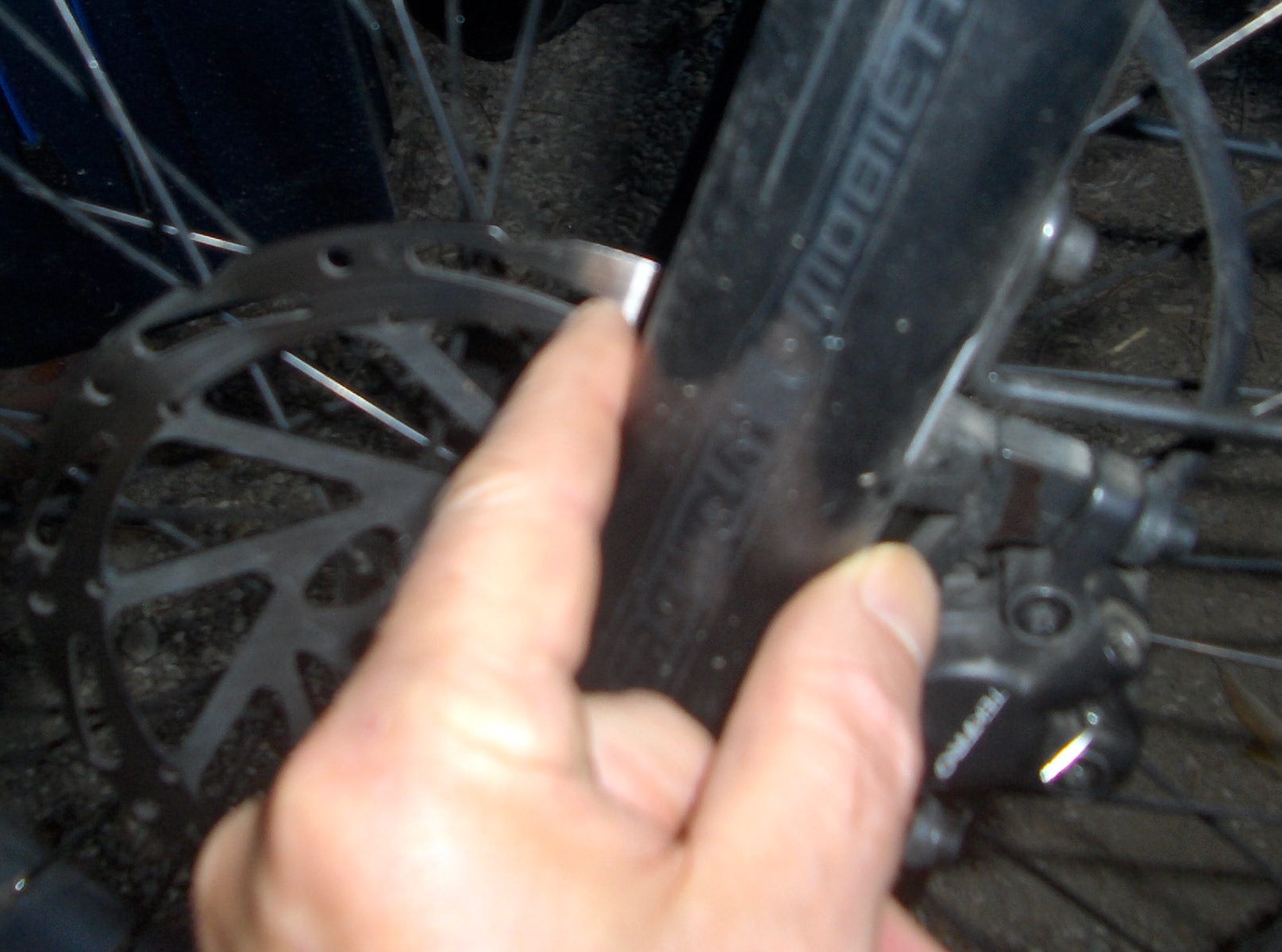

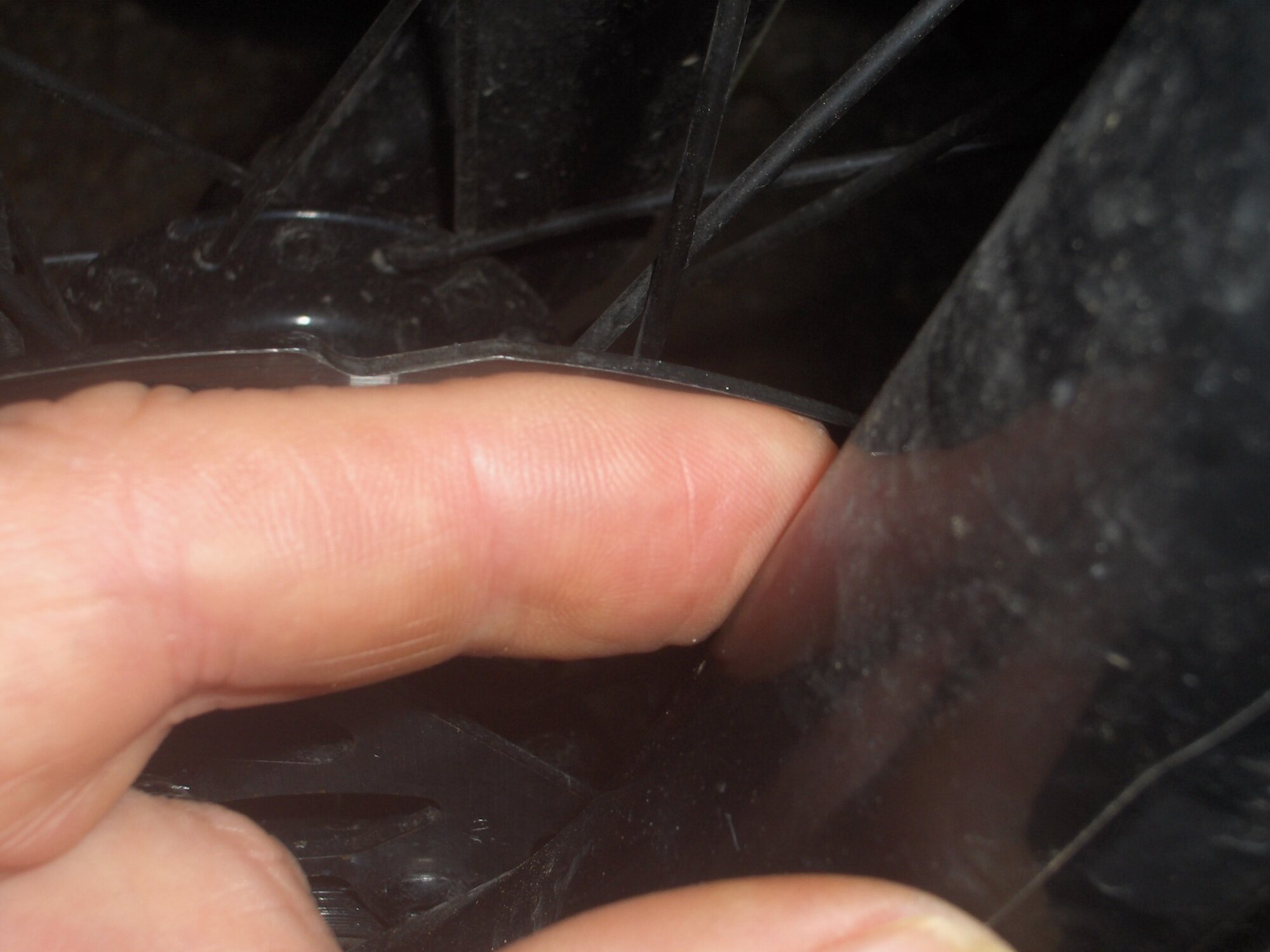

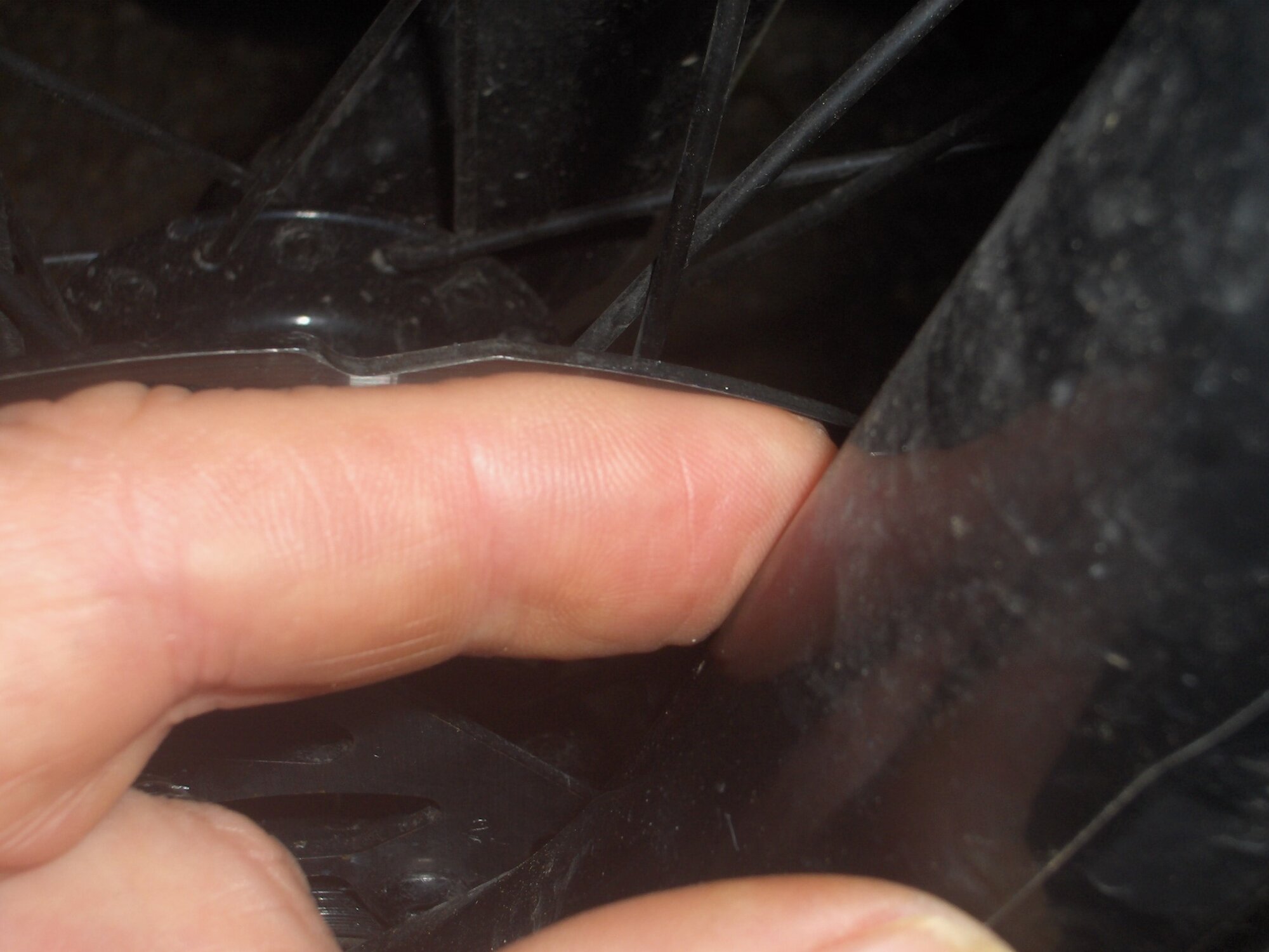

When I read of your possibly warped disc, I put my finger against the fork with the nail barely dragging the disc. I rotated the wheel. Any runout is less than a mm.

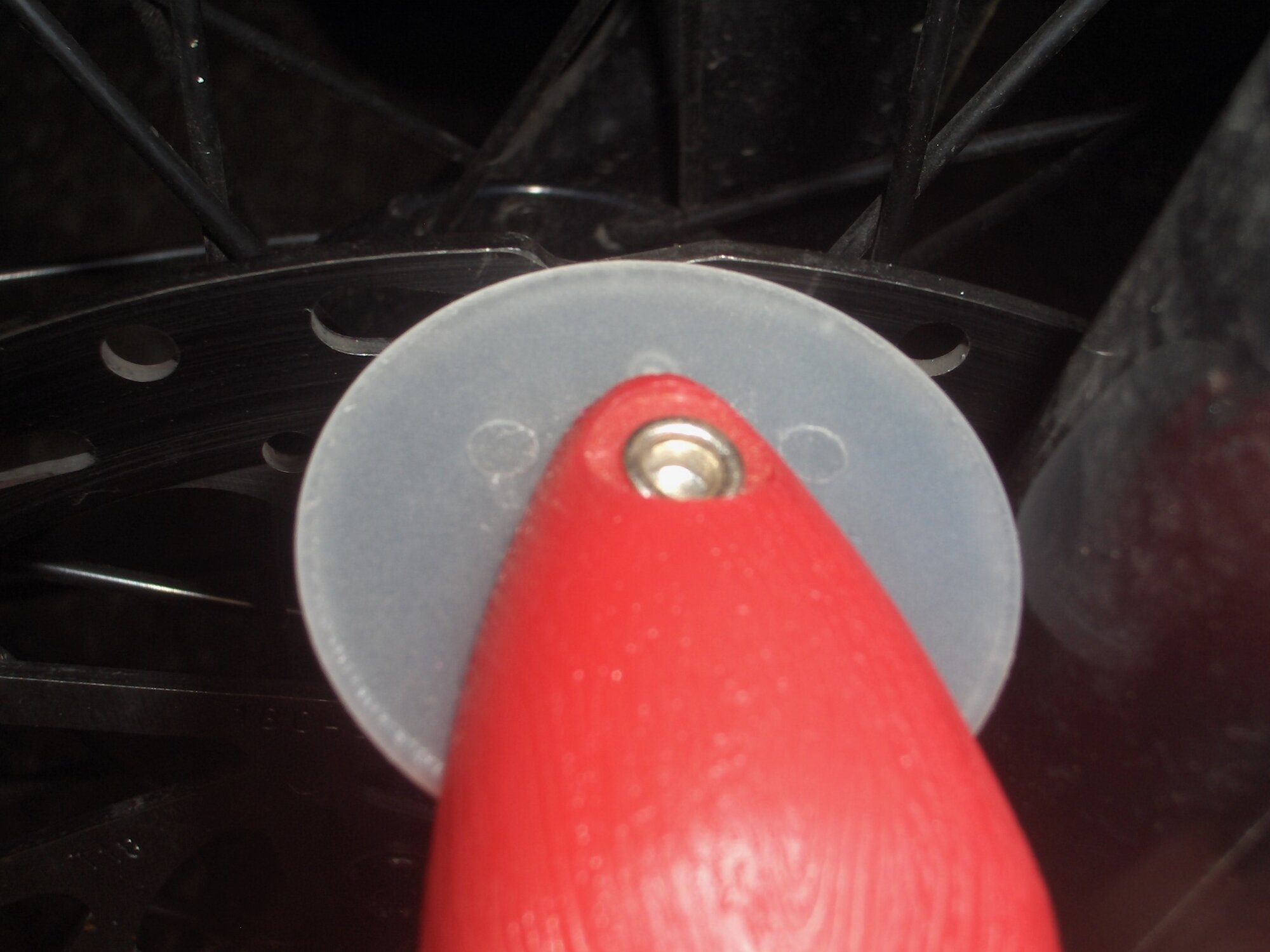

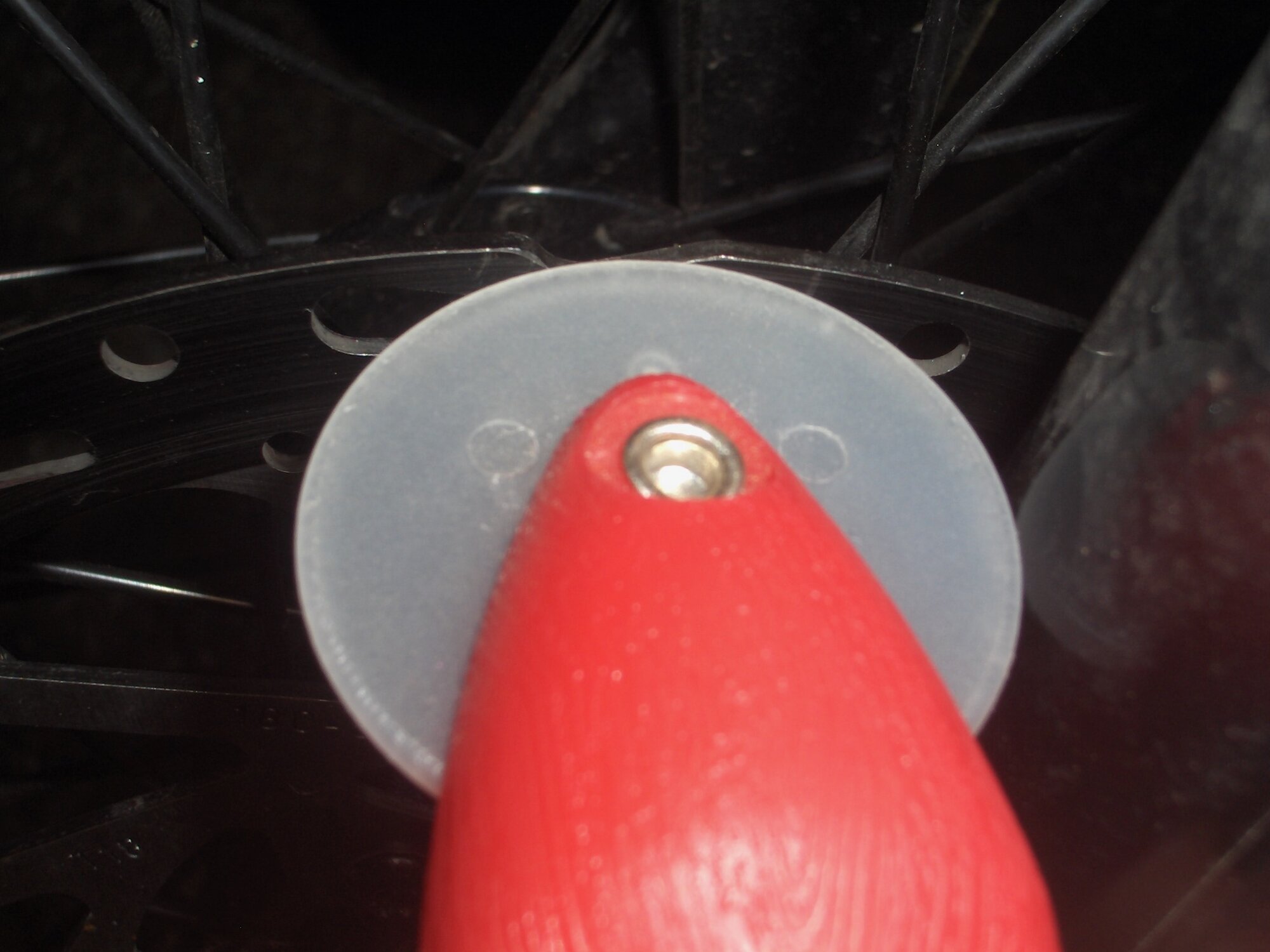

I have a little tool with a nylon wheel in each end. It was made to push in the rubber spline that fastens insect screen to a window frame. I'll bet that tool would be better than a fingernail to check a disc for runout; the wheel wouldn't catch in the holes.
,.. I'll bet that tool would be better than a fingernail to check a disc for runout; the wheel wouldn't catch in the holes.

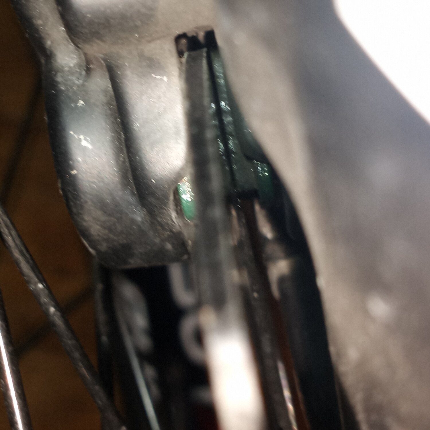

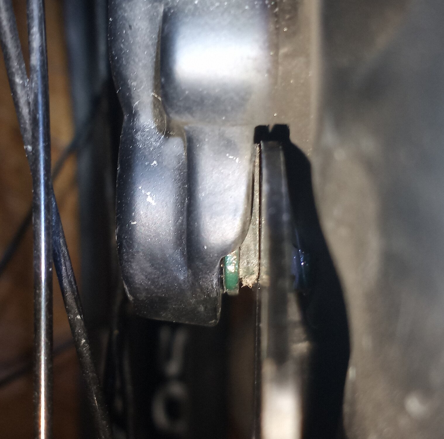

I just look in the backside of the caliper and watch the pads as the rotor turns.
It's way easier than trying to hold anything steady enough to measure runout of less than a mm.

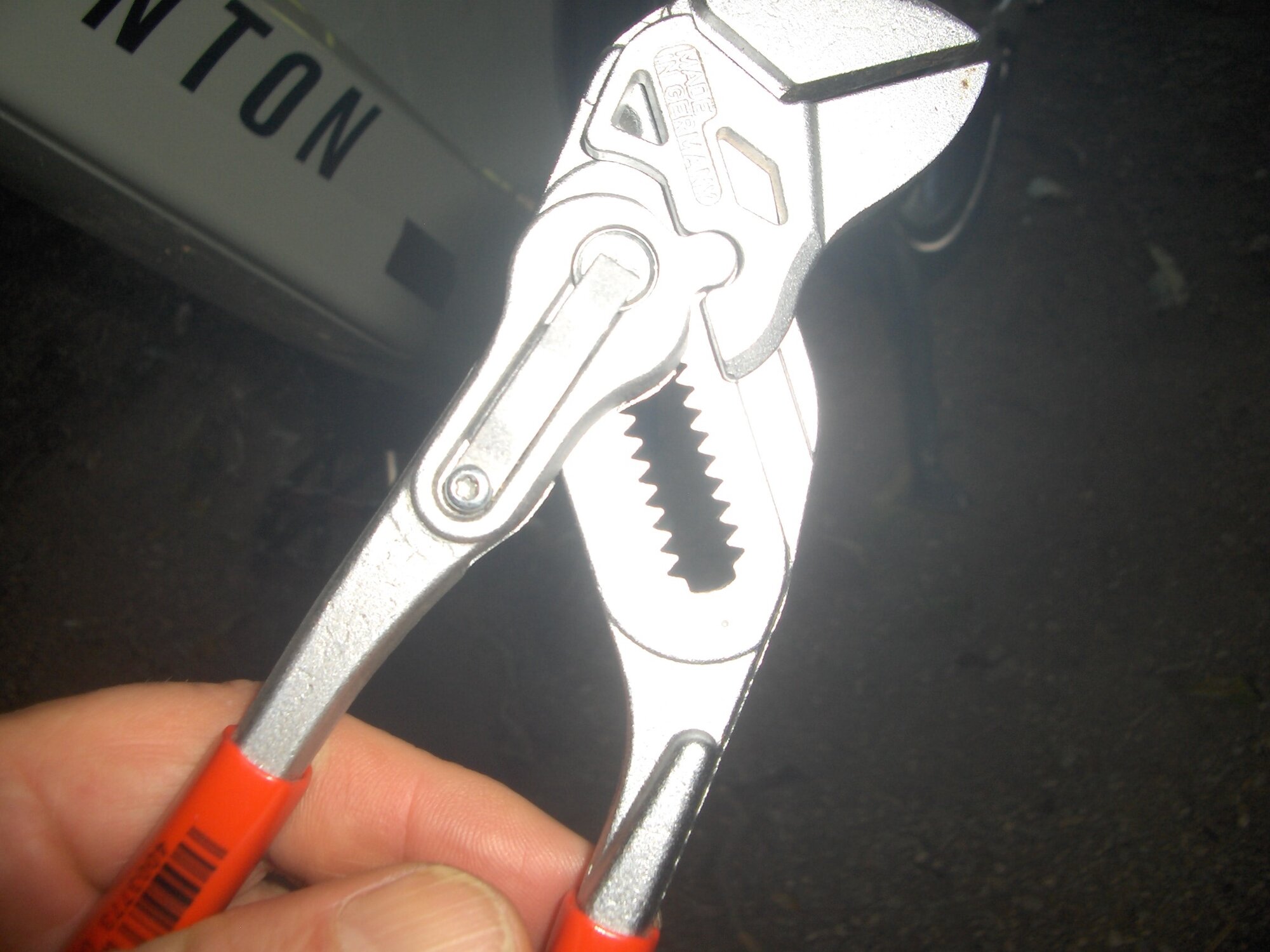

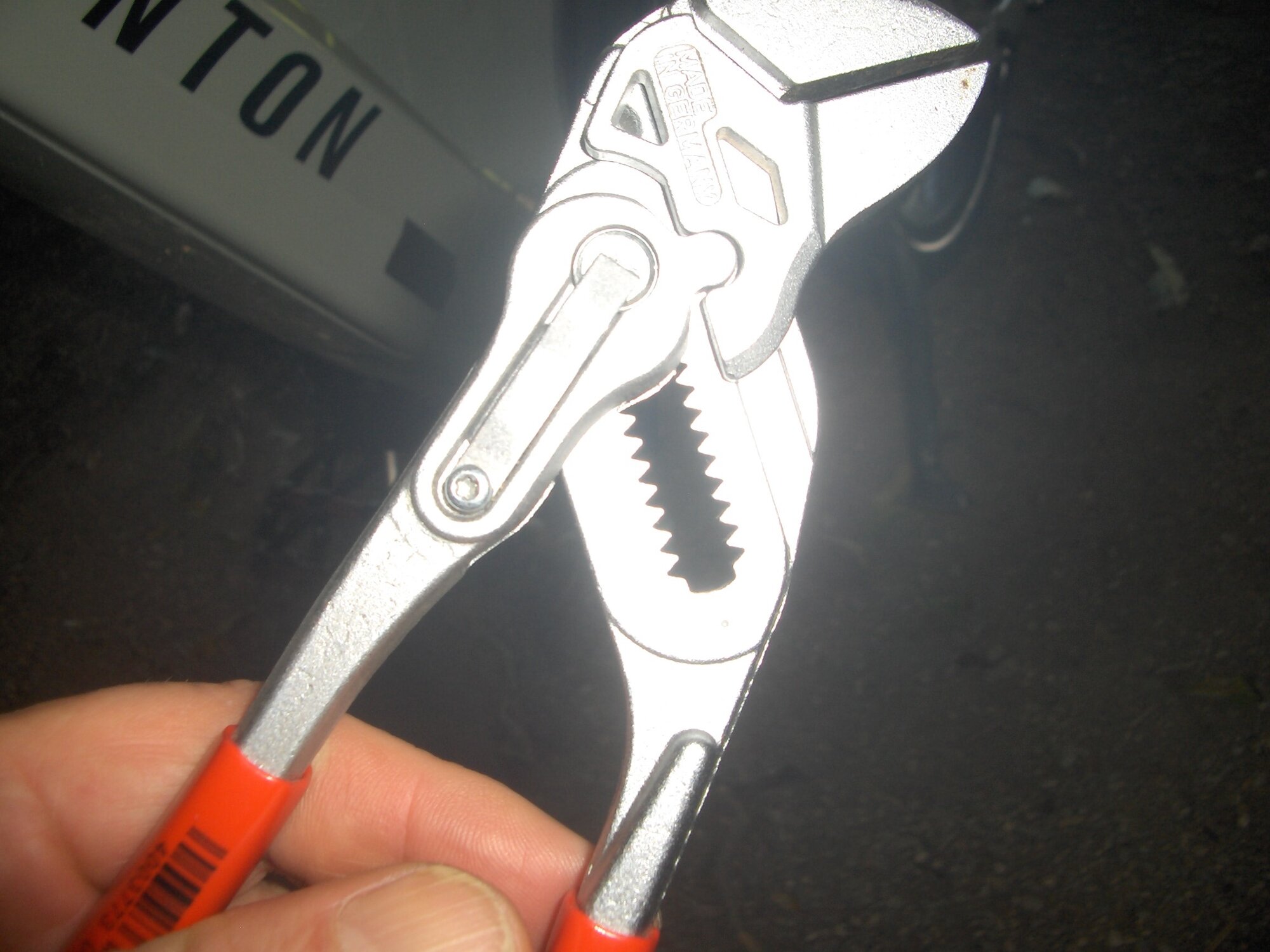

I don't know the runout tolerance of a disc, but nothing rubs if the brake is off. I couldn't get a good look at the disc in the caliper. I found the spline tool. The wheel is too big. It would rub the fork. If I stick my finger between the fork and the disc, the disc rubs the back of my nail like a brake pad. The pressure and drag feel nearly the same all the way around. I did make slight adjustments with my warp tool.
