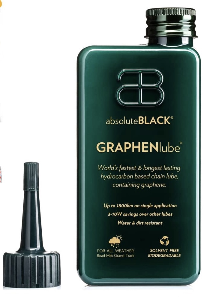

I use GraphenLUBE. You only need to relube the chain every 1,100 miles (1,800km). Plus it adds 10 watts of power going up hills. It's like an e-bike. Sometimes I don't even pedal uphill. I just kind of float up. Best chain lube ever.
edit: Oh, I see they have a video of the entire procedure.
(Okay, how do you use it? Apply like oil/lube or remove chain and soak in this stuff?)
That nozzle looks suspiciously like a Preparation H applicator.
I tried a couple of different ways. On a new chain I followed absoluteBLACK’s recommendations and cleaned the chain in mineral spirits, let it dry for 24 hours, then soaked it in GRAPHENLube. Worked like a charm. Rode 300 miles of mostly gravel in dry conditions and it didn’t need any lube, but I got bored and dropped more on the links – so I’m not sure how long it would have gone.
On a kind-of-new chain that needed re-lubing every 160 miles or so, I just dropped GRAPHENLube onto the dirty links. It needed lube again in about 160 miles. Relubed with GRAPHENLube a second time. It went about 220 miles. Third time it went about 300 miles. I’m on the fourth lube at this point and I’ve totally lost track of the miles. Must be at least 600 miles. Maybe 800 or more. This is my Zwift bike. I ride it 4-5 times a week. My wife rides it too. The chain is still quiet like it was just lubed.
GRAPHENLube works. Tadej Pogačar just won the Tour de France with it for the second year running. I like it for the opposite reason: I’m lazy. I don’t have to oil my chain as often. That part of it works.
I‘m now using it on three bikes. Two chains got the full mineral spirit cleanse and deep GRAPHENLube soak. After the soak you pour the lube back into the bottle. All told I still have about 1/2 of the bottle left. I expect it will last into 2022. Not terrible economics.
