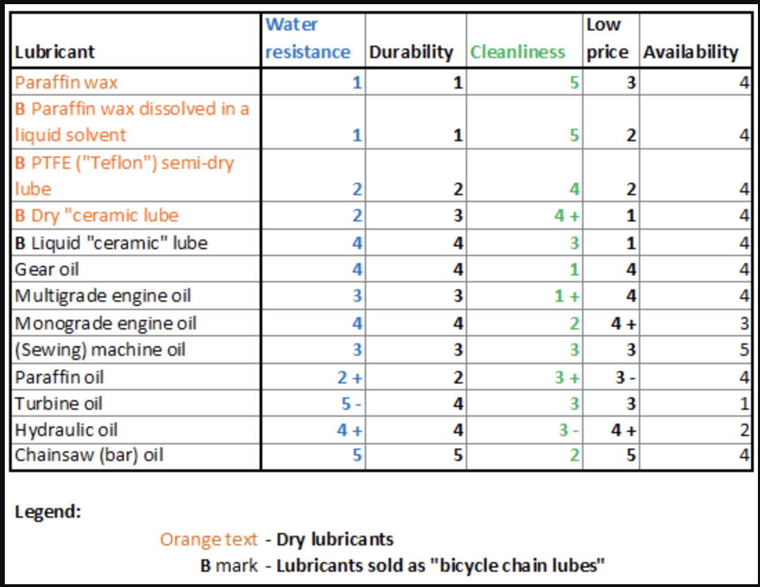

And a link to this comparison
Interestingly, if you ride on pavement with little dirt/dust but do have rain, chainsaw oil ranks pretty highly.

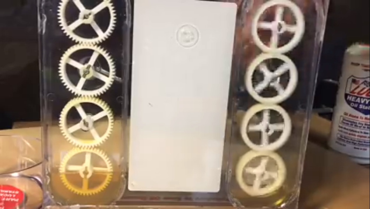

Has anyone ever tried Lucas Oil ?
It's got even more cling than chainsaw oil, it's almost rubbery ?
