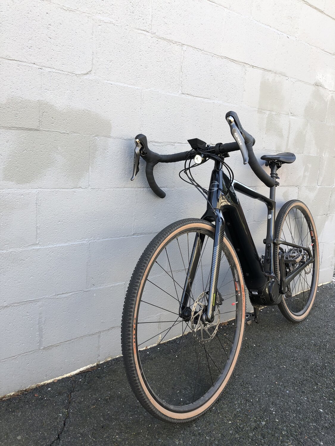

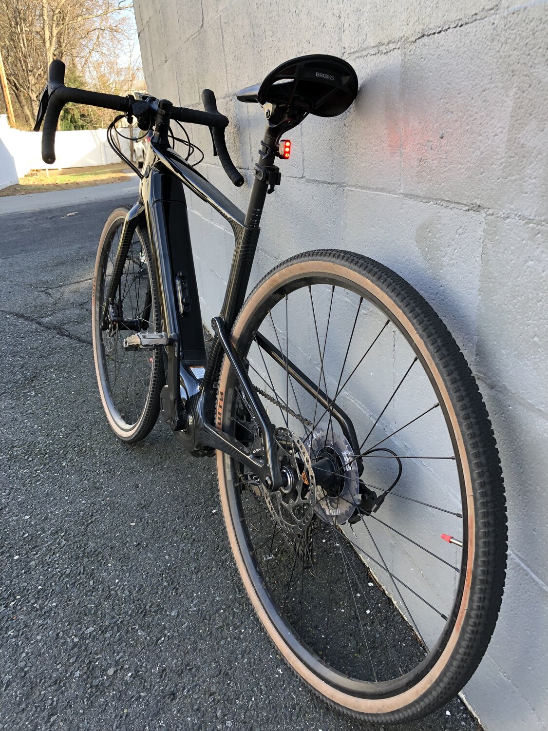

Great to see discussions about canondale, I have a topstone 2 just like @ghost with the Kiox display. I had a lot of problems with the WTB wheels so I replaced them with DT swiss and replaced the tires with Continental tires since I do gravel. now the bike handles like a dream, did a ride yesterday 55 miles with 2500 ft of climbing 45% Eco and 10% Tour mode, made it home with 5% battery left. I weigh 270 lb (hey that's why I have an ebike). Picture before the wheel swap.

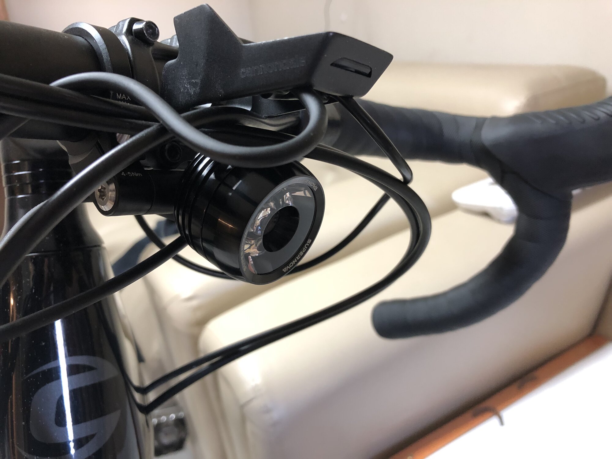

I went ahead and installed lights on my bike. Since it was prewired all I had to do was solder the wires so it was relatively easy to do. Wasn't sure if I needed to bring it to my bike store to activate the lights but it turned right on so it wasn't necessary. Now I don't have to worry about forgetting to bring lights or running out of battery.
