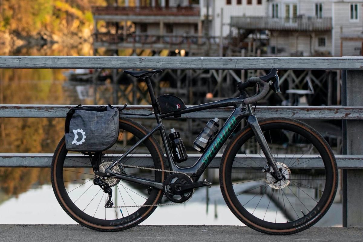

I'll be using an Old Man Mountain rack, with Revelate Design Nano Panniers. Both pictured below. The OMM rack uses the thru-axle as the load-bearing mount.
I would listen to the manufacturer and just use a decent backpack. There are robust, heavy duty ebikes, like those made by Riese & Muller and then there are carbon fiber drop handlebar ebikes that are built to be as light as possible. You would not use a Porsche to haul a heavy trailer or load it down with four people plus luggage. That just is not what they are designed, intended and built for. You want to haul cargo get a cargo bike or at least one intended for touring and built to handle more than just a rider.
My guess is that rack may not work. It connects both the rear axle and your seat tube and when the frame flexes that distance changes.

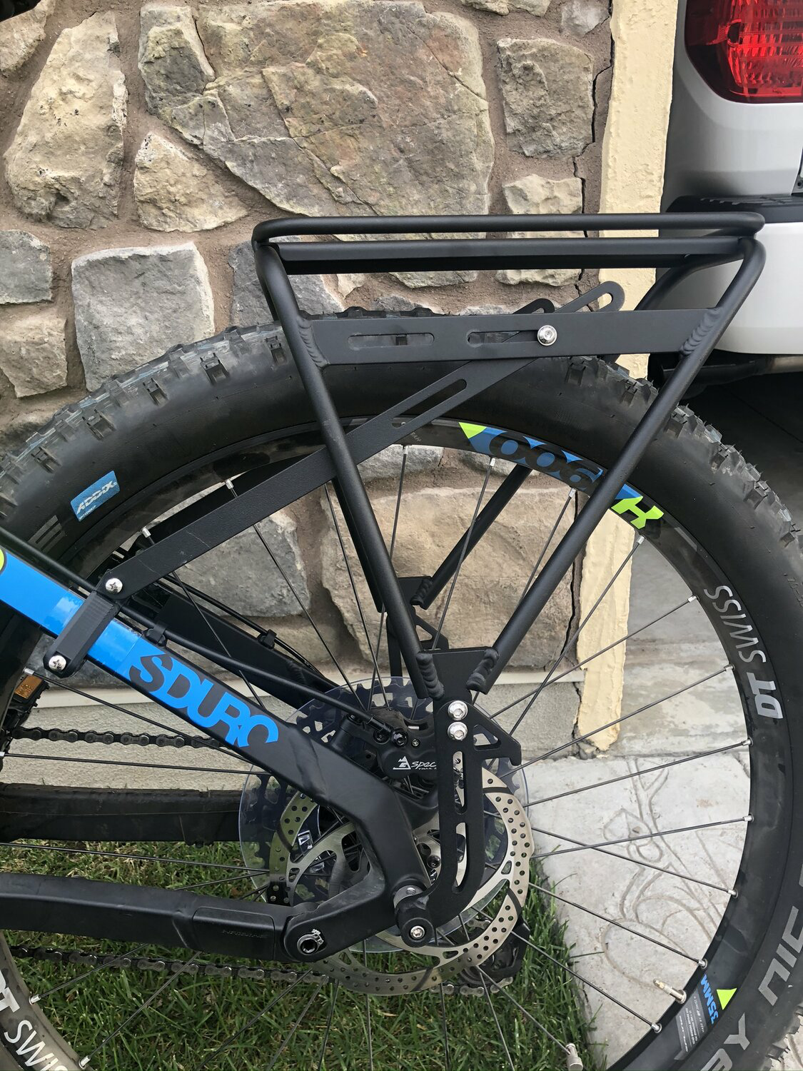

It can basically connect anywhere. Any load is on the axle. Here is an example how I will connect it.
This is a good review of the old man mountain racks as they apply to full suspension carbon fiber ebikes.
Ah this version. Yes it works with a regular FS and old man mountain is a good brand.
However you should still make sure that the attachment point works without stressing the frame. You can see how the rear suspension work in this link. https://www.cannondale.com/en-us/bikes/road/gravel/topstone-carbon#sort=@msrp descending
