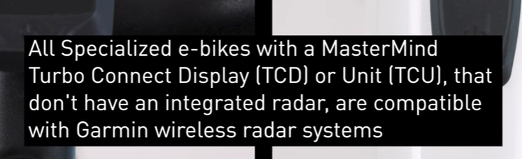

I can confirm that the Mastermind TCD allows the connection of a wireless Radar, such as the one rayray posted. The basic one I believe requires wiring/is not wireless, and I'm not sure if there is additional wiring underneath to provide support to it. The Mastermind will also display the dots like the 5.0.
Yikes, I just looked up the compatibility, and it's even listed on their watches! (now I kind of want one even more).

@BigJ: It will work.
Thanks for the video, Stefan. Now I’m curious how often the radar needs to be charged, being that it’s wireless. Would still prefer the integrated system. One less bottom to push, and one less thing to charge.

Watch the video in post #7.... they may have taken heed of your idea?

It can - I have my RTL515 paired to my Vado 4.0 TCD. Works great.
