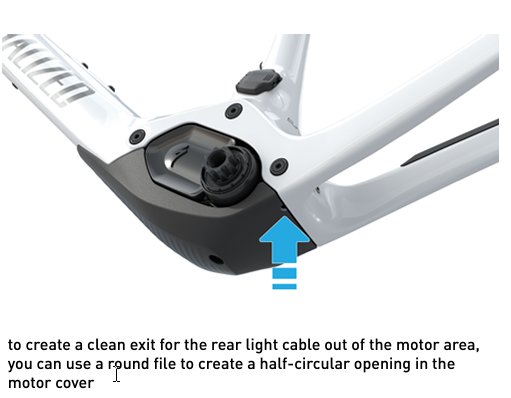

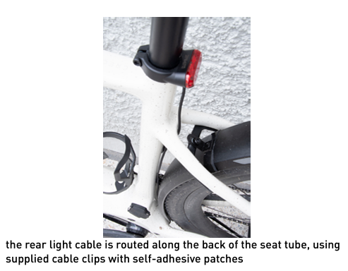

I use one on my Creo SL for a wired tail light and radar. The Varia is 1.5w @12 V. I used the Shimano cable with four wires, two twisted for positive and two twisted for negative. It's a little annoying to have to buy a Garmin accessory cable in addition to the Varia. Yellow and red are twisted together for positive and Blue Black are twisted together for ground. Creo/Vado SL's use spade connectors to a Specialized Y-cable. The Creo 2 Rider Workbook has a wiring diagram and allowable loads for lights.
