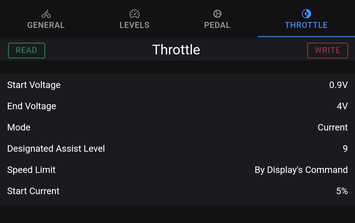

I started programming the Bafang Ultra 510/620 with the Eggrider V2. I want the throttle to give full power in every pas level but I don't know how to accomplish that. Right now the throttle power increases with each pas level so there is full power only at pas level 9. Is there a program setting that will yield full throttle power in all pas levels?
On THROTTLE Page set Designated Assist Level to 9
Then on the PAS page set PAS 9 to your desire.
For full throttle....
Current: 100
Speed: 100
Thanks for that info. The Eggrider app looks different but I currently have the same settings and only get full throttle power in PAS 9.
Different interface but all doing the same thing.
Post a screen shot of your settings

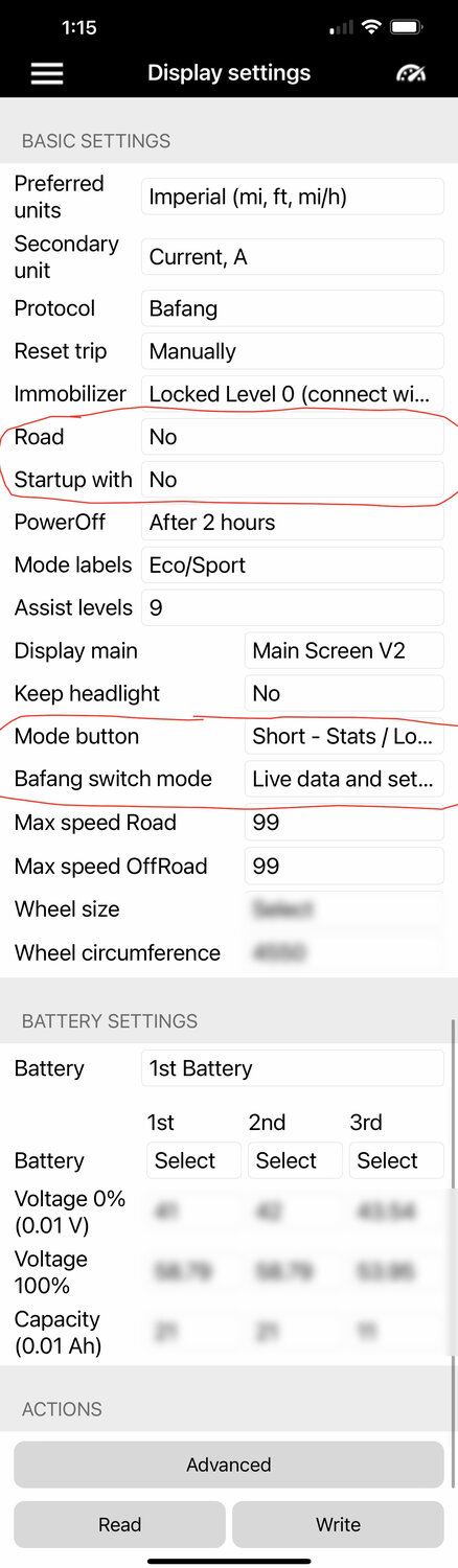

There are a few possibilities/functions with the EggRider for Ultra that are different than other Bafang config tools, especially compared to BBS config tools. I'm wondering if perhaps you have something going on with OffRoad and OnRoad settings that is giving you results you're not expecting.
First, you should make sure that your EggRider is set up to actually change controller settings. This is the "Bafang switch mode" on Display Settings being set to "Live Data And Settings." If it's "Only Live Data" then any setting changes don't get stored.
Second, note that the EggRider supports different settings in OffRoad vs OnRoad for the Basic, Pedal, and Throttle pages. So if you're changing settings for OffRoad but you're riding in OnRoad, you're using different settings. You can switch between OffRoad and OnRoad on the settings pages using the top right button. Even then, if you're working in OffRoad mode you need to be sure that you are actually riding in OffRoad mode. There are 2 Display Settings for this:
  • Road Restrict should be set to No if you want to be able to access OffRoad mode
  • Startup With Road - could be set to No or Yes. Setting to No will keep the last mode you used when you startup EggRider again.
Third, be sure you're hitting "Read Controller" whenever you go to a new page, and "Write Controller" before you leave that page. This includes the first time you start up EggRider and go to a setting page.
Finally, the Mode button may be set to switch OnRoad/OffRoad mode on a short press or a long press with the Mode Button option on the Display Settings page, and the display updates to show what mode you're in. Depending on your settings also, which mode you're in may not be obvious as the "Main Screen V2" doesn't display the words anymore, it highlights the Assist level differently.

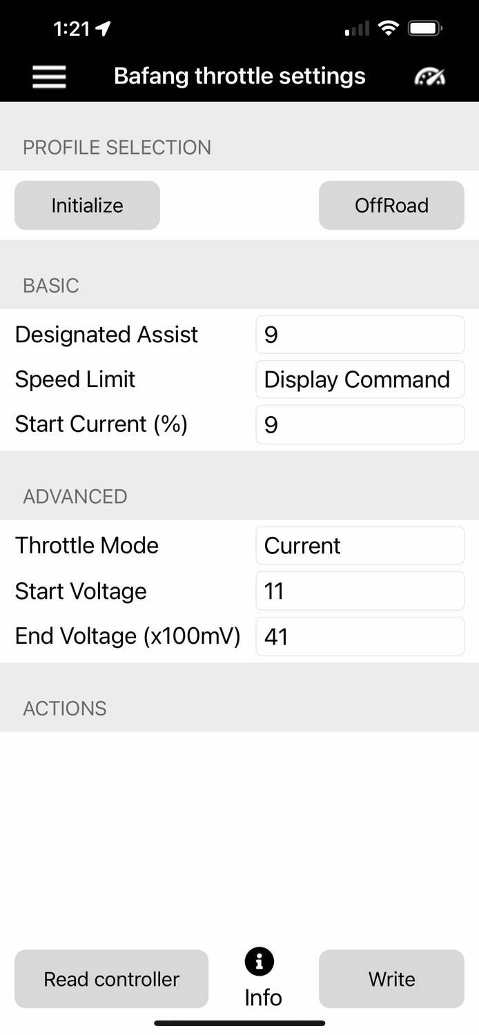

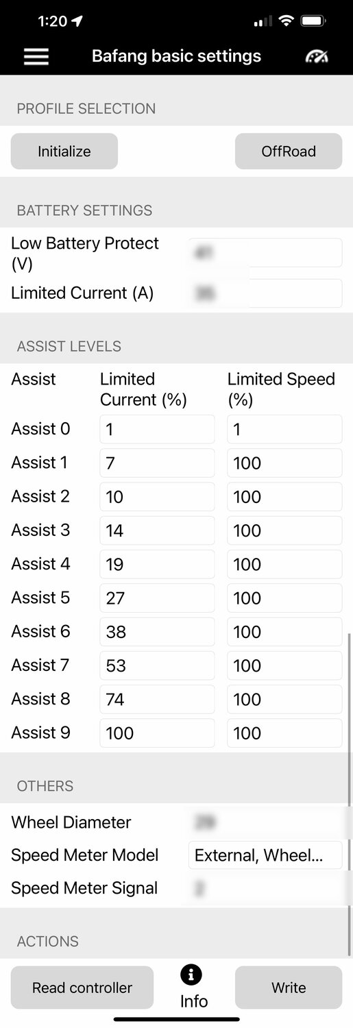

These settings give me full throttle no matter what Pedal assist level I'm currently riding in:

Thanks again Smorg. Your settings worked and now there's full throttle power in all 9 PAS levels. There seems to be something else going on with torque settings though. I can read and write the torque values but there is no "saving" confirmation on the Eggrider after writing. I do get a message on my phone app saying the write was "OK" but the actual pedaling torque doesn't feel like there is any motor power increase when pedaling hard. There is a "saving" confirmation on the display in all of the other tabs.

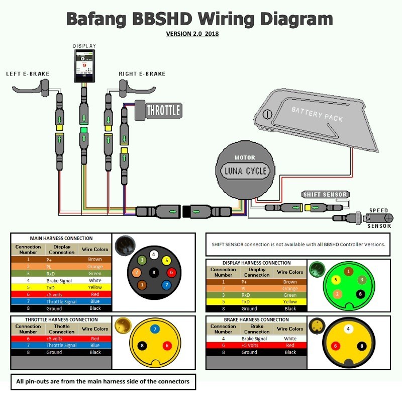

I'd start from the beginning and check all connections as it could be as simple as that.
I'm not positive but I do believe this diagram applies to the Ultra as well.
