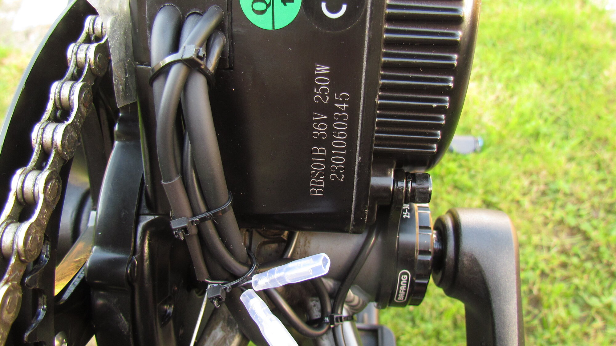

I have two bikes both with Bafang motors, 100% identical setup.
On one it is no effort cycling in setting 1 of 9, in 8th gear, for the other bike to be as "nimble" it has to be on power setting 4.
How do you "look" at the "power" settings of each 1/2/3/4/5/6/7/8/9/ please, many thanks
I have a lead that connects to a PC that came with them
the problem is one bike does not have the "boost for want of a better word" in 1/2/3 as the other bike would like to set them both up the same so ANY BAFANG users advice appreciated thanks.
I want to get both 8 speed bikes the same/equal in all power settings

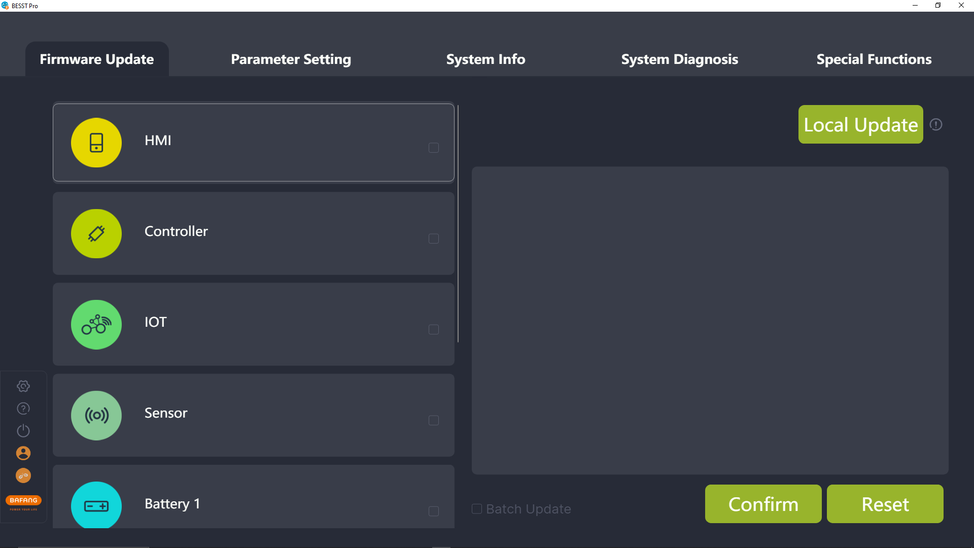

I also have whatever this is ?

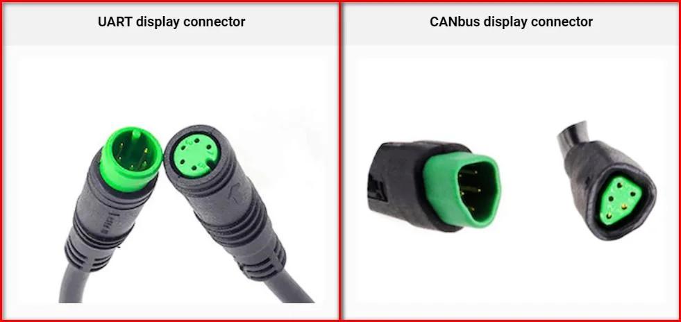

Are your controllers CANBUS communication protocol, or UART?
If CANBUS, the settings are probably locked down, and the BESST software will most likely reqire a dealer account with Bafang to program the controller.
If UART, you can change the settings to match each other.
If they are UART, here is all of the info you will need.

Download the software that Tom linked to and install it on a Windows PC.
Read the article as it's pretty complete. But basically you will use the downloaded software to connect to the display cable of the motor controller and make some adjustments.
But first you'll want to save the current configuration on your PC.
Let us know what questions you may have.

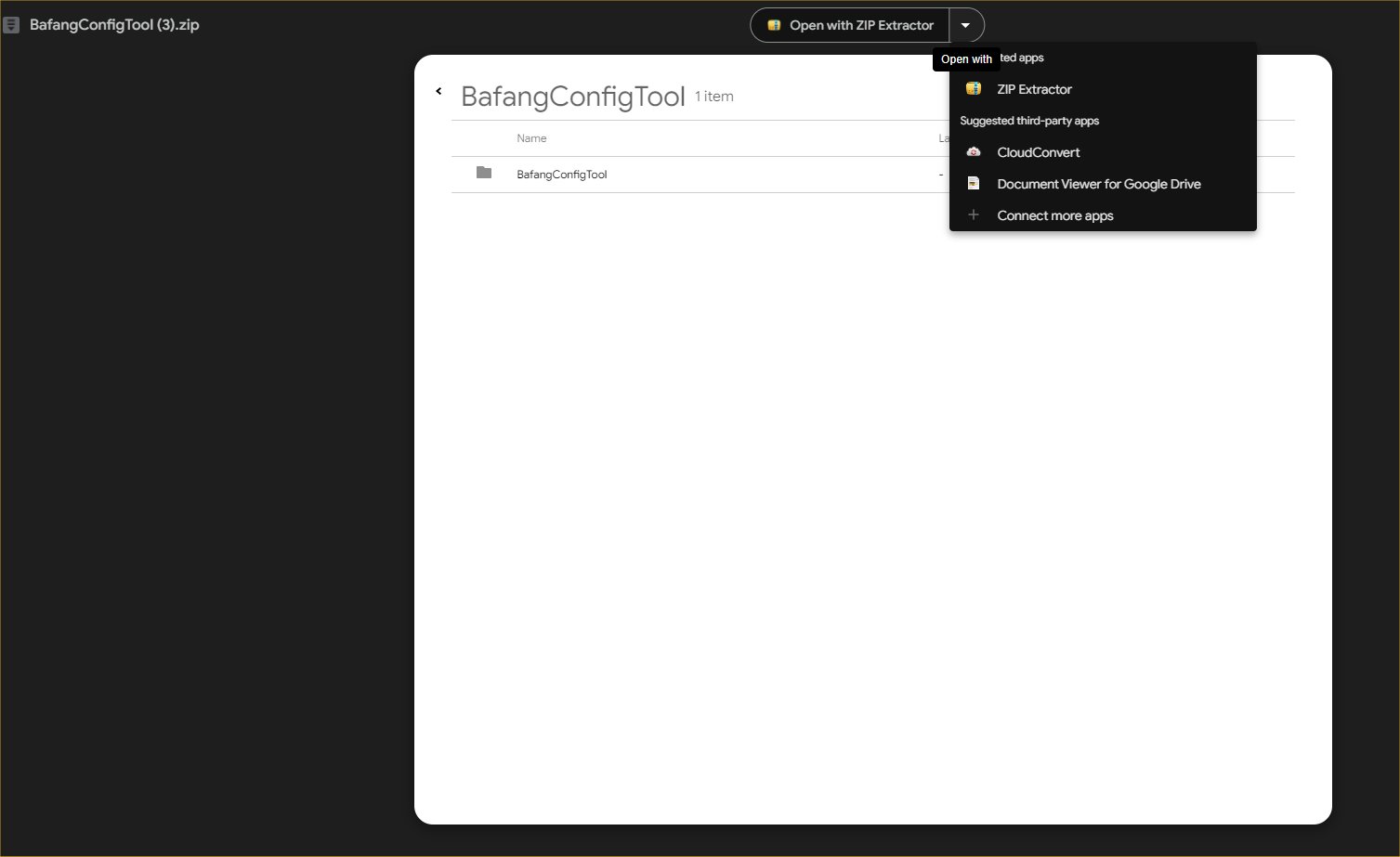

This is where I am stuck now
I am used to downloading a file to the computer and opening it with say, peazip or similar, this is beyond me :(
I get this

Actually, you can use this online tool without downloading the softare. I've used both the online tool and the download software.
As recommended above by @ilMunduato, save your current config settings to a file, but also screenshot them too.
