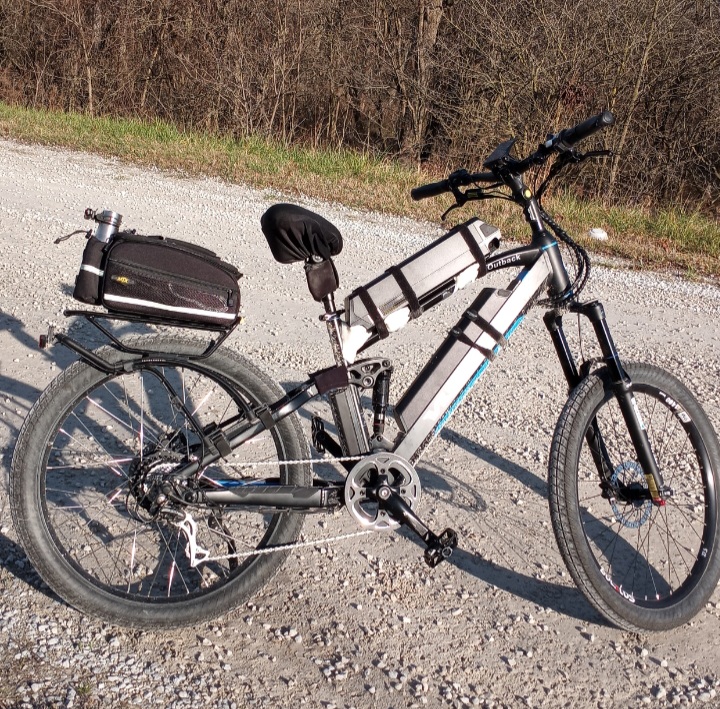

I spent many months fussing about trying to attach a second battery to my e-bike.
First it was on my rear rack, but it caused a speed wobble/shimmy when I rode no-hands and I'm all about riding no- 👐, so I spent a month trying to balance and true my wheels, then the 14# battery broke the rack off my ebike.
So after another couple months, I used polymorph plastic to make battery brackets for a second battery on my top tube,..
I finally had the freedom to ride as long and far as I want at full throttle (32 kph), without having to even look at my display.
I could ride full speed into a 30 kph headwind maxed out at 21 amps then turn around and get a free ride home at full speed using less than 2 amps.

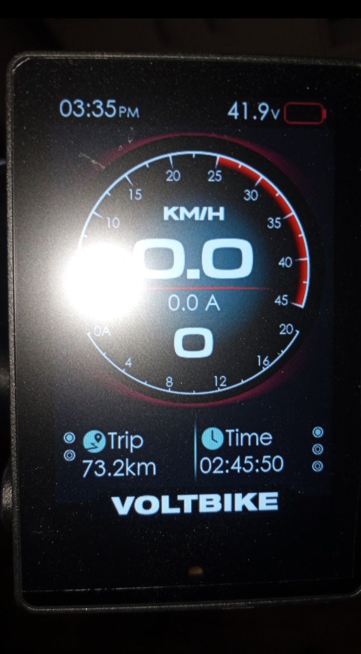

I thought it would be smart to do a range test on my newest battery, (48v 25ah) so on my first ride with the two batteries, I rode my e-bike full snort to check the range.
I was getting a little tired after about 2 hours so I decided to head for home and only use the second battery to just get me the rest of the way home after my first battery was completely dead.
Finally, after about 70 km the battery went into the red and shut down on me.
I went to swap batteries to get me the last 11 km back home and realized that I didn't have the damn key for the battery lock with me !!
I removed it from my Keychain because I only use it at home, and I would always charge my battery on the e-bike anyway, so I didn't need to use the key.
Luckily I was running full snort with a Huge Voltage sag, so I had a volt or so to use if I kept the power below 150 Watts and I pedaled along to help.
Then 100 Watts, then 50, then the controller shut me down for the last time with about 6 km of unassistance, pedaling a ~90# e-bike left to go.

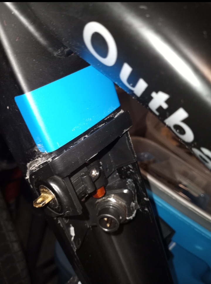

Sooo,..
I decided that I would burn the rubber off the head of my key, grind down it down to a nub, and glue it into my keylock,..
The head of the key is still big enough to grab and rotate the spring lock, and I can remove it if I ever need to and use my other key, but it won't fall out of the lock by accident, and I won't forget or lose my key.
(And I didn't glue the lock shut. 😂)
Sooo,..

I did exactly the same, but was using xt90, so just taped the second battery in place

Then I bought a new 48v 25ah battery with Samsung 50E cells for $840 CAD and managed to blow the damn thing up within 10 minutes of it arriving at my door.
I wanted to check the shipping Voltage and managed to short the battery output with a big crack of lightning 🌩. 😂
With the help of the battery vendor, I managed to get the battery going, but not until after I opened it up to investigate.
Then of course I overtightened the tiny screws and all 8 of them broke through the plastic battery cap, but not of course till after my first ride.
,.. so just taped the second battery in place
So I just taped the battery caps to the case, with lots of RTV silicone (color matched of course) and it's been working fine for almost two seasons now with over 5000 km on it pulling my lazy ass around. 😂
I used the fancy Permatex RTV Silicone and Gorilla 🦍 tape for the job.
I didn't want to put dollar store tape on an $800 🔋. 😂
I shudda read the label before I started playing with it. 😂
