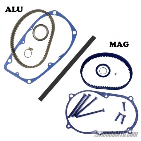

I have a Brose belt for Alu series (S, T, TF) and the belt tensioner pulley. (does not fit the MAG). I bought them thinking that was what was wrong but when I cracked open the case they were fine - the clutch had failed. So I have a new, opened but unused belt + tensioner. Cost me $250 to buy from Italy, shipped. Will sell for $100 plus shipping. I have since bought a Bosch powered bike and have no need for these as spares. four oh ate six svn 9 o for sven 9.

As far as I know, Brose does not build belts, Gates design and build belts for Brose. Brose does not sell belts E86001, have to send in for repair. Here is the Replacement belts for Brose, not sure if it ship to USA.

I bought 3 brose belts from this supplier, "e86001" mark on the belts. These 3 belts for 3 different customers. It has been 4 weeks approx since replaced with new belts. So far so good.
