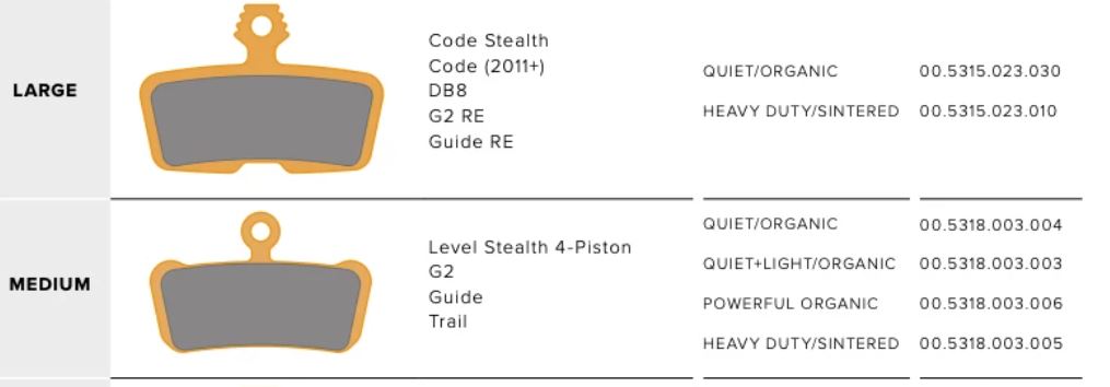

I'm have a heck of a time trying to figure out what the correct size pads go on my bike which is a Specialize Levo Comp Carbon Turbo with 4 Piston Hydraulic brakes front and rear.
Some research says they are medium level stealth G2 but they look like the Code Stealth DII G2 RE.
Rears are getting low, need to replace. Assume I will go with metallic or semi metallic for best bite even though they can be very noisy. I'd take brand and type recommendations as well.

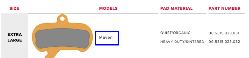

Are your brakes the SRAM Maven Bronze (per website specification for Levo 4)?
It is what SRAM says.
The brakes on the Turbo Levo 4 Comp Carbon should be the Mavens.

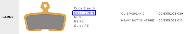

However, it is a difference between Levo 3 and 4. Levo 3 uses SRAM Code RS brakes.
Brake pads for Code brakes.
What brakes are installed on your Levo?
They look like the code 2011+ and say Metallic on the back. My Levo is a Rev 3. I did order some from Discobrakes, fingers crossed. The ones that came with it are quite loud if not perfectly clean and dry but they work very well as does the bike in general, love it.
Oh and I don't know the model of the SRAM, doesn't say anywhere on the caliper that I can see, again it's a 3.
