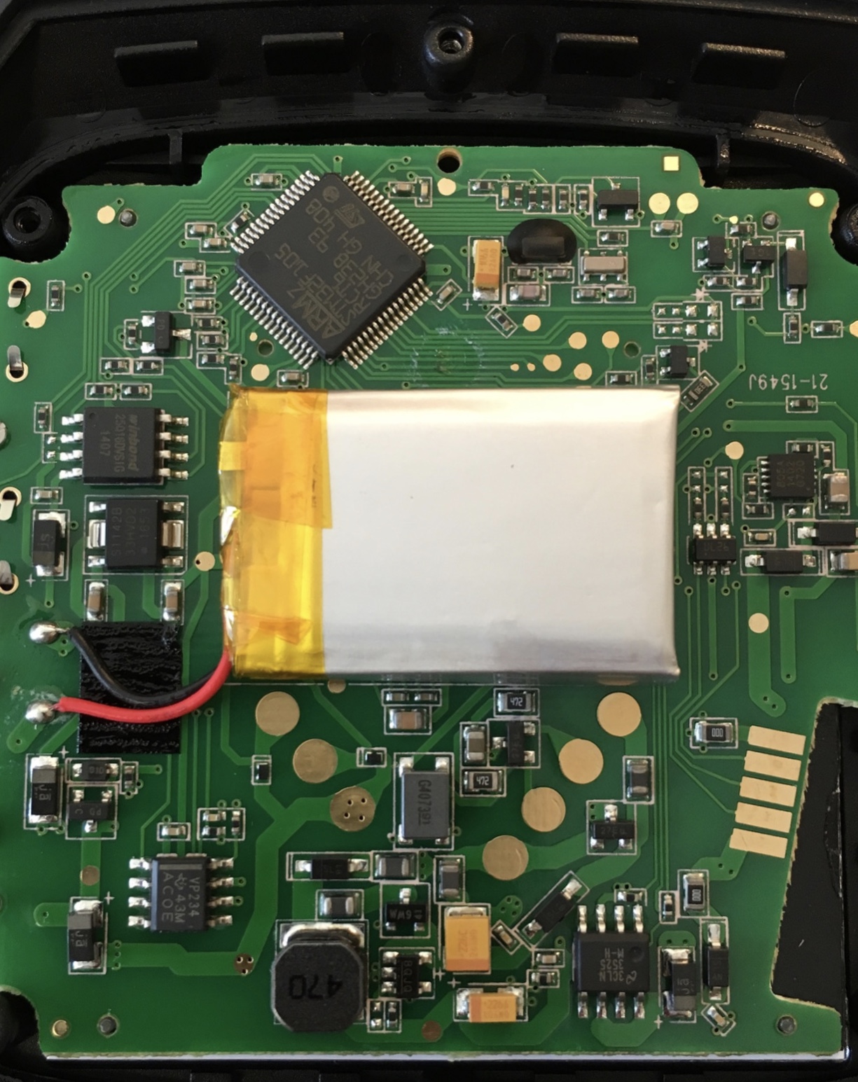

The battery inside the Intuvia is a small 240mAh LiPo rechargeable battery. It’s At the moment it is not a replaceable Bosch part. But I understand they are working on this.
In theory someone could solder in a new battery but you could open yourself up to liability if something was to go wrong. Bosch would not be liable if something went wrong. Which I understand historically may not have happened in thier history. Perhaps due to their extensive testing and focus on safety.
I hope to follow up on this internal battery as it is one of the few degradable parts on the Bosch system.
Below is a photo of the battery in the Intuvia

Mine died over its 3rd winter, last year. Bike had a little over 10,000km at the time. My theory is that the main battery went into deep sleep over the winter, and the Intuvia battery ran empty. The main symptom was that I could only turn the bike on via the button on the main battery. Once on, it worked fine. Remove the Intuvia from the bike and it was dead. Occasionally, the bike would stop and throw an error about the main battery.
I found the wordpress site above. I first found a 240mAh battery intended for an RC helicopter. It looked the same, but the bike kept throwing errors.
The proper battery is a 502030 rated 240mAh. I ordered 4 of them for $10 on ebay.
The hardest part of the job was removing the back of the case - the middle screw holes were filled with plastic. But you need to solder two leads.

Do you think this would be OK since it is 250MAH and 3.7 volt ?
It seems that @Slob above might be a better person to ask. I don’t have personal experience replacing this and I can’t make a specific recommendation as much as I would like to. One thing I do know is that the Bosch sensors and tolerances are very specific. I plan to ask some of the engineers at Bosch more about this topic when I get a chance though and I’ll be sure to update here.
I'm going to say "yes". That one matches the specs. I've attached a pic of the one I installed. Looks the same but the label is slightly different.
My first attempt wasn't a 502030. It had the right voltage and amperage. I believe there's a small controller in the battery, and this is what was different. The wrong battery worked, but would randomly throw errors after about 10-15km. I'd have to stop and powercycle the bike to get going again.
The 502030 worked just like new.
