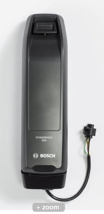

My LBS will soon be installing the Bosch Extended Range 500 WHr battery on my Trek Allant+ 7s. This shop has never installed this battery, nor do they have much ebike experience. I'm I concerned their training experience will be reflected in the installation labor cost. What should I expect for the billed time and labor charges for this installation? Does Trek suggest a flat-rate charge for this type of work?
Edit: June 26, 2022 > Update as promised < The work has been completed. It took 10 days for the extended battery kit to arrive at the LBS and another 14 days to complete the work. There was a significant delay when the shop had to order the RIB battery alignment plate as recommended in a Trek TSB. (The plate attempts to correct the "flying battery" issue). I'd originally asked the LBS to order the alignment plate when the battery was ordered. However, they failed to do so until the bike was in the shop.
My cost was the list price of the extended battery kit plus $30 USD for the firmware update. The shop waved the installation labor (estimated earlier as $75-$150) due to the delays. The firmware update is a required step in the installation process so it should have been included in the total labor cost. I didn’t argue the point.
As a side note I have another Giant ebike, also purchased in May 2022, presently in a different shop. Giant replaced the entire original bike after 2 weeks. That bike simply failed to charge. Due shortages Giant stated it was easier to replace the bike than to wait several months for the parts. The replacement bike's electronics failed after another week. At Giant's direction the cable harnesses were inspected, the battery was replaced - twice, firmware was updated, and now we're waiting for a replacement controller. That replacement bike has been in the shop for three weeks now. So, with my experience with these three ebikes I'd say the LBSs and manufacturers are unprepared to properly support them.
my mechanic had to build it from scratch because it is usually only sold with the battery. but f it is bought as a unit its fully assembled. the y wire has to be run and connected to both and all the hardware installed. should take a hour or so. there are videos online showing how to do it.
Your concern is justified. Last time I talked to a bike shop about this, they kept saying they'd seen a training video on it, but had never done one, that it should take only! 4 hours, but they wouldn't guarantee that. And they would bill at about $120/hour, and you'd just have to pay to cover the hours they spent. Luckily for me, they eventually, after lots of pressing discovered that the dual battery kit they had wouldn't work on my bike. I'm sure any instructions they have will say to remove the DU, but that always be the case, and that can save a lot of time. If the Motor is a Gen 4, then you should check they shop actually has a T40P Torx bit, or else you'll be replcing the motor mounting bolts in the future.

OP here. Thanks everyone for your comments. @rich c, I'd read the post you'd referenced earlier and found it helpful. Despite the apparent simplicity of the install there are certainly ways of doing it every so slightly wrong. I met with my LBS twice. They are unsure/unclear of the labor required to install the battery since they only had watched a video some time ago. They had to provide four parts quotes over that many days until they finally got the parts list sorted out. (There's only one part number for the complete "kit".) They're learning... I too expect one hour's labor to be sufficient. I was hoping Trek had a flat-rate book price for the installation but apparently not so.
While that work is opened up I asked they install the battery alignment plate (ref Trek service bulletin dated March 2021) which corrects the risk of the RIB battery being spontaneously ejected. (My buddy's Trek RIB battery self-ejected last week and went skidding down the road.) This plate is standard in the newer factory builds. (I'd purchased this bike 30 days and 600 miles ago.) The LBS was unaware of the fix and would not commit to installing it. The LBS will also have to find a home for a screw I found lying in the battery compartment. All of the visible screw locations were occupied so I suspect this screw had been part of the upper RIB battery docking bracket.
I'll update this post after the work is competed. Hopefully within a couple of weeks.
my mechanic had to order all the parts separately and eve then some where missed or not listed. then it was like a jigsaw puzzle to assemble it from scratch. since trek sells it as one part. one thing was not clear was the way the y wire was installed there was no info on that. I don't think trek does many of these it was the first for him.
