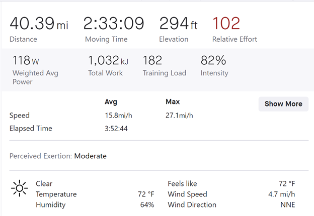

My experience of Bosch Gen 2 mated to a Rohloff is similar and the attached data is my ride on a R-M delite. I was able to hit 33 mph top speed. I am pretty sure I can do better with a Gen 4.
I will release more range + speed data on Gen 4 system once I put few hundred miles on my prototypes.
Were you getting assistance from the motor beyond 26.5 mph?
Of course. All the way up to 28 mph.
I believe the gearing ratio and low resistance of Rohloff helped.
I have never had a problem of hitting 28mph on Bosch Gen 2 or Bosch Gen 4 motors. I have attached the Strava data above. Bosch motors are not over-powering nor are they under-powered and it would be difficult to maintain 23 mph average speed over 22+ miles if the motor did not assist properly.

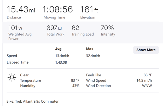

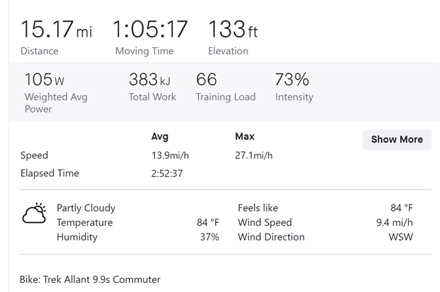

I went for a short 15 mile ride tonight on my Allant. I was really trying to pay attention to the behavior of the assist as I approached 28. It definitely does not cut out at 26 but I was working to get to 28 - particularly because the wind speed shown below was headwind (Tour mode). If the assist was decreasing from 26 to 28 I could not detect it. I rode perhaps a quarter of a mile right around 27 to 28 in Tour and I was pedaling hard with a fast cadence. But I still had Sport and Turbo mode which I did not use. I tend to think therefore that a cruising speed close to 28 mph with a comfortable cadence would be possible relying on the upper assist levels. Unfortunately, absent my commute at 6am, I don't really have a long stretch where I can cruise for several miles at a high speed. I'm not commuting now due to Covid so all my rides are residential and urban and during times of more traffic - hence less ability to test out high speed cruising over a long distance.
I also went farther back in my Strava history and found a 35 mph max speed. It was back in April and I honestly don't recall the ride but I'm sure tailwind and perhaps Sport mode were involved. I really don't have hills where I live - most of my rides show minimal elevation gain - so it definitely wasn't a downhill run.
Today's ride and April 28
