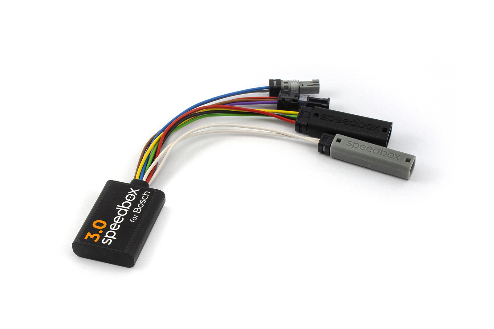

BMC with the Shimano E8000 in delimit mode(using the speedbox) can reach 33-34mph. The Shimano battery lasts a very long time.

Speedbox would void your warranty.
I would say if you do compare you need to compare them assuming they all have warranties.
I believe even if you remove the speedbox, shimano can tell you had it installled at one point. I am 100000% positive these companies record usage data, and if the motor data indicates you were doing 30MPH and It was providing X% assist, well there goes your warranty. I would delimit ONLY if you buy it 2nd hand.
There is a delimiter for bosch. I think i saw a vid of someone doing 42mph on a bosch performance line speed motor that was delimited.

I would like to delimit the E8000.

From what i've researched, Shimano doesn't have a way to check if it was delimited. Just remove spredbox before service and it won't know
Bosch does have a system to know that and after 3attempts it voids the warranty !! That i know from an online interview with Bosch reps(i think Court did that at an earlier ebike expo ?).
