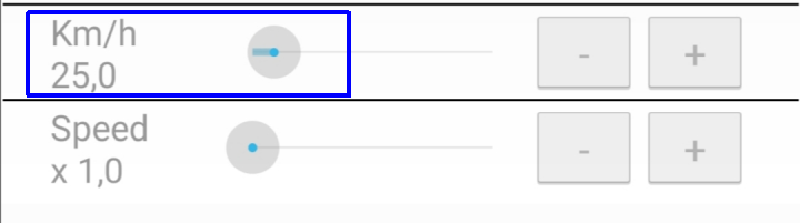

  • The Wheel Circumference can be set in BLEvo (to give accurate readouts in the app) but it doesn't seem to affect the value set in the TCU
  • The Speed slider luckily doesn't affect the Vado. Which is good because it might upset the 45 km/h or 28 mph speed limiter.

One other thing the speed slider won't effect the bike. It will report accurate speed in BLEvo when set if your bike has Planet 3 installed. It will report accurately speed and range while your TCD-w will lie to you.

I used to be shy about BLEvo in the past. One of things that were making me afraid was this:
I own a legal 45 km/h Vado. I tried to set the slider to 45 km/h and was unable to do it. I was afraid I might spoil my Vado by using BLEvo and that would have invalidated my warranty.
My fears have been baseless. I simply don't touch these sliders and everything is OK.

EU S-Pedelec Vado is not the U.S. Class 3 Vado. That was the point that used to make me be wary of BLEvo. I should have not be afraid though :)
